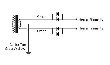

That's a nice Schottky diode. I gotta write that number down somewhere.
so i tried this arrangement with these diodes and the voltage drops down to 5.5v so then i though i would try only one pair of diodes on one leg and it started to smoke. i had a good 6v though. can anyone explain why it started smoking?
