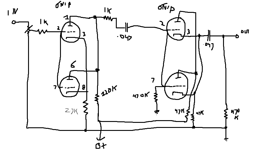

the gain is way too high, i can only turn the volume up about 30% and then it starts to distort. it doesnt use feed back it is a dual paralleled single ended triode with a cathode follower.
here is the schematic of one channel, the pot is 100k

This surely is a waste of tubes ... split it up and make it two separate channels or change the topology. If you intend to go the second route, have a look at Broskie's "Aikido" stage - 4 tubes put to a much better effect.
This has nothing to do with the filament voltage, it has everything to do with wrong solution to a problem. If you can desribe what you're actually trying to accomplish (besides building a tube preamplifier, of course 🙂 ), I'm sure we'll be able to come up with a more suitable solution.

there are only two dual triodes in this schematic. do you mean that they could be used more effectively?
i didnt design this circuit. this is a kit and im green to electronics. im just trying to reduce the gain. so i assume that making the plate less positive or making the grid more negative would result in reduced gain.

No, nothing wrong with posting a schematic that you drew- quite the opposite, it's helpful. But if that's actually the DECware circuit, it's screamingly incompetent. You may want to retrace and see if that's really what the circuit is.

this is the schematic, i went over it again
what do you think would be better?

Frequently these sorts of diffiulties are assembly problems. Two paralleld triodes where one would do is kinda weird I must say. Check your component values with the tubes pulled. Make sure you haven't put a 470K where a 47K should be or something similar. Did they give you a voltage chart? Check voltages and make sure they are where they are supposed to be. I'll bet the bias on tube one is out of wack. And FIX THAT HIGH FILAMENT VOLTAGE IMMEDIATELY! It's easy with diodes.
A beginner problem is not having a boat load of extra components on hand to try substitution of values. With the thing as drawn I would note one thing. When you parallel tubes, you halve the cathode and plate resistors. Generally. The values in the scheme look like a single triode input stage. The 1K resistor between the plates of tube one and the coupling cap to tube two is superfluous. Reversed it would make some sense, and it should be right at the pin of the following stage. Also, if the resistor between pin 7 and ground on tube two is 470K you would get massive over gain. Check it out.

i have checked the values several times and they are correct BUT i will check again. im not sure what kinda of diodes i should use to reduce the filament voltage.
instead of the 470k what should i use then?
