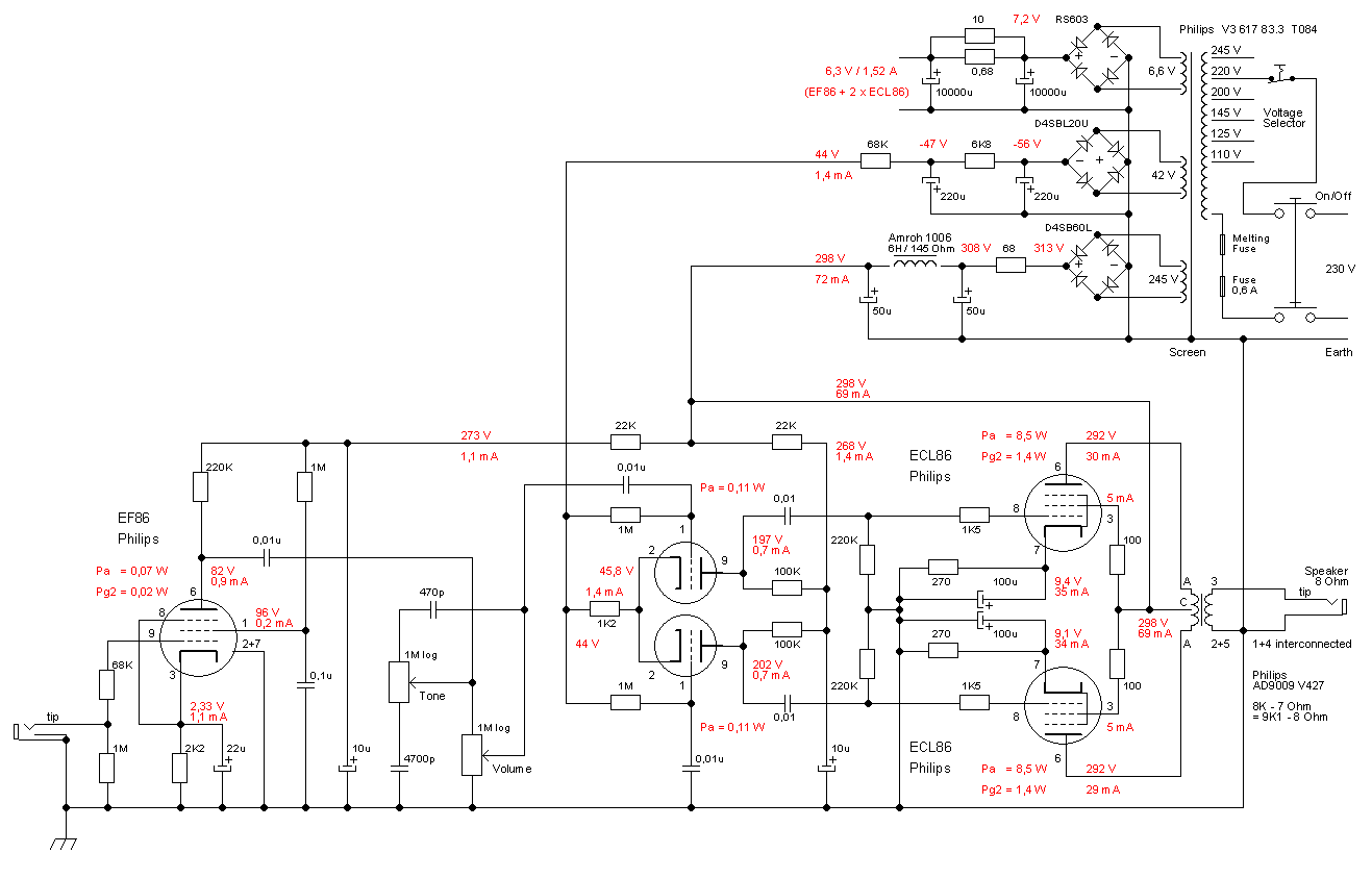

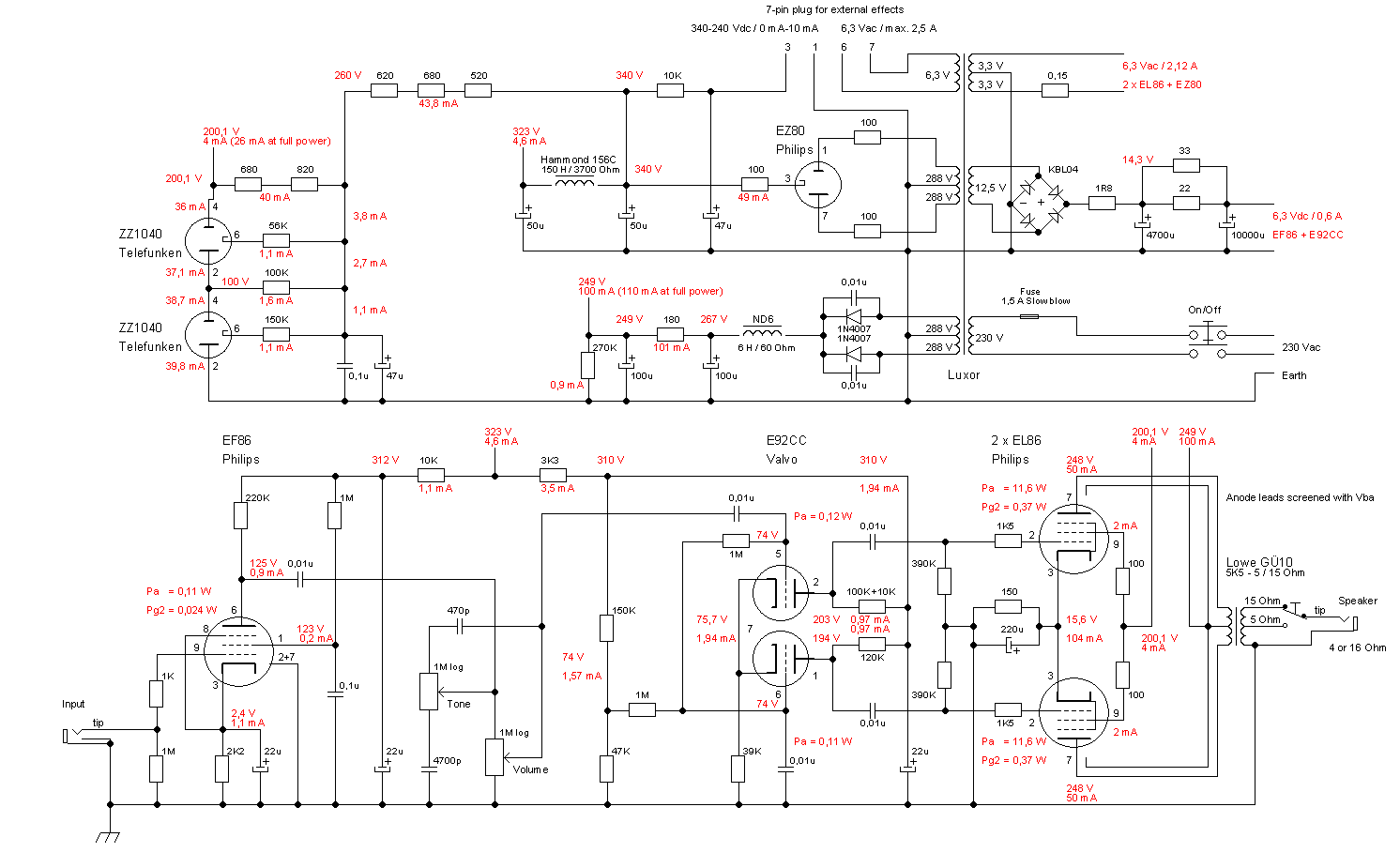

I've built two guitar amps more or less based on the clean channel of the Vox AC15 because I like their clear sound a lot.
Gain in both of them is indeed high but just like gijser I don't experience microphonics/hiss/noise problems. I did pay much attention to earthing and keeping connections to the first stage as short as possible.
My amps are not combo's though, which probably reduces the chance on microphonics.
Guitar amp EF86 + 2 x ECL86 pp
Guitar amp EF86 + E92CC + 2 x EL86 pp + EZ80 + 2 x ZZ1040

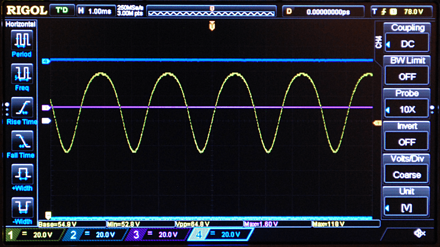

Here is the secret of "pentode clean tone".
It's not really a secret, of course, it's all about the high amounts of mostly second harmonic distortion you can get from a pentode.
The attached image is a scope capture of the output signal from a pentode pre-amp stage in one of the DIY amps I designed and built. I've posted it on diyAudio before.
Notice there's no "clipping" of the waveform at all. That means no harsh buzzy noises.
But there's quite a lot of asymmetry between positive and negative half-cycles. That means lots of even harmonic content, mostly 2nd and 4th harmonic.
And that's the biggest part of the "secret" of those beautiful "pentode clean tones". 😀
The other part of the "secret" is EQ. Put some treble boost in the stage(s) before the pentode. The treble boost will accentuate the harmonics from the pentode, and make them easier to hear. The sound will be brighter and more "chimey".
Don't put the pentode at the input of the amplifer, and you can have the beautiful clean tones without any of the pain.
-Gnobuddy

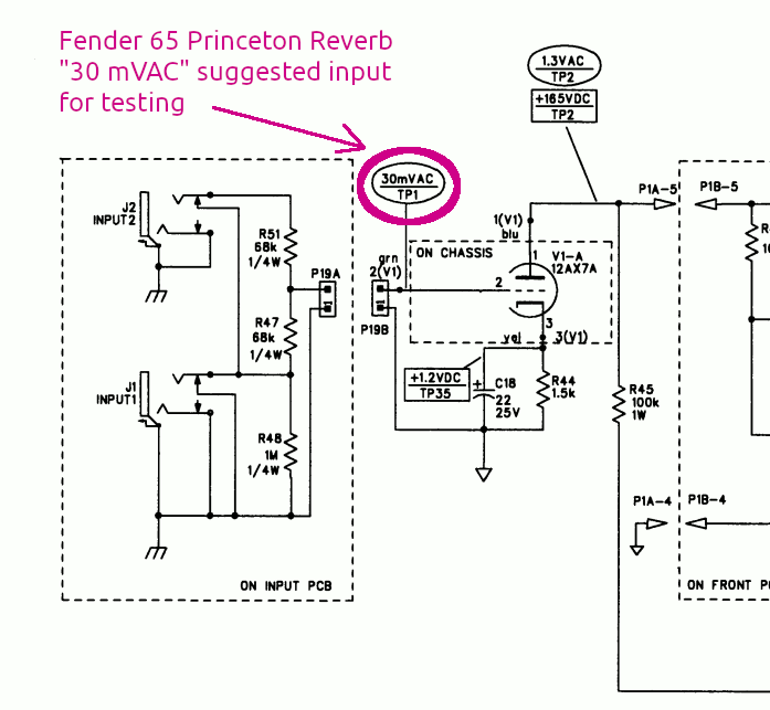

Even though I don't have access to an AC15 to mesure, we do have enough information to make a solid estimate. Let's do that.
Let's start with the typical output voltage from guitar pickups. Rod Elliott has a characteristically thorough table of guitar pickup voltages he measured on his website, here: https://sound-au.com/articles/guitar-voltage.htm
The key takeaway is that almost every voltage Elliott measured is less than 50 mV RMS. Many are under 20 mV RMS. Measurements on thinner strings are even smaller, around 12 mV RMS.
So now we know for sure that a hypothetical guitar amplifier that just barely reaches full output power with an input of 50 mV RMS will produce only "clean tone", i.e. no overdrive at all. In fact, it probably will never reach full output power at all.
A successful amplifier designed for clean tones has to have more sensitivity than that, to ensure you can get the full output power from it. For instance, Fender Corp specified a "30 mVAC" input signal for testing the '65 Princeton Reverb (see attached image). This amplifier was designed to produce only clean tones - overdriven guitar wasn't on Leonidas' mind at that time and place.
The Fender schematic doesn't specify if the "30 mV" was actually RMS, peak, or peak-to-peak. If we assume that an oscilloscope was intended to be used for the measurement, "30 mV" most likely meant "30 mV peak to peak", as peak-to-peak is easiest to read off a 'scope screen.
30 mV peak-to-peak is a little less than 11 mV RMS, for reference. This is in good agreement with Rod Elliott's measurement of 12 mV RMS from the open 1st string E of two different guitars he tested.
Okay. So Fender thinks an input sensitivity of 30 mV pp is about right for full-power, unclipped output from an amplifier designed to produce only clean tone (no overdrive).
In order to overdrive, a guitar amplifier has to have much more gain than that. How much more? That depends on the degree of overdrive wanted. Gain needs to be at least ten times more (another 20 dB) to get any significant overdrive. That means an amplifier that starts to clip with an input of 3 mVpp (ten times smaller input signal than 30 mV pp).
