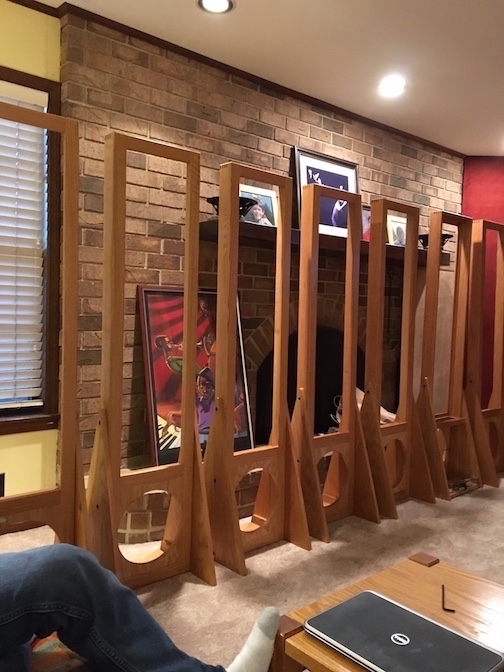

Are there any good sources for designing "wall of sound" or planar(?) arrays?
I don't know of any design guides for multiple arrays but my website is an extensive guide for building hybrid ESL's.
And I'm not building a "wall of sound", BTW. The four pairs of speaker frames shown in the photo will be wire-stator ESL's for my audio buddies at Carver-fest who've begged me for years to do this. It's a huge project which Ive been working on for months, and way more work than I would ever commit to again.
