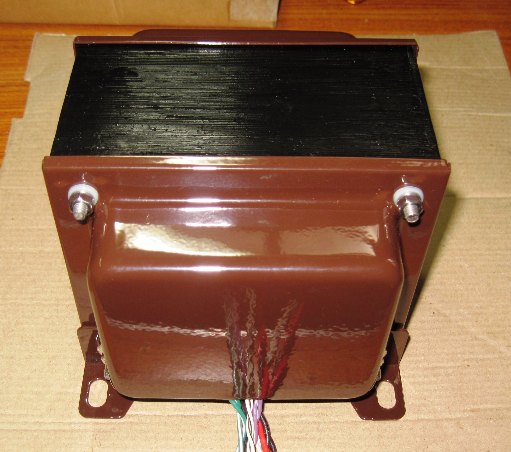

i am building myself a push pull amp...
OPT is 800 ohm anode to anode, to 2, 2, and 8 ohm speakers

Great! /I think 400 ohm for every tube is small load, if You use one tube for a channel/. Or connect 8 ohm speaker to 4 ohm output.

Sorry, I have a mistake ........"if You use one tube for a shoulder"...../not channel... in both places/. The tube has Ri about 130-150 and more depends of current, this data is for current about 400-500 ma...if You use in PP small current, Ri will be bigger and 400 ohm per tube /shoulder in PP/, IMO, will be small. /I used OT 1.2 kohm per tube/.Distortions will increase. Tube sounds itself some aggressive and sense of sounding will be, IMO, some discomfort.Great! /I think 400 ohm for every tube is small load, if You use one tube for a channel/. Or connect 8 ohm speaker to 4 ohm output.

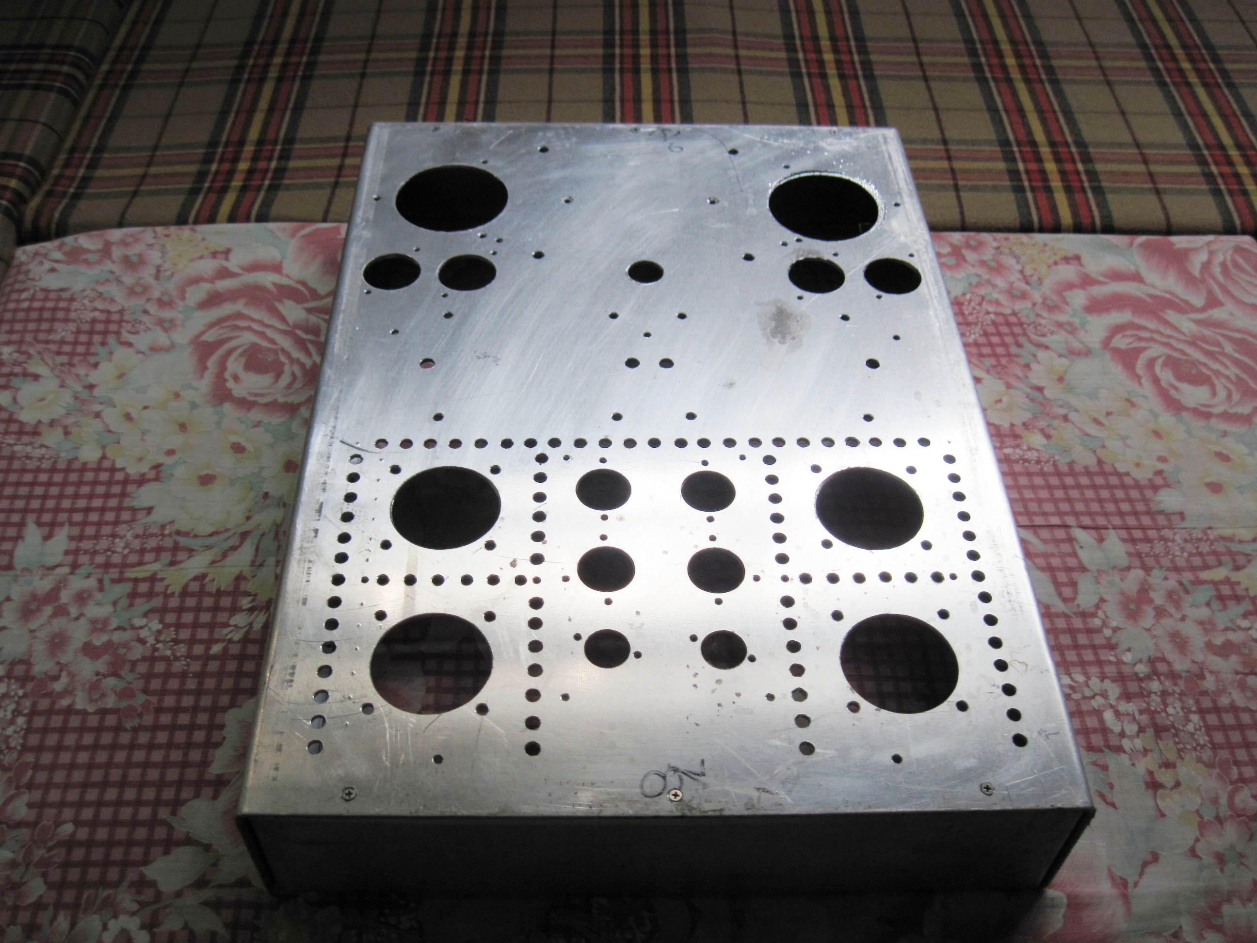

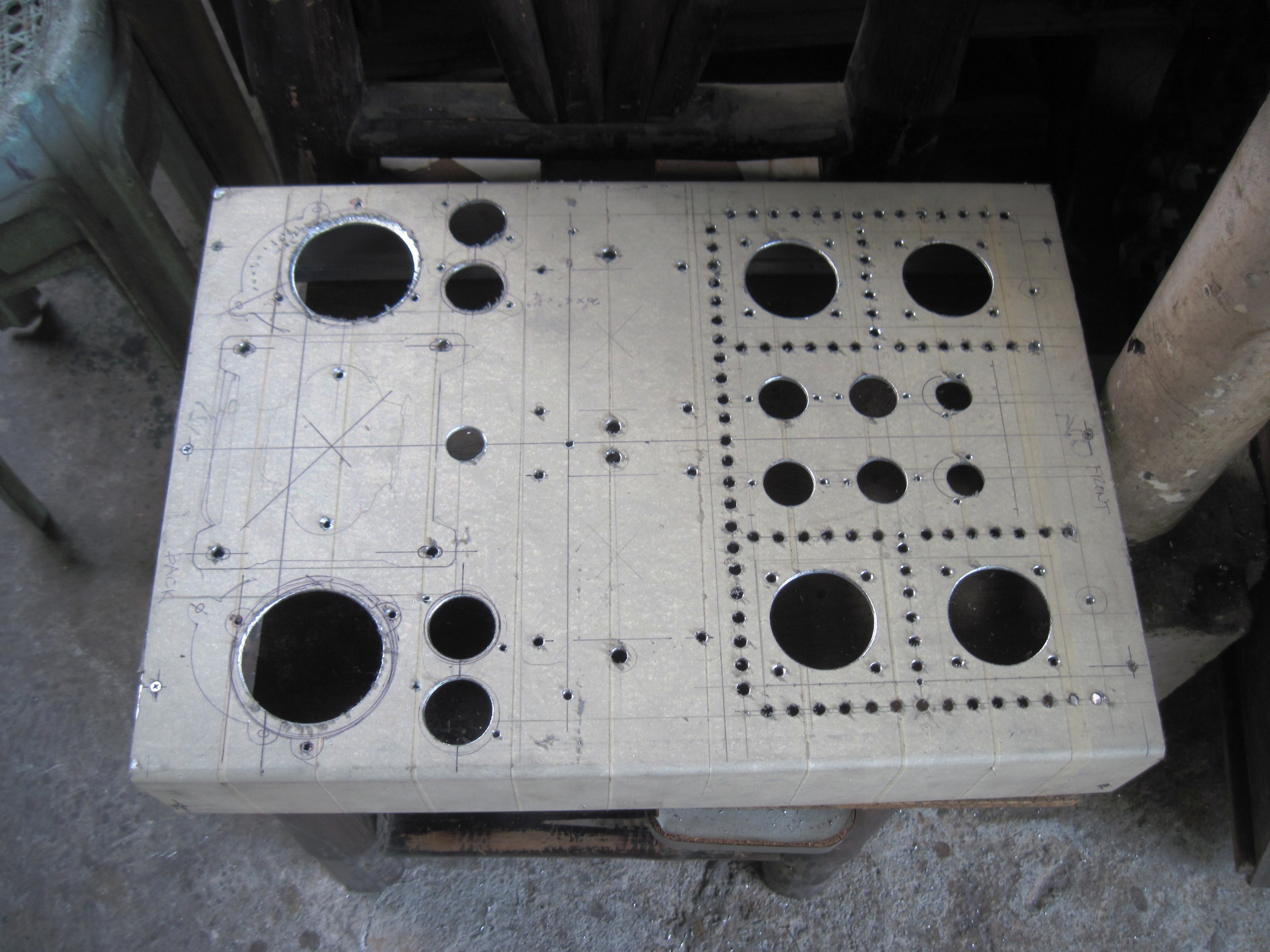

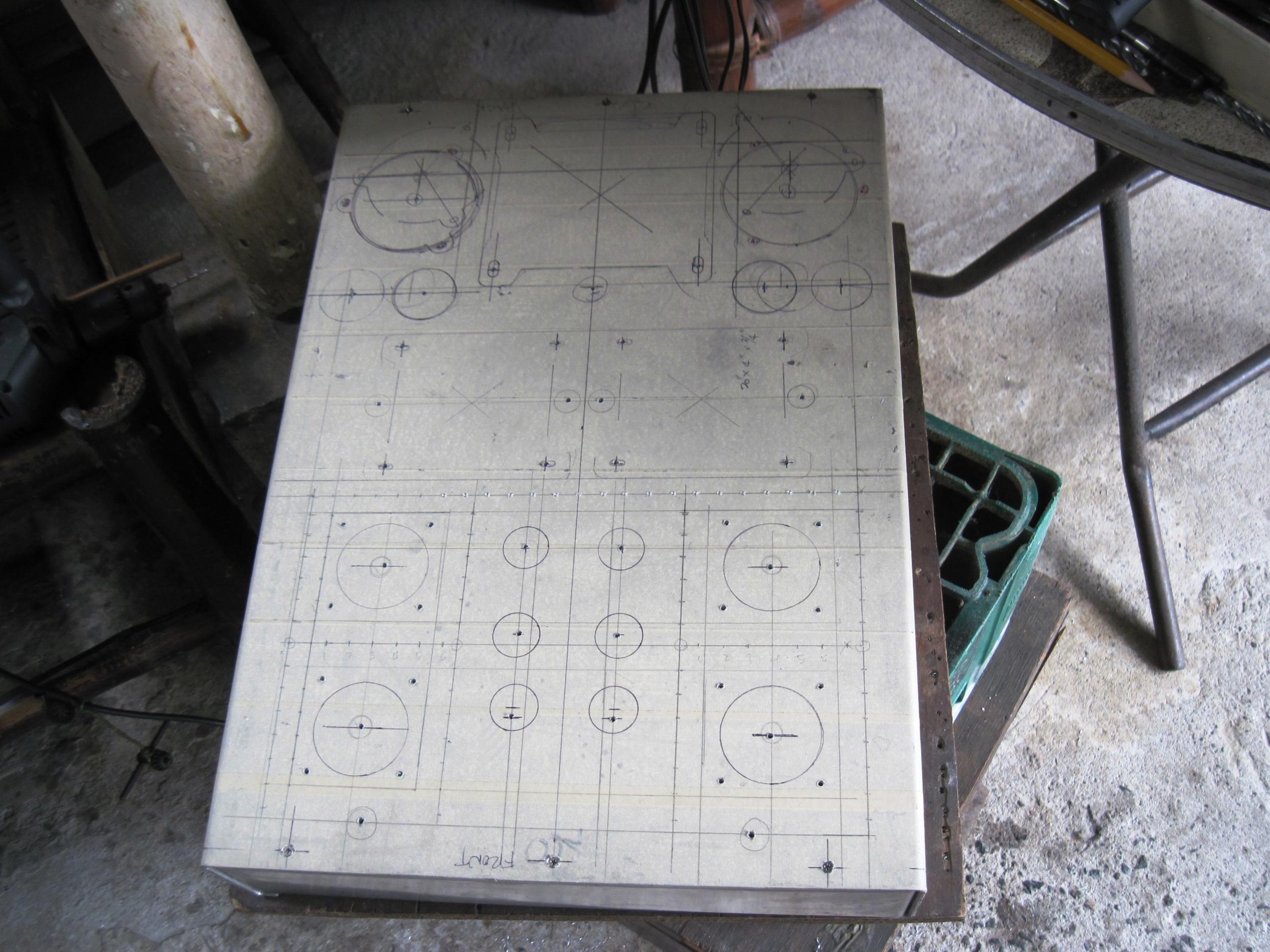

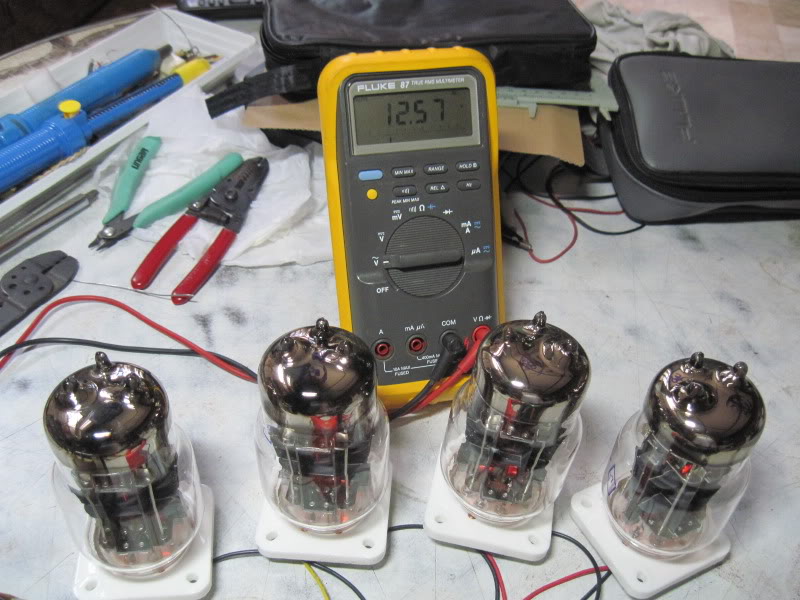

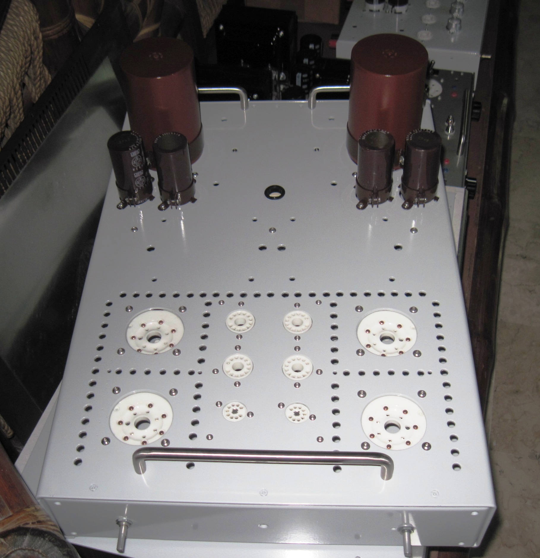

chassis preparation....
aluminum, 3 mm thick and measures 20in deep x 14 in.s wide x 3 in height..
where do you get your chassis done ? yourself or a metalworking shop ?
myself....but cutting, bending and forming done by Unity Metals along T.Alonzo St... i keep lots of various sizes of hole saws and drill bits... then off to a powder coating shop...

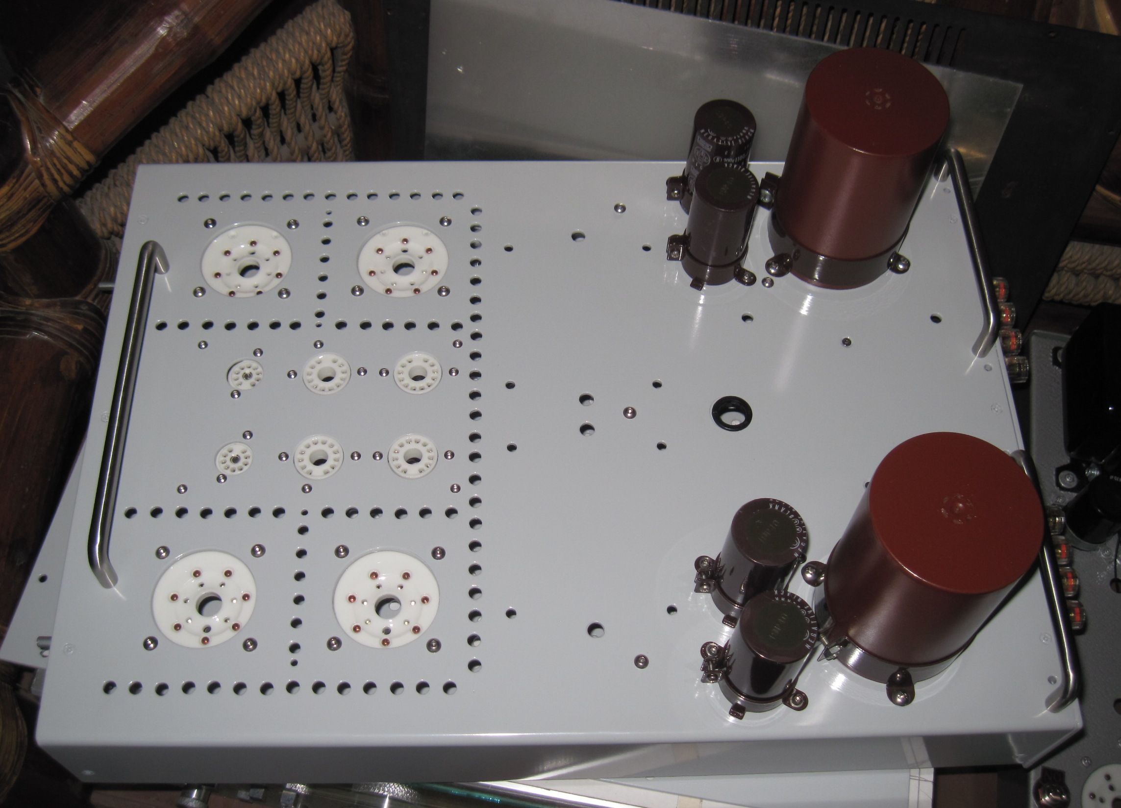

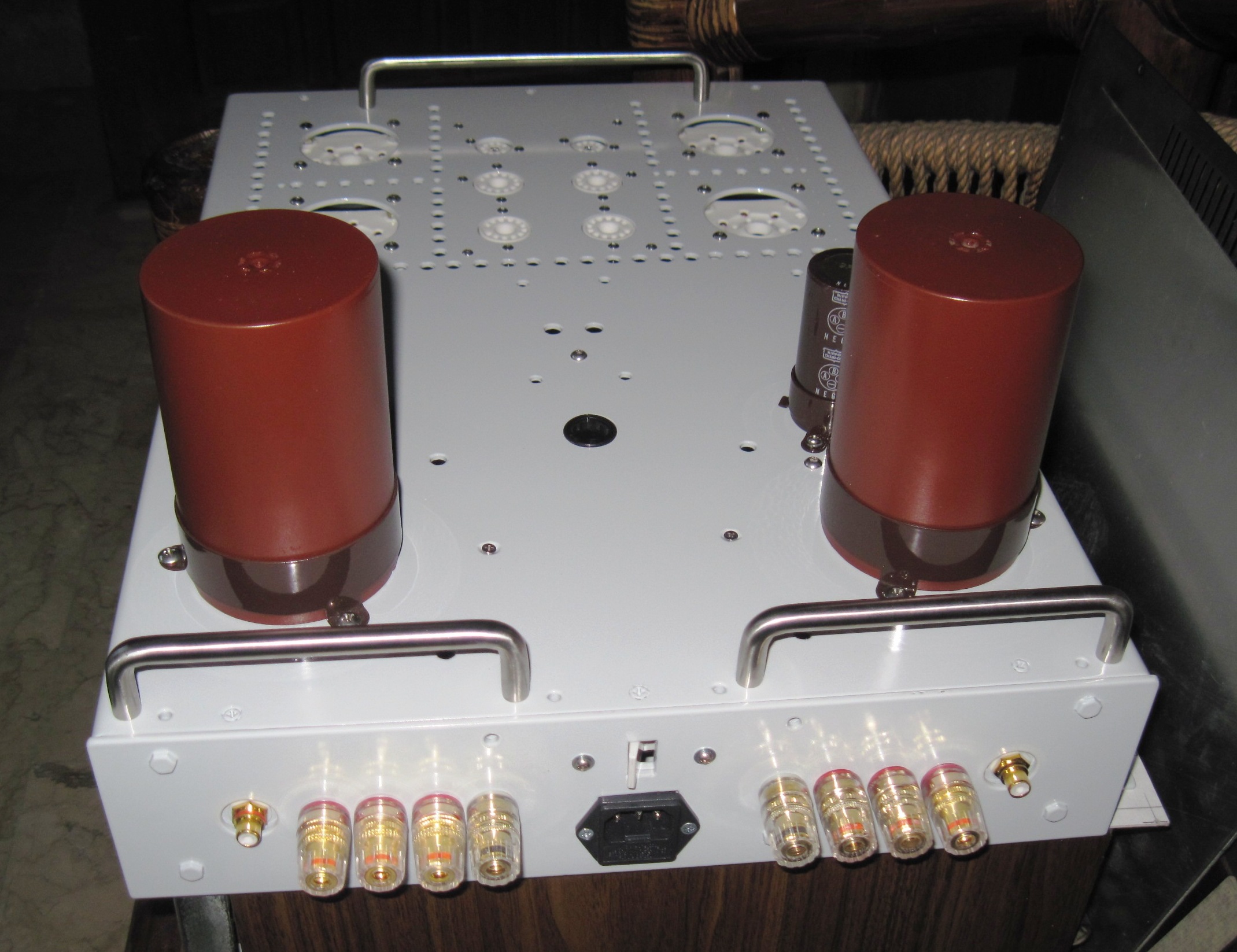

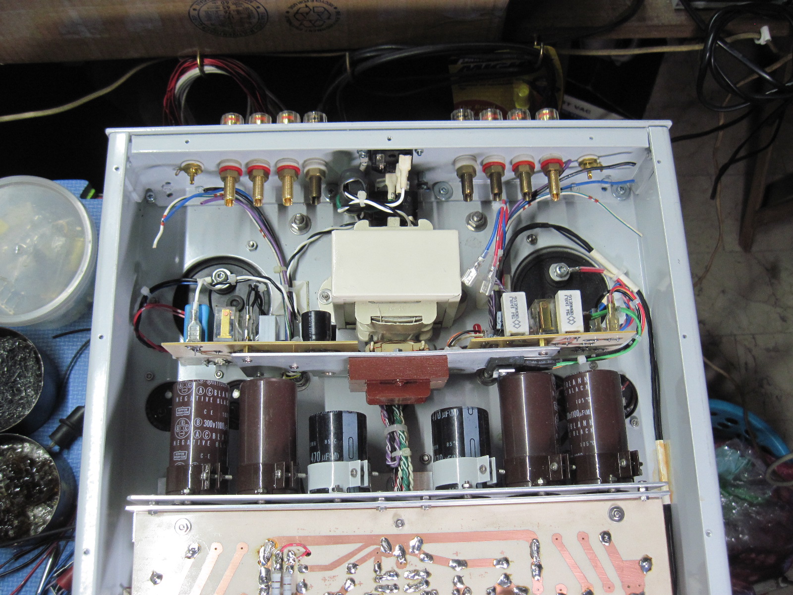

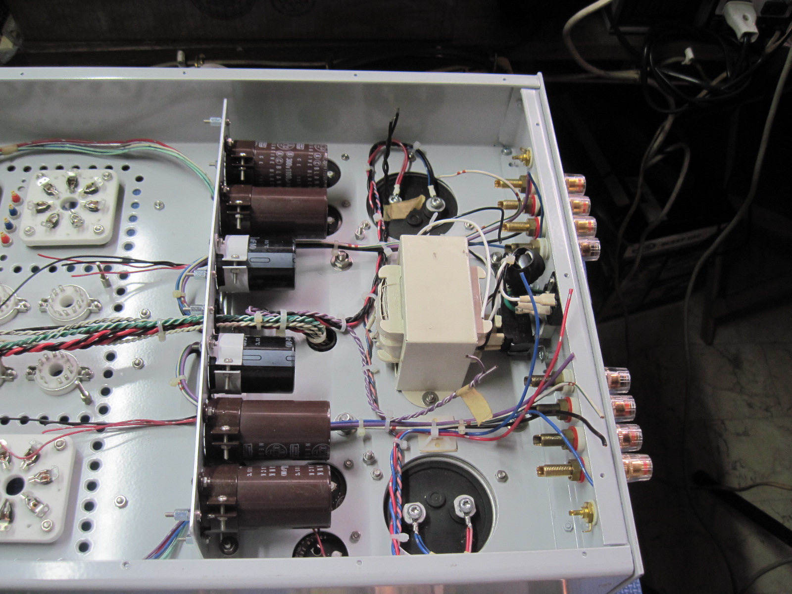

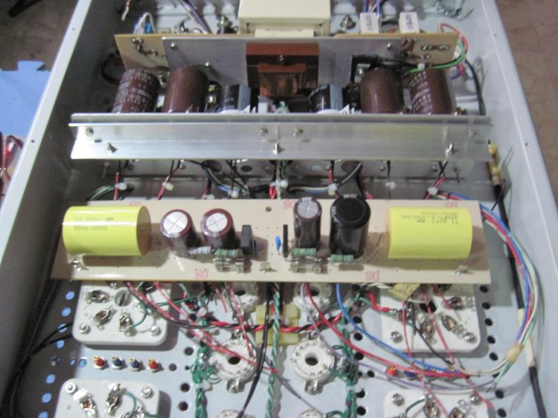

filter caps....more under the hood...😉
Hehe yea so far I understod but what brand/type?
And whats the stuff under the 6C33's cathodes? Biasing chokes?
Mighty fine looking chassis. HeyBill
thanks, though made of aluminum, it still is heavy....😉
posting more pictures soon...
the OPT has a tertiary winding that connects to the cathodes for partial feedback, i am not using global feedback...

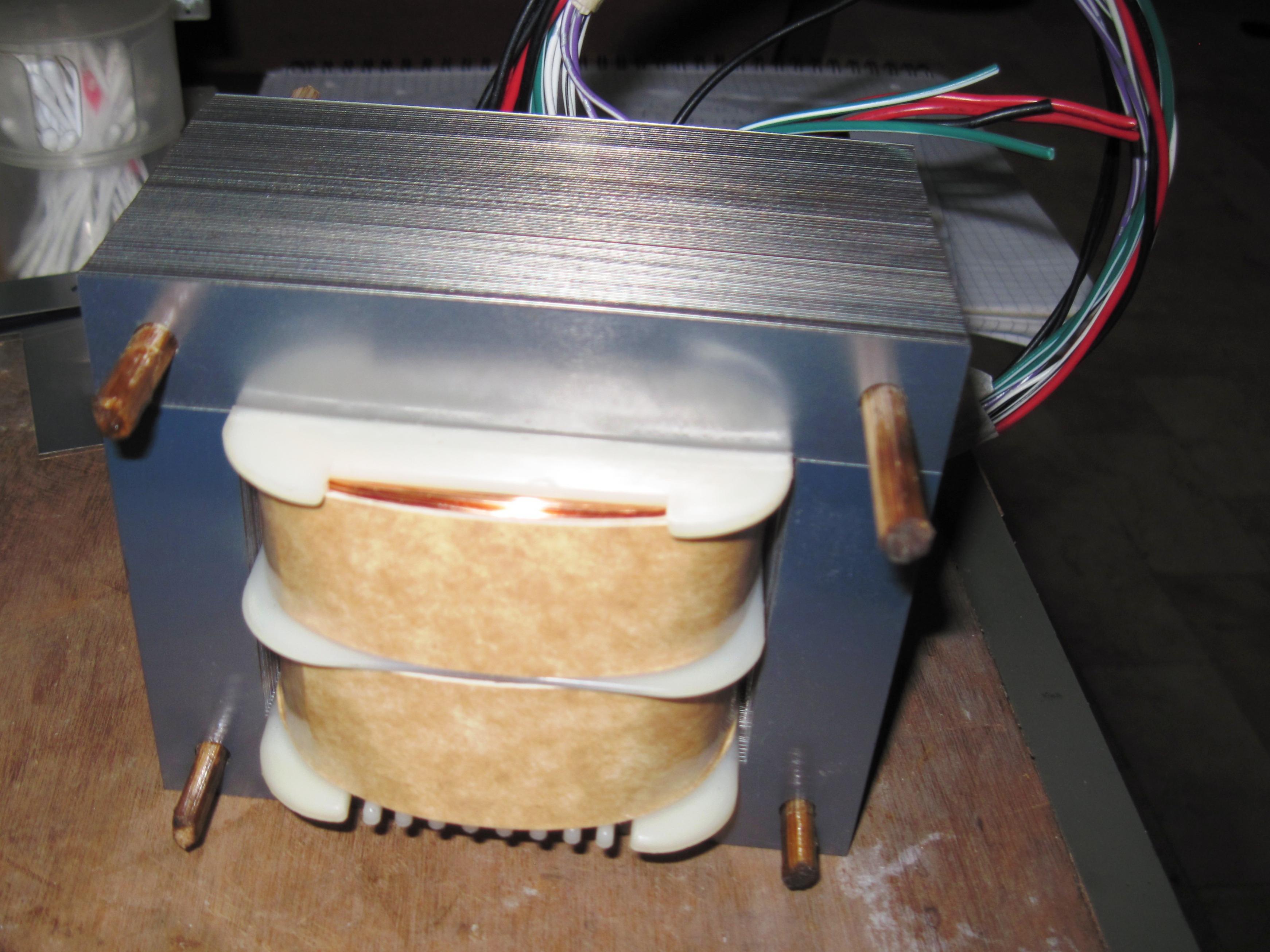

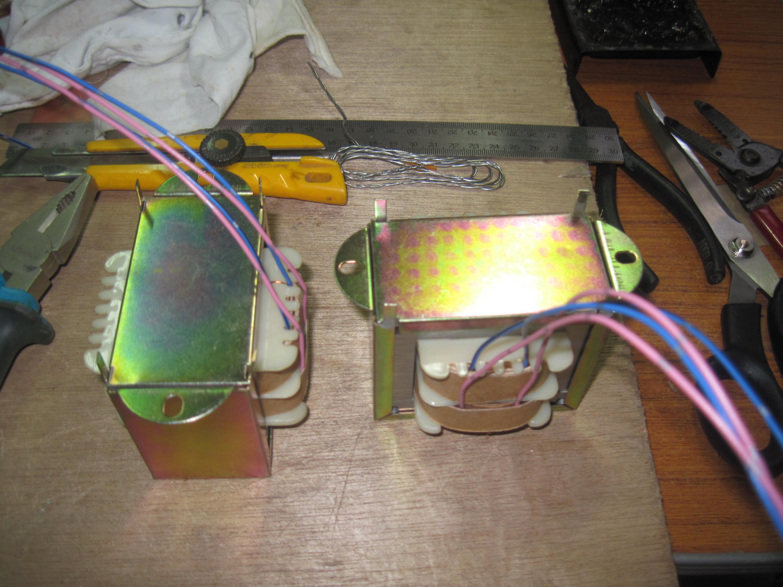

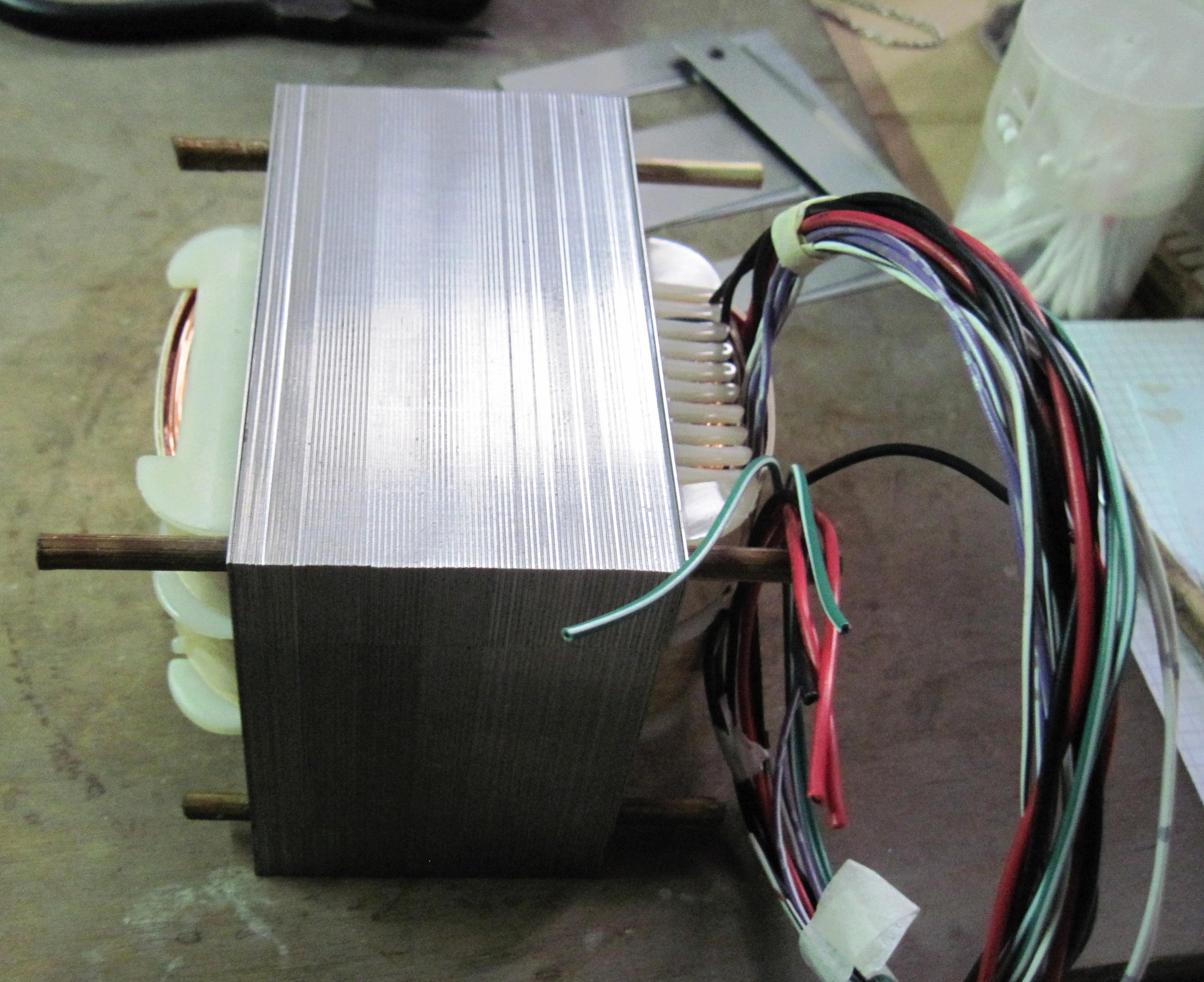

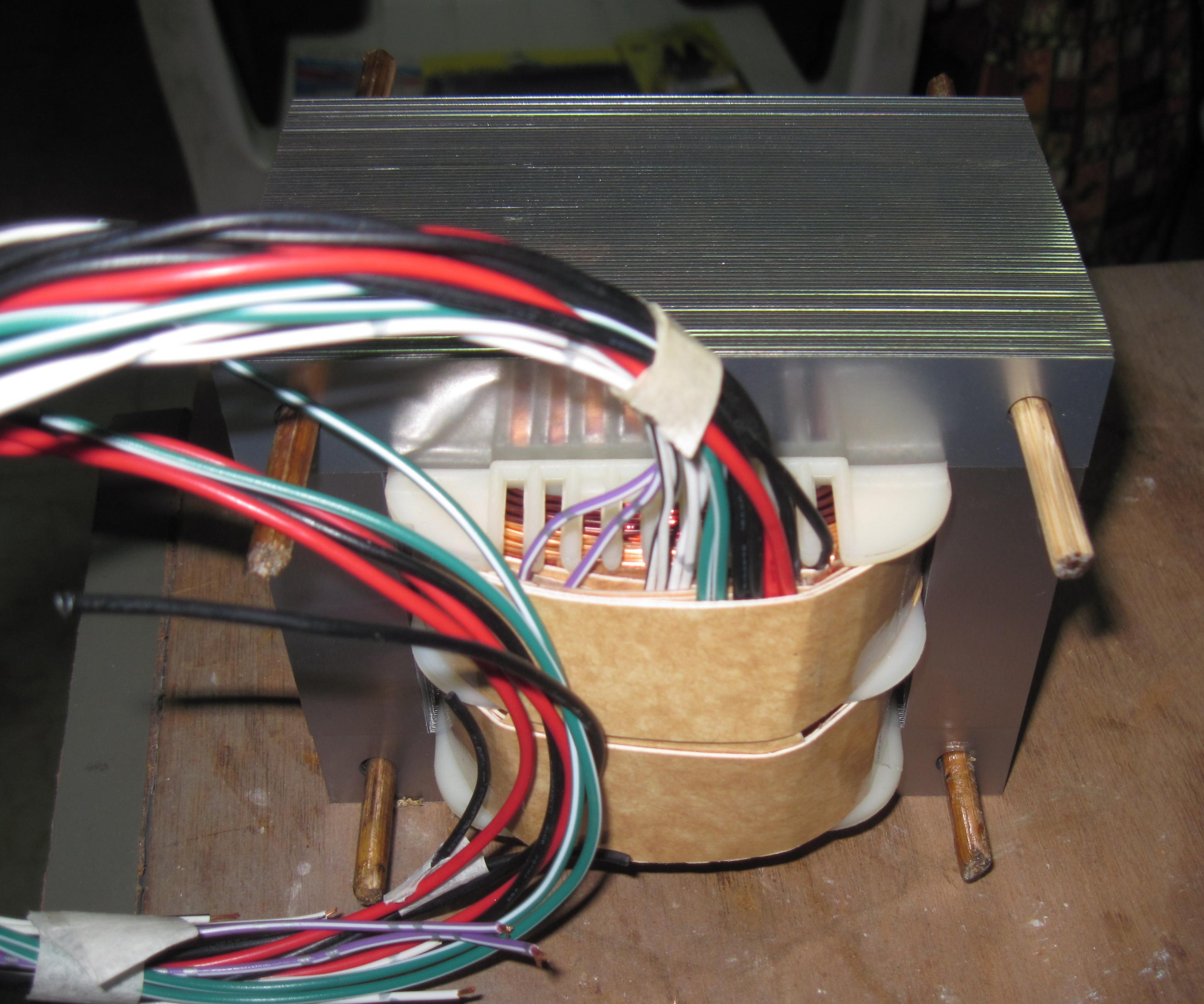

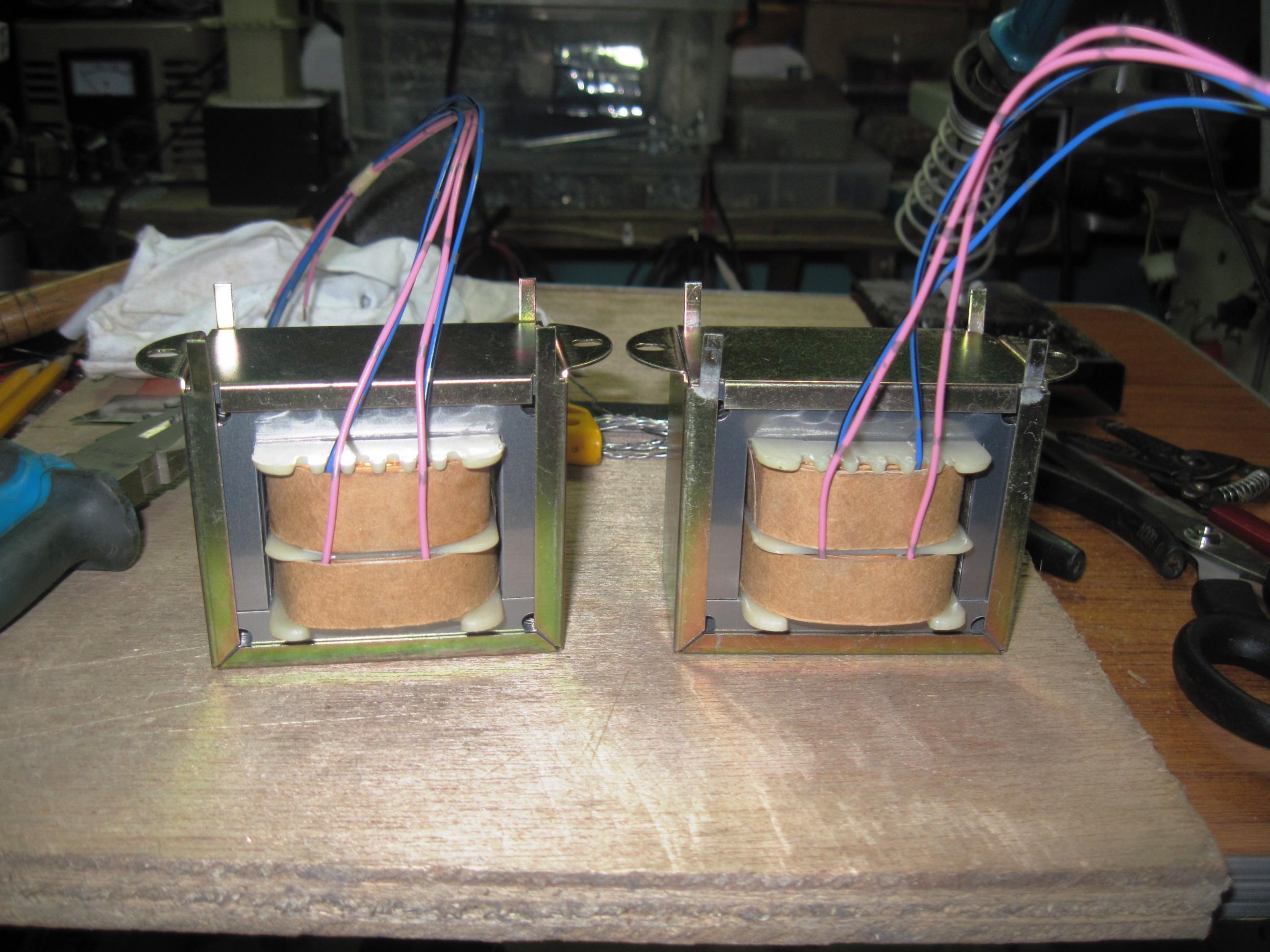

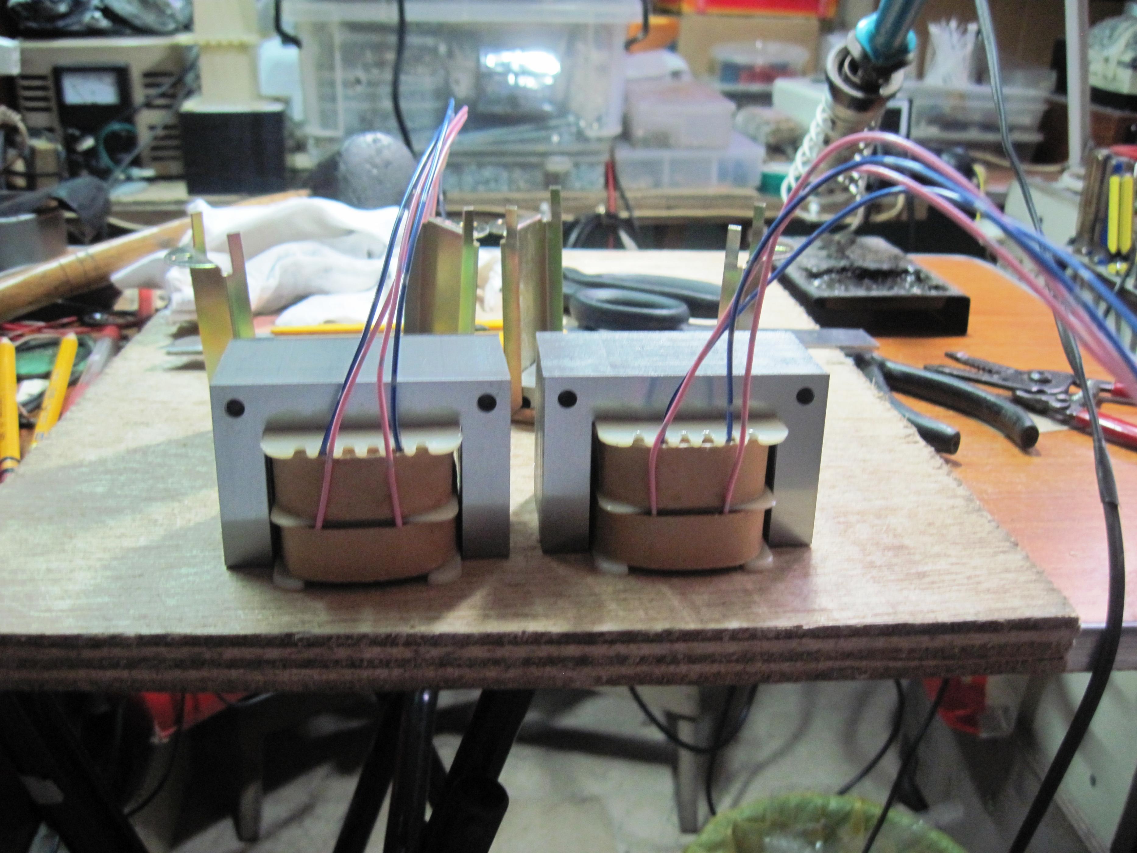

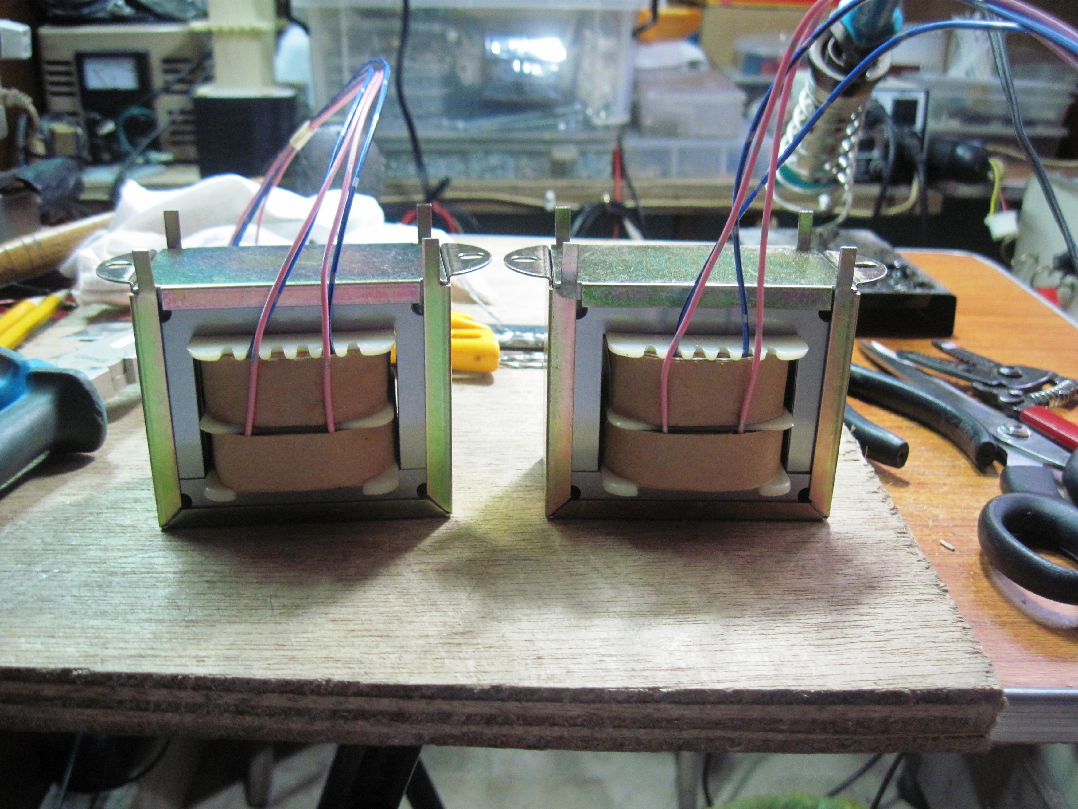

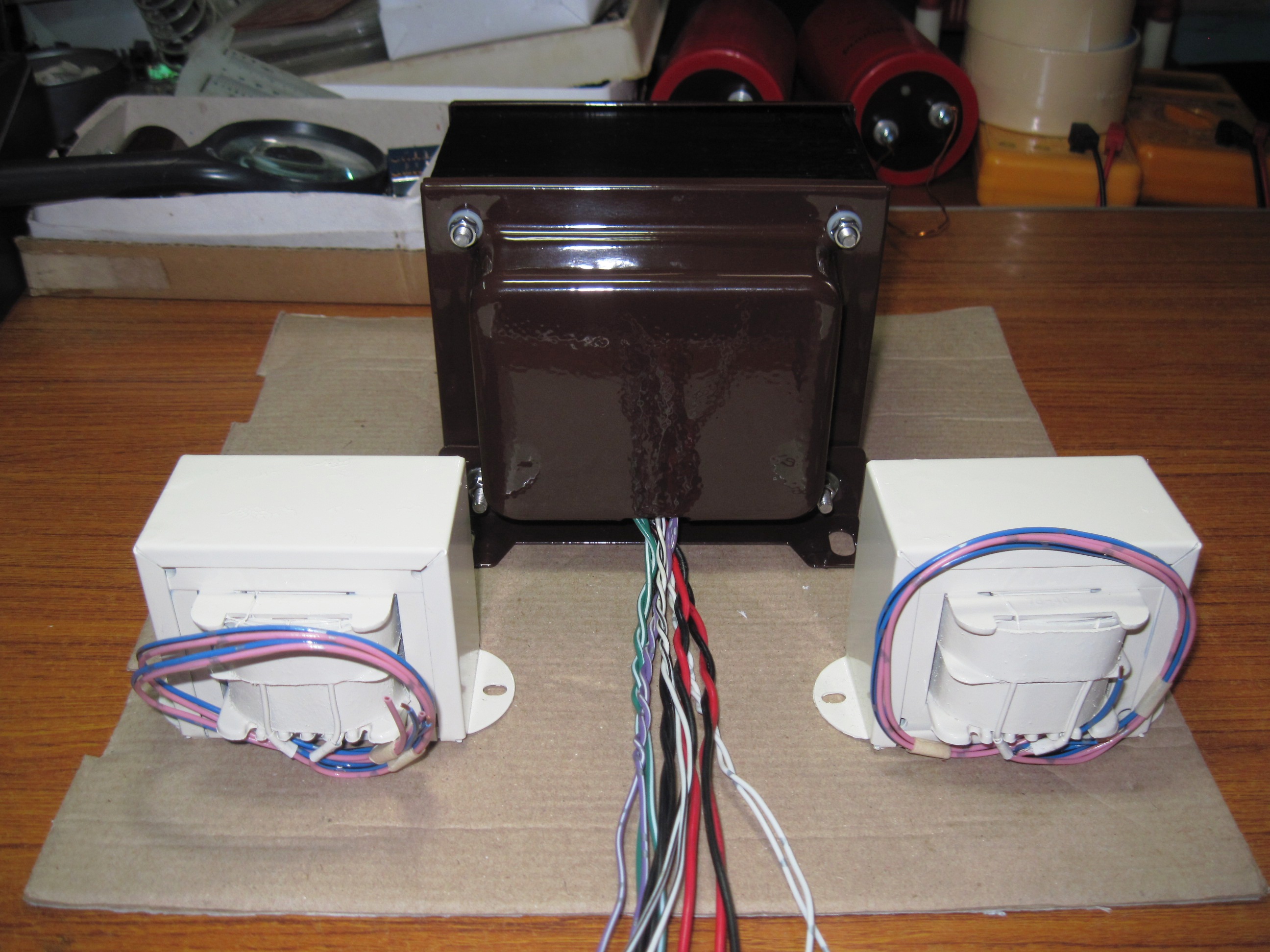

power traffo and choke....
power traffo is made out of a 1 3/4 inch center leg, stacked to 3 inches and can handle 750 watts...
filter choke is 1 inch center leg stacked to 1 3/4....
