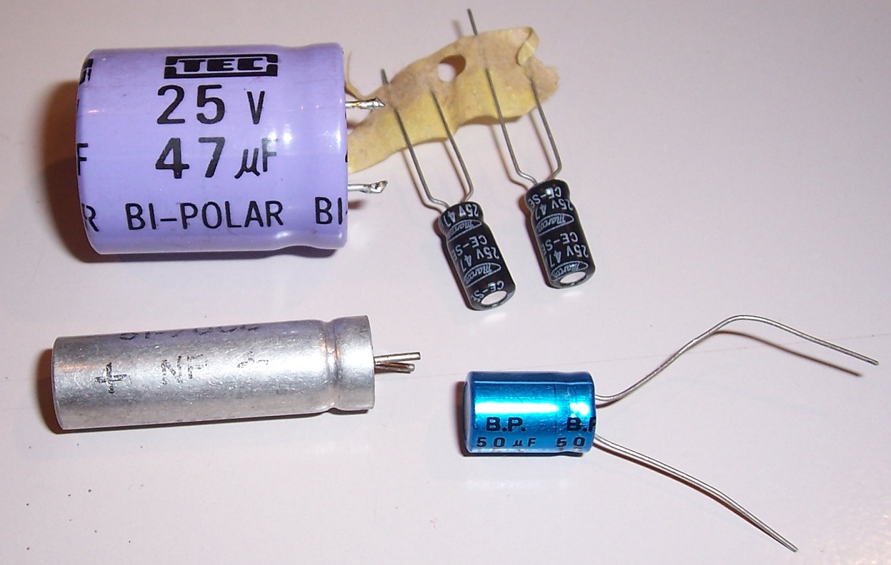

Bipolar electrolytics are not two capacitors back to back, although they do have two oxide films back to back (with electrolyte between them). The inductance would probably be about the same, and in any case inductance is not an important characteristic for a PSU reservoir cap.
It is still not clear to me why anyone would choose to use a bipolar cap for a PSU. It has no advantage, so why even consider it?
I've noticed that the measured dissipation factor tends to be quite low with bipolars, but given the rest of the disadvantages and the fact that you can buy low loss standard caps, there's just no reason to use them for PS duty.
Other than the ones specified for loudspeaker crossover duty, I've seen fine print (the manufacturers catalog or app notes) that suggests bipolar caps aren't for AC duty at all, but are for situations where the final polarity isn't known for some reason, or the OEM wants to avoid any possible chance of installation error.
As for sound (or lack thereof) I always have to ask, "what circuit?" and "what location in said circuit?". There are so many variations it's hard to believe any rule of thumb applies, assuming the differences aren't attributable to other biases.
The ones that exhibit that attribute tend to be huge, considering their CV product: here are three examples, the small black ones are ordinary 47µ/25V polarized, shown as a reference.I've noticed that the measured dissipation factor tends to be quite low with bipolars,
The huge mauve one is quite good (but doesn't even come close to a metallized paper), the long, natural aluminum one is intermediate and the (relatively) small blue one is only marginally better than the polarized. Its only advantage is its polarity-indifference.
These are rather old examples, modern types probably do somewhat better, but given the advances also seen in the film-cap tech, they are probably the best choice in most circumstances (even the lowly PET's)
