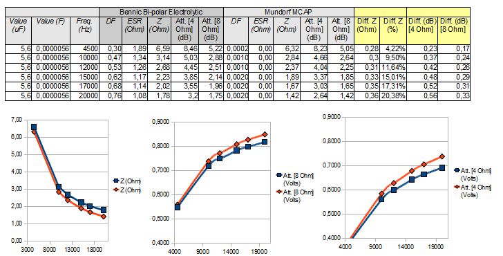

Generally true, but... watch out that ESR doesn't bite you. I've recounted a few times how I made a speaker sound much worse by changing a nonpolar electrolytic to a good quality PP cap- the speaker designer, who was apparently much smarter than I, used the ESR as part of the transfer function. Lesson learned.
ESR of a capacitor is particularly important with bass filter capacitor shunts, since a tiny resistance has a big effect.
The thing to understand about capacitor ESR is that it IS often significant in crossover design. If you replace non-polars with better polypropylene or polyester, you should take the changed ESR and consequent tonal level changes into account. Often this is done by adding a 0.5R wirewound in series to the film type. That's all.

After replacing bipolars in my loadspeakers crossovers with PP counterparts I've heard improvements but tonal balance was impaired.
I've asked on the costruirehifi italian forum about it and, initially, I've had skeptic answers (it's skeptic oriented forum.. 😀).
Then I've demonstrated with some calculations and help from forumers that, particularly in parallel to drivers, replacing a NP with a PP cap could lead to 1-2 dB difference in frequency response...
To re-balance my speakers, and retain the performance improvement, I've had to compensate for the ESR and impedance difference with series resistors.
This leads to the possibility that some subjective evaluations on replacing NP with PP caps can be influenced by the ESR and impedance difference.
