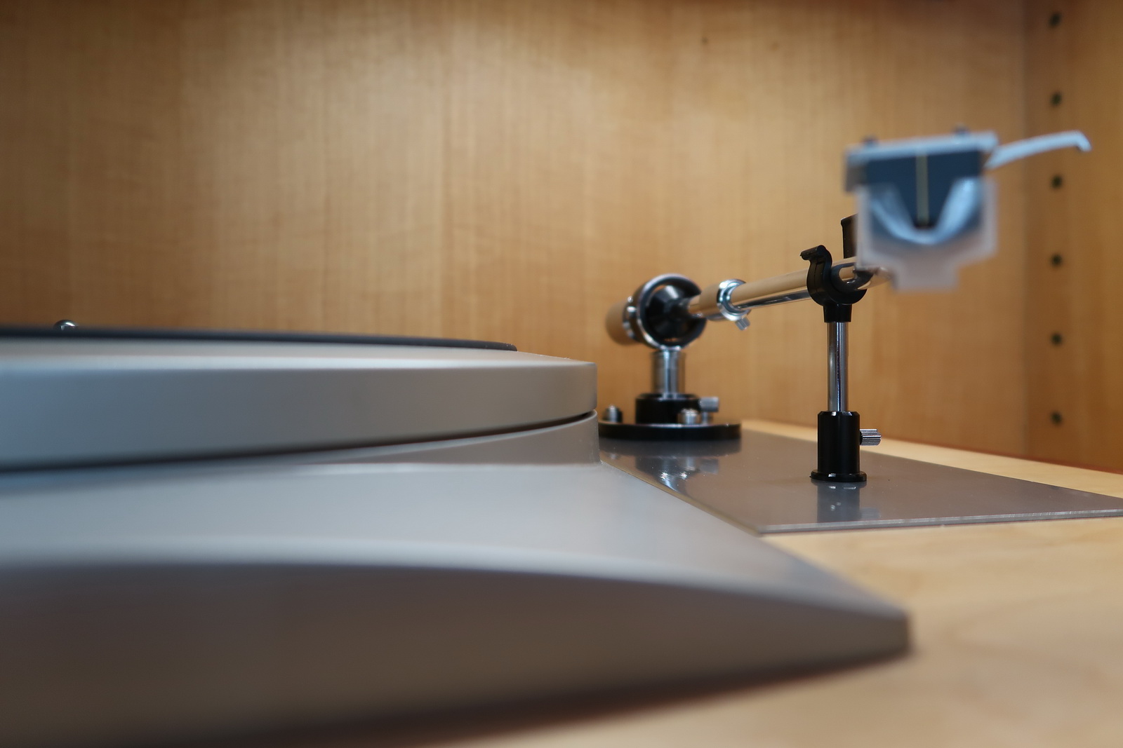

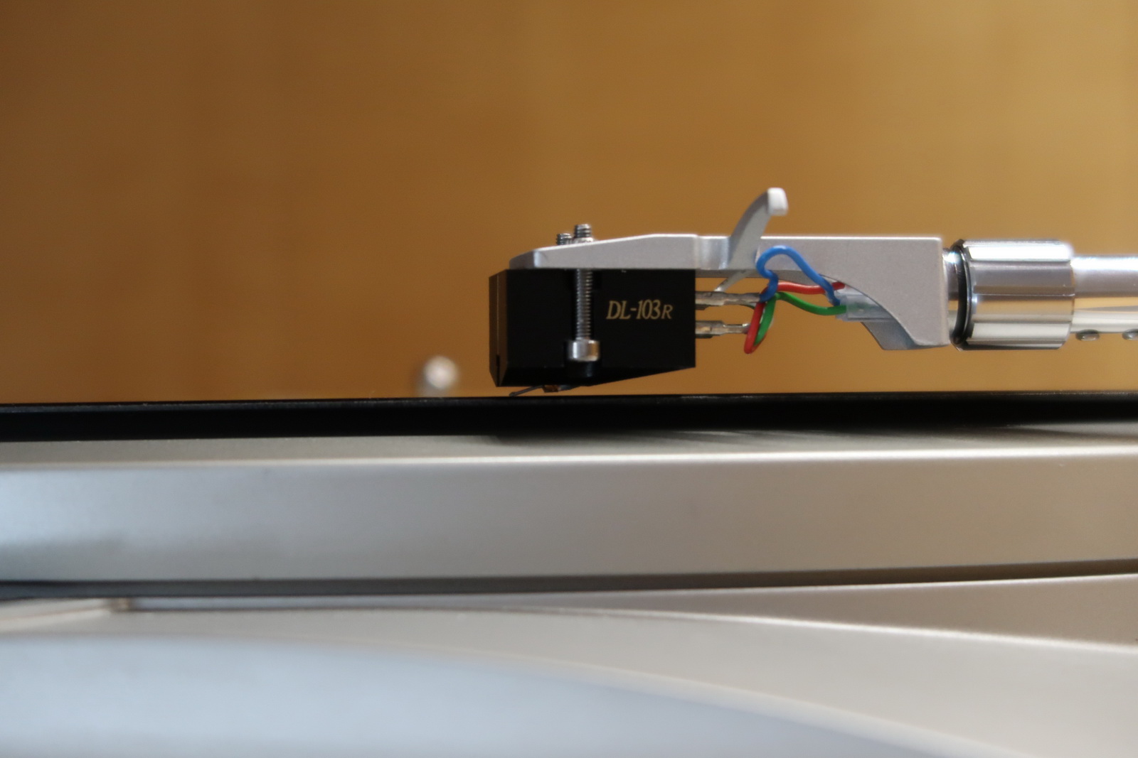

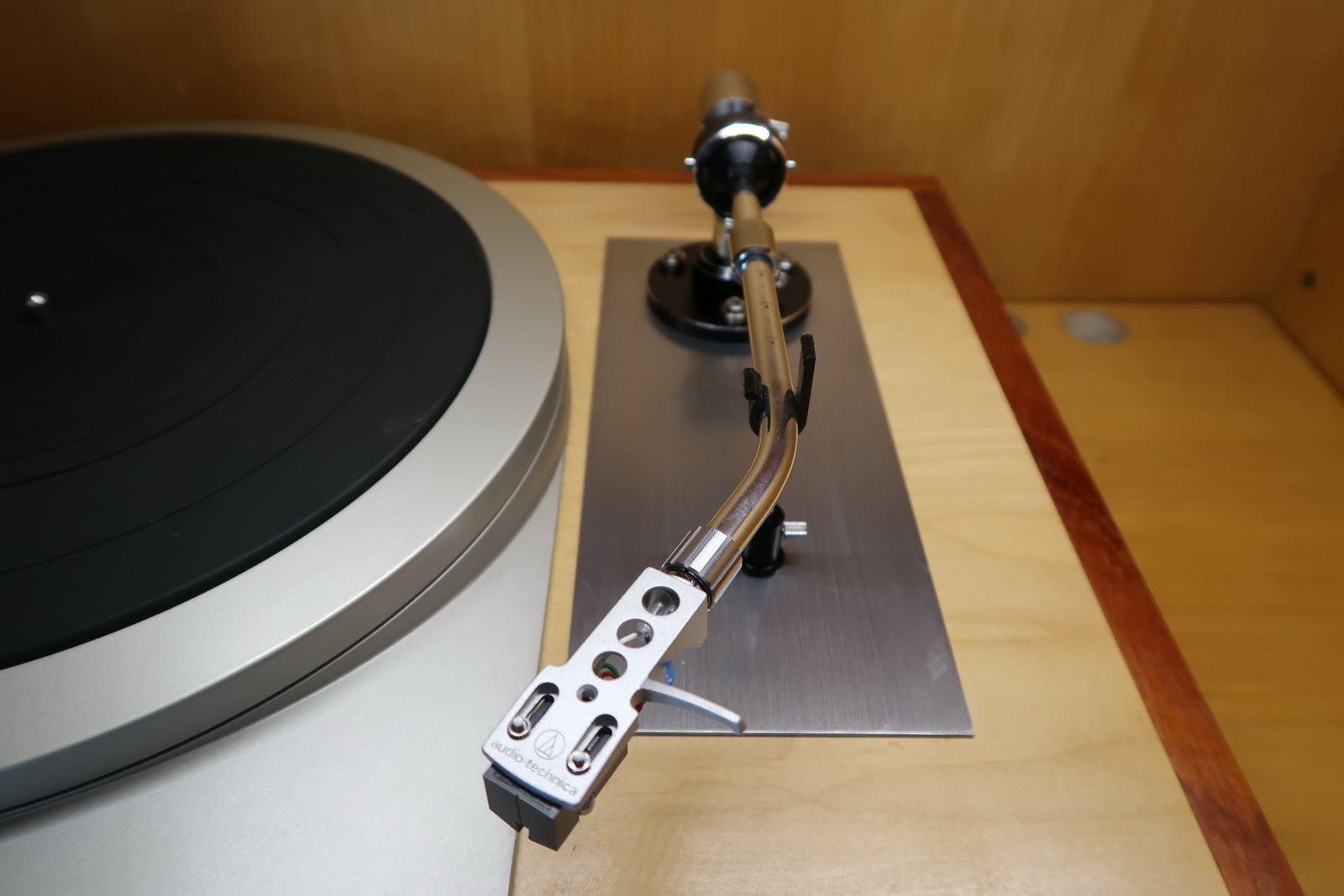

Hi Chaps,
I have just finished building my SP-15 plinth and installed an AT ATP-12T tonearm.
I did an in-depth search on the internet, images, articles, etc, but I have not found anything regarding set-up.
Please help.
With thanks,

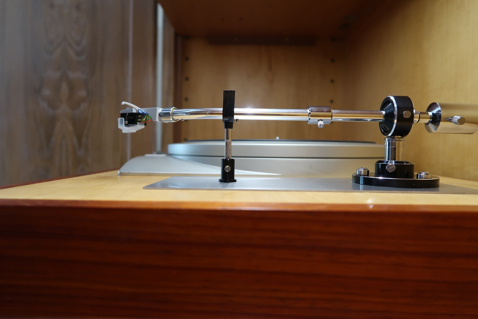

I was able to adjust the tonearm height parallel to the record surface but the lower the arm the smaller the gap between the record and the cantilever, it is dangerously close.
Do you have it this way in your set ups? Please see photo.
Many cartridges are low riders when adjusted to parallel. "Supposedly" when the top of the cartridge is parallel you should be very close to the cart designers intended SRA. Ortofon on their Cadenza line says the bottom 2/3rds of the cartridge should be parallel to the record surface and that looks a little tail down when viewed from the side. That statement is direct from Ortofon De BTW. I think your picture LOOKS proper. You'll have to dial it in by ear. Try moving up in small increments and then down.
Keep in mind as you adjust VTA VTF will also change, as you lower the back of the arm VTF will reduce.
I'm with Rog Grandy on the fact VTA has an almost negligible effect on sound. VTF and getting overhang and alignment correct are far more important on sound.
