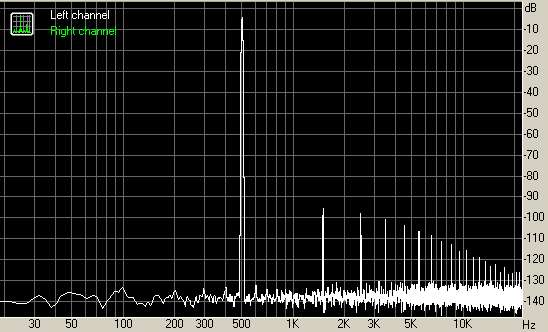

I had been fooling around with creating a wav file of a pure tone and observing what kind of loss of precision generates what kind of distortion and thought I'd share some results with you.
It is a common belief that computing upto the 7th degree of the Taylor series for a sine function is a good enough approximation for a sine function.
Wrong. You need alteast one more degree i.e. upto 9th degree to achieve a sine wave which has very little distortion.
Here's a screen shot of the FFT of a 500hz sine wave produced with the sine function computing only upto the 7th degree -

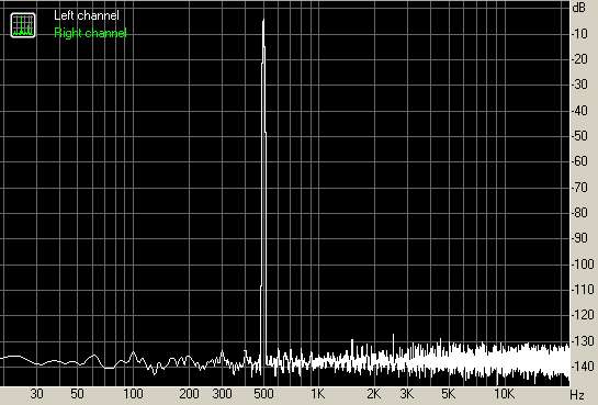

and here's a screen shot of the FFT of a 500hz sine wave produced with the same sine function, but computing upto the 9th degree -
FFTs were done with the spectrum analyzer provided in RMAA 6 with a Kaiser window of atleast 15.

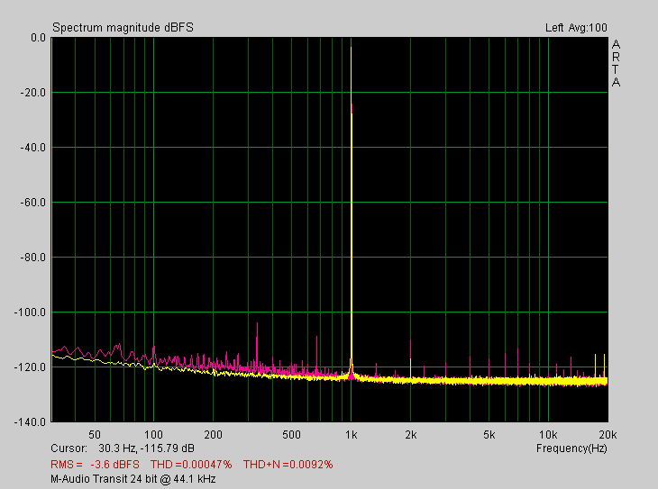

FYI, have also a look here: http://www.fesb.hr/~mateljan/arta/
It works with 192 kHz soundcards as well. The build-in sine generator can do dual tones with adjustable ratio quite accurate. Attached a picture of a loop through measurement of my USB soundcard at 44.1 kHz.
