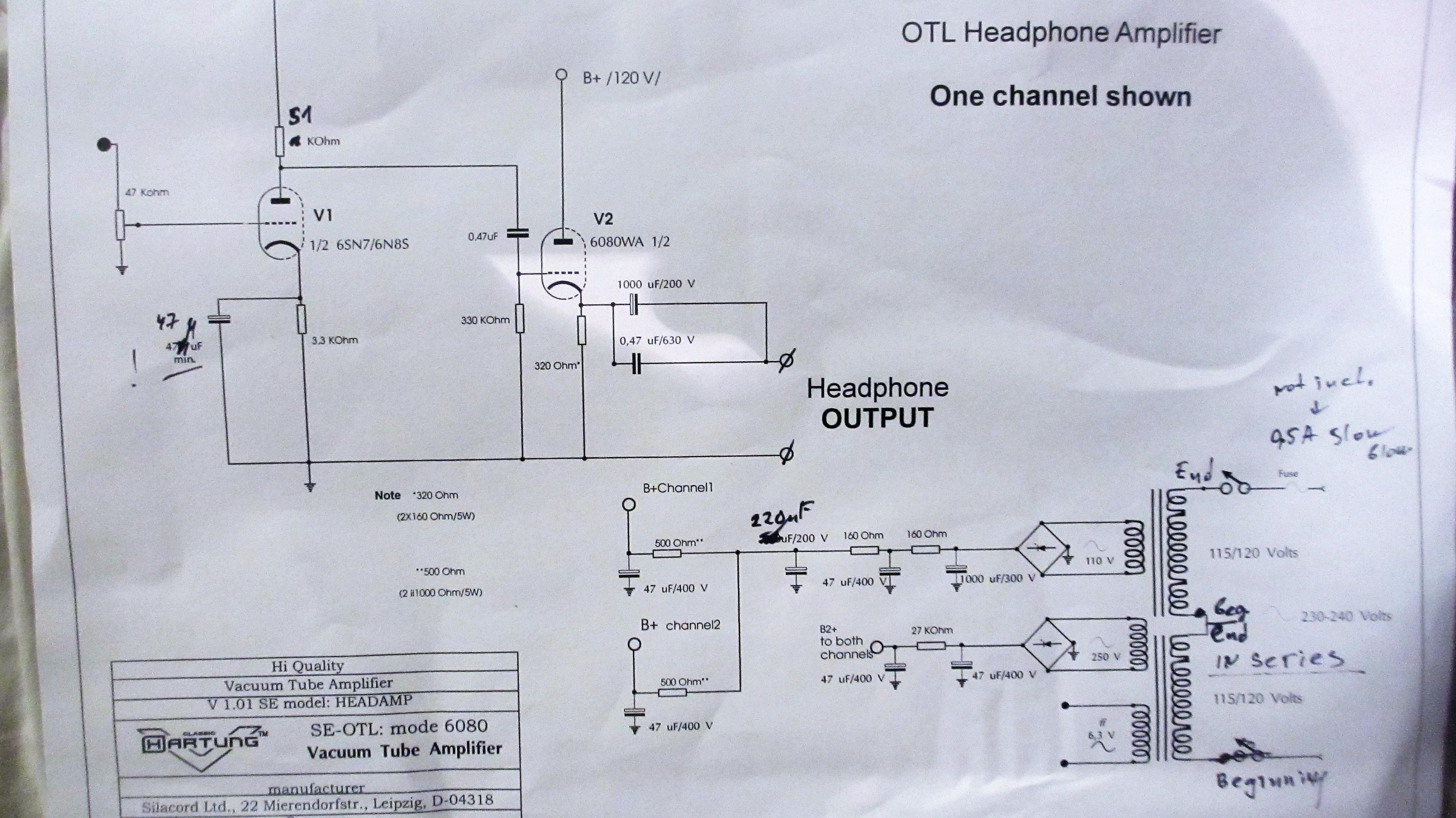

I would change the output capacitor to 47uf from 1000uf as the headphones will bear the full charge current and possibly be destroyed by it.
600 ohm Headphones yeilds 5.6hz low pass frequnecy
