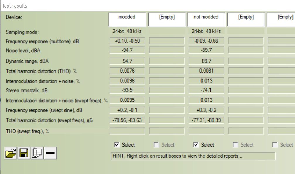

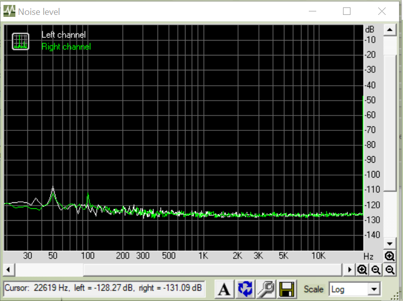

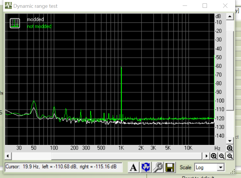

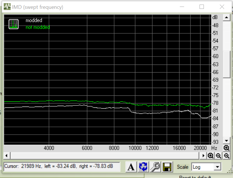

And controls at 0 don't disengage the circuit in this amp and cause subtle but audible skewing of Freq. Response. A whole 1 db difference between low mids and treble, favouring the treble. Yamaha claims -+0.5 20to20k so -0.5@300 and +0.5@8khz still within spec. Now is ruler flat. Noise, IMD and crosstalk parameters improved significantly. Noise improved significantly because voltage gain was lowered on power amp.
See the graphs below. First one is after mod.
:magnet:
The lost gain apparently is still a mistery, but my ears are happy.
For what it's worth graphs are happy too.
Big thanks to Mooly and others that had the patience in helping.
