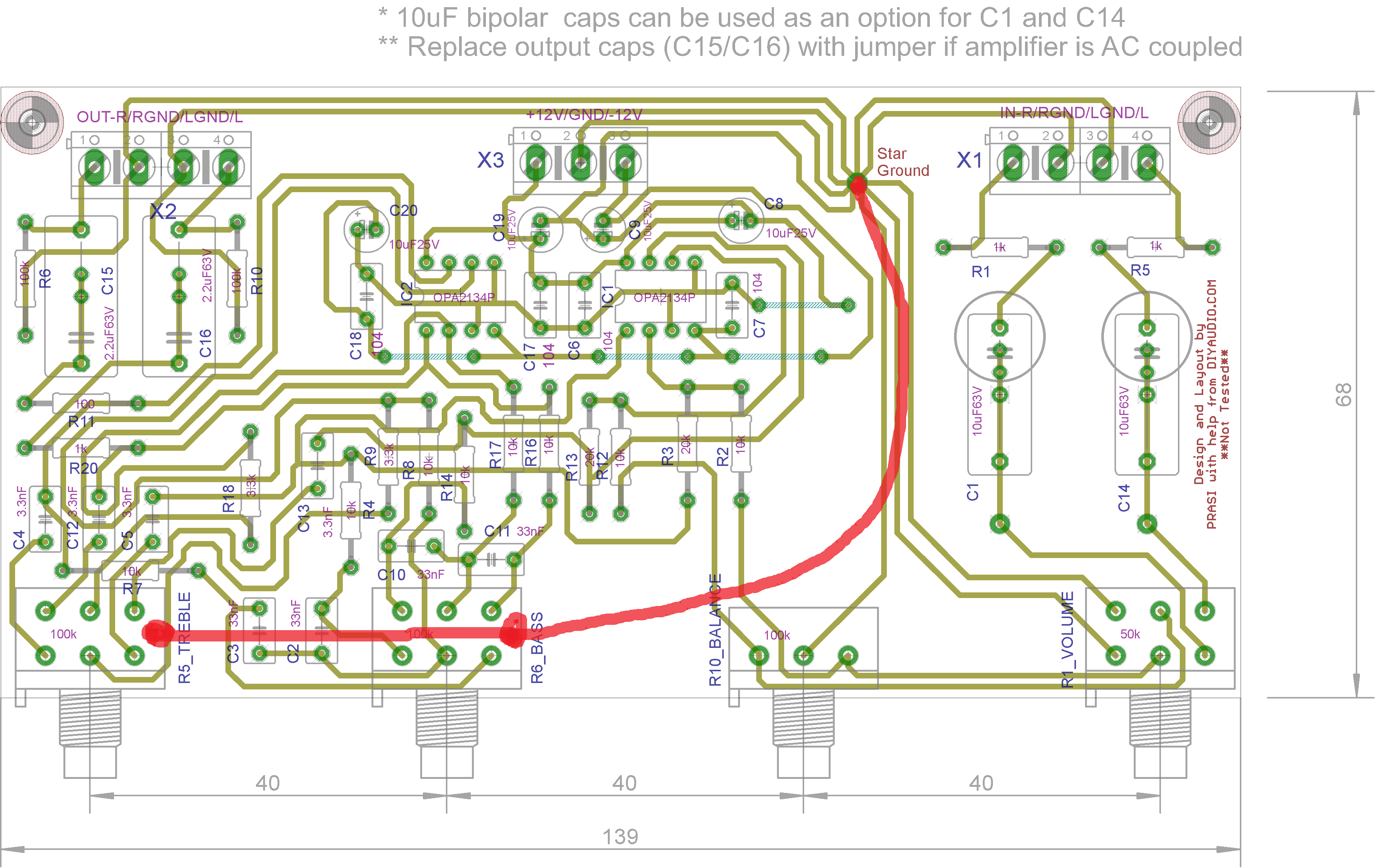

prasi Member Joined 2014 sites.google.com/site/analogdesign1234/ Paid Member 2015-07-12 7:04 pm #41 2015-07-12 7:04 pm #41 Hi, thanks for the reply. I will recheck the layout for bass connections. and also recheck all comp values. Regarding the grounding scheme, should I try something like attached pic? reg prasi Attachments layout - Copy.png 418.2 KB · Views: 333 Mooly Moderator Joined 2007 Paid Member 2015-07-12 7:49 pm #42 2015-07-12 7:49 pm #42 Yes, grounding the pots like that is definitely worth trying. Prev 1 2 3 First Prev 3 of 3 Go to page Go Status Not open for further replies.
