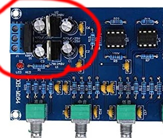

Depending on Preamp actual consumption (3.5mA per TL072 class Op Amps, about 8 mA for 5532 class) you may easily get your +/-15V from available rails (nominal +/-25V), easy peasy with 2 resistors, 2 zeners, 2 100uF caps.
No need for extra transformers, windings or regulators.

Yes. The tone amp board as shown previously has rectifier, filter and regulator on board and from dual +/- voltages I will supply single rail to phono board too. But since I am custom winding I have option to have separate winding for Tone board+phono board on same transformer. Since I dont have data about Phono Preamp IC (AN360) maximum voltages. I will go by Spec sheet which came with phono module (0-12V DC). So separate lower voltage than (amplifier's 15-0-15ac) will be safe I think.Depending on Preamp actual consumption (3.5mA per TL072 class Op Amps, about 8 mA for 5532 class) you may easily get your +/-15V from available rails (nominal +/-25V), easy peasy with 2 resistors, 2 zeners, 2 100uF caps.

Use 7812 regulator if you feel voltage will be an issue, input about 15 VDC.
