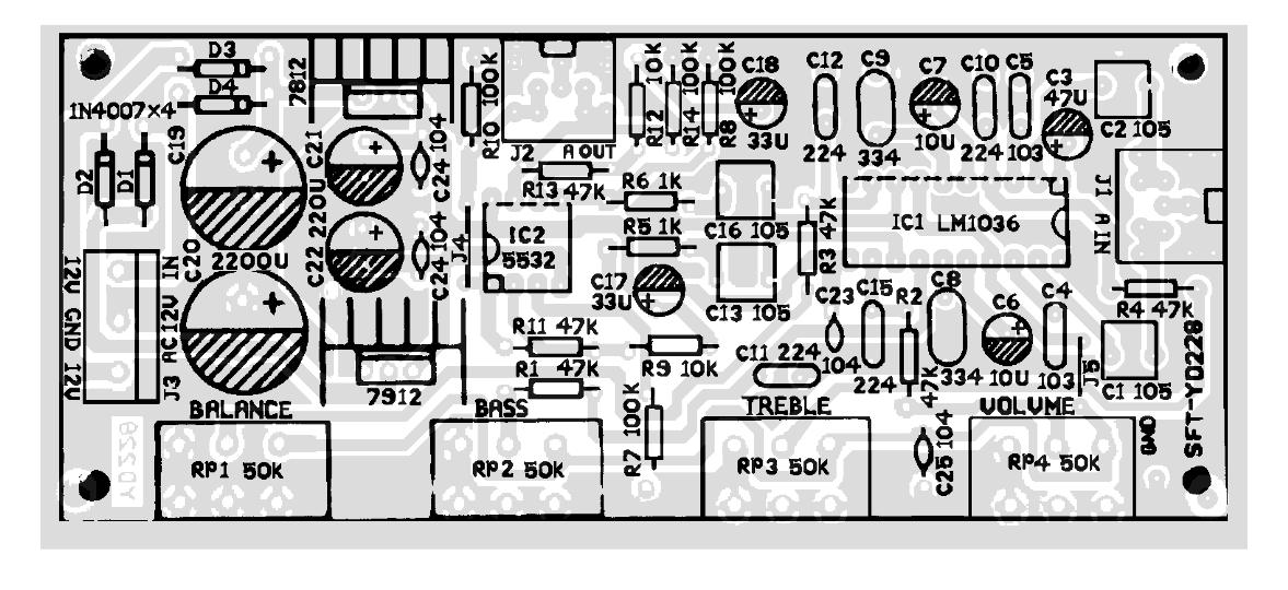

i agree that this topic is old but still i wish to know the behaviour of lm1036 tone control circuit ,first intial 10 % rise in volume control is almost zero ,means their is no gain ,is this the charectaristic of the tone ic ??,or some thing can be done ,anybody who would help

On the board you can see the OPamp 5532.
Signal handling-
quote- "The first stage is before the the tone control processing and provides an initial 15db of gain reduction , so ensuring that the tone sections are not overdriven by large input levels when operating with a LOW volume setting "
You could offset the gain control voltage into the useful range. But this is an analog voltage controlled gain, ie an analog multiplier, which are never very accurate and prone to distortion. It is useful for cheap consumer products but I would never consider it for use where serious sound quality maters. Today, an alternative would be a DSP based design.
