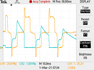

I was able to set up test conditions for a 'no load' situation which would cause PP output stage plate voltage to exceed the 0V to 2x B+ window. The test conditions did require near maximum amp volume and tone pot settings in order to force the plate over-voltage excursions, which aligns with various on-line comments I have come across over the years.
The plot below was with 2 cycles of a 30Hz waveform, although the preamp and driver stages would influence the grid voltage waveform shape presented to the output stage, so the drive waveform to the output stage grids would not be a lab-grade 2 cycle square-waveform.
The orange trace is the plate voltage (approx 200V/div) for one side of the PP output stage, where B+ was 500Vdc. The blue trace is the cathode current (100mA/div) for one of the 6L6GC on that side.
There is a MOV across each half-primary winding with a nominal 612Vdc min 1mA rating - those MOVs are likely just starting to load the over-voltage transients, but investigating that further is for another day/thread, as this thread was mainly about using a tone-burst as a tool to investigate stressful events.
