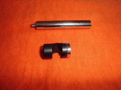

So after thoroughly reading the following links and debating on the turntable forum without much luck, I decided to go ahead and not settle for the extra mass load of the accessories provided by MS for the MA707. These are, a "rider" and a screw behind the pivot point. The sound was good, but "something else was missing".

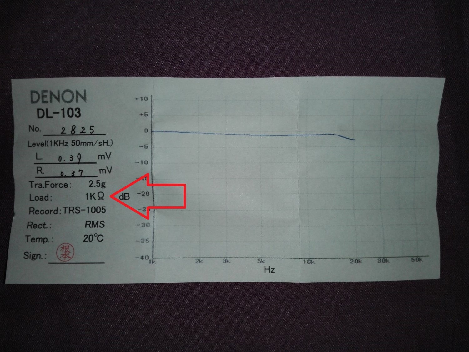

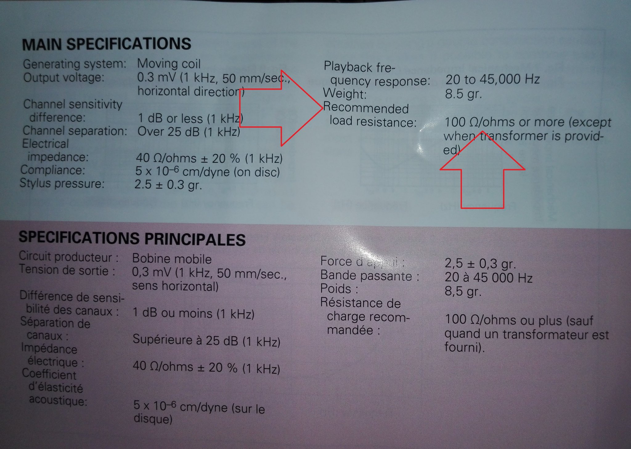

This now sings for real! The soundstage has opened, the dynamic range has increased, the bass is deep and fast. And I still need to try raising the load of the phono preamplifier from 470 to 1000 Ohms to see if the treble rises something, in the leaflet
that came with the cartridge it indicates that it was tested with 1 Kohms, an apparent Denon contradiction, because in the Attached brochure describe as recommended load 100 Ohms.
While I don't think it makes much of a difference, I'll give it a try, that's easy, just run two Dip's.

Here the load used for the measurement of FR and that recommended as Denon as the minimum.
There are opinions of supposedly "seasoned" people who claim that the internal impedance of this cartridge is so low that the inductance effect can be neglected! And that can then be used with the "standard" of 47 KOhms for MM! 👎
A nonsense, it seems that they did not know Ohm's Law.
40 Ohms of the DL 103 against 47000 Ohms will make a transfer of energy so great towards the preamplifier that it will leave without perceiving the small voltages generated by the conjunction of the generator and the damping of the cantilever, that is, the treble will be increased but the bass will suffer!
So the practical limit is 1000 Ohms. And if you want to load them with 100 or 470 ohms, go ahead.

These are the extra weights provided by Micro Seiki as I mentioned below ,
" These are, a "rider" and a screw behind the pivot point."
