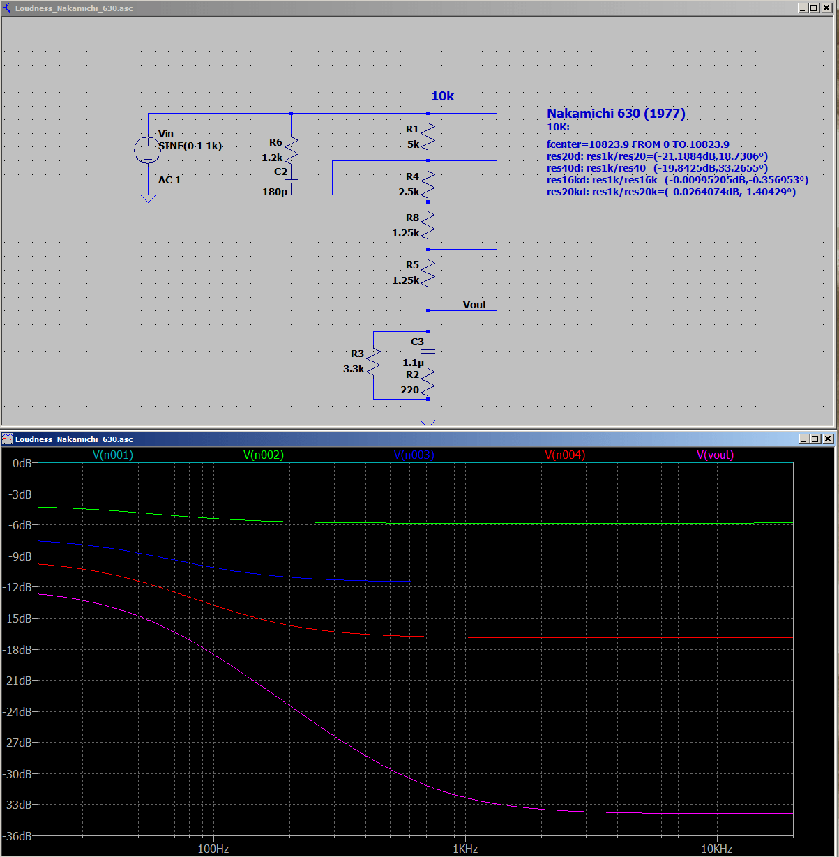

Almost the first thing I did when this thread appeared was look up the Nakimichi 630, because I remembered its enigmatic 'Contour' control. According to the user manual it "Provides high and low frequency compensation for low listening levels.."
It seems to operate in much same way the usual centre-tapped-pot loudness control, but is configured rather differently. Two back-to-back electrolytics form the LF time constant, which I think rather iffy for distortion.
Nakamichi 630. Nice!
Reactions: lene

From the 630 user manual:
CONTOUR
The normal position of this control is fully clockwise.... To use the contour control, first turn it fully clockwise. Turn up the volume control to normal maximum listening levels. Then turn the listening level down with the contour control instead of the volume control. loudness compensation will take place automatically.
So, two controls, as suggested by Adason.
Virtually word for word how Yamaha describes proper use of their continuously variable loudness control.
I suspect many customers were confused and unimpressed with it (those who do not read user manuals), however it does precisely what it should do when it is used as intended; which is to apply more F/M curve at lower volumes and less at higher volumes.
Whether they "got it right" with respect to transition point frequencies is arguable, for sure.

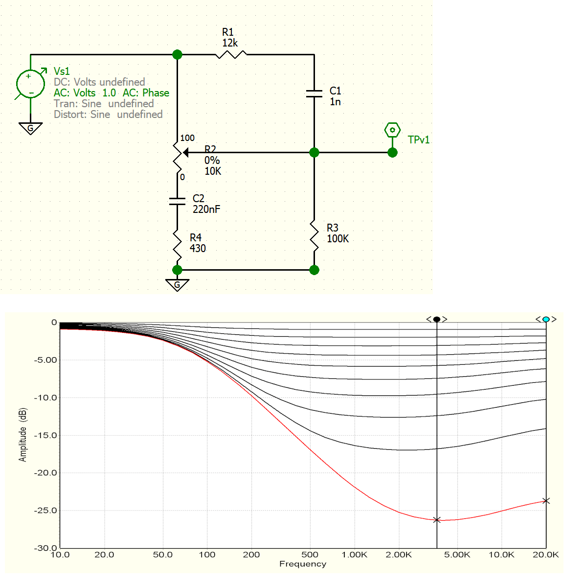

This is my fully clockwise = "out of circuit" passive loudness circuit. it aims to track the difference between the curves of equal loudness charts. It works in combination with an analogue volume control in a preceding preamp stage. It feeds an active crossover which has that 100K input impedance. Motorised pots (loudness and volume). I did this many years ago before JRiver Media Center included a superior digital loudness compensator that is completely seamless and just works as you change the level with a different contour depending on the position of the 100 step 64 bit volume control. You can set the threshold for where it kicks in and can choose to allow it to touch treble or not. So this dinosaur has just stayed in the fully clockwise position for years along with the analogue volume control which has stayed at 12 o'clock. JRiver's digital "internal" volume and loudness is absolutely the way to go IMO. Wouldn't go back unless using other dinosaur stuff like LPs etc. but that would really be silly.

Hmm ...
That is a much simpler circuit than what I had sketched in my head. I had envisioned splitting the audio into two paths. One would be a traditional preamp and the other an aggressive loudness filter. A 'contour pot' would then be used to pan progressively into the loudness. I had planned on using Mr Self's latest filters published in AudioXpress for the loudness section. Your circuit makes mine look overly complicated.

Well the only fully featured version of JRiver is the Windows version. Anyway you have an analogue circuit there that works. The schematic was knocked up for me by a retired Sydney Uni physics professor friend. I shared the circuit with a retired mastering engineer who worked for Columbia in Sydney in the 60s and 70s twiddling CBS recordings for Australian LP manufacture. He was sufficiently impressed hearing it work here to want to replicate it which he did. He is quite happy.
