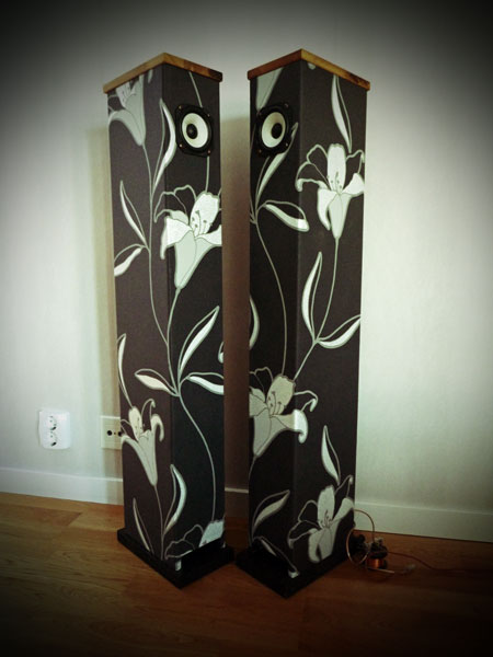

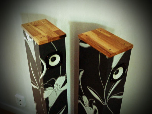

This is the rule I build my speakers after. Close enough is good enough, I build for my own fun.
I also think it's important to find a driver(s) with a sound you like and then try to build the best box for it.
As for the finish I have used wallpaper, the one on my Needels are pretty thick and stiff perfect for covering small errors.
As a bonus they are also allowed to be inside the house... 😀
Be proud of what you build and always enjoy the work, I think DIY is all about having fun and giving you a "Feel good" feeling.
//Mårten
