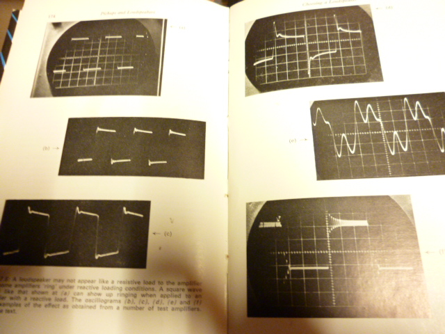

Big differences to todays speakers compared to the previous generations of tube amps which used a single cone and had only minimal crossover phase shift with very low feedback compared to chip stuff these days, ie the 6dB/oct rolloff was very tame for global feedback stability compared to the mid 1980's 24dB/oct Splendor systems. This was a severe test in tube amp stability as many found out when electrostatics and even worse when piezo's came on the market.
What one forgets is it becomes "shockingly applied" if an incompatible LS system is connected to a tube amp which uses unforgiving amount of global nfb to ride it's shortcomings PLUS instability ! Perhaps, initially I didn't make myself clearer.
You must remember those early single coners and maybe a capacitive coupled tweeter, many listeners still claim the simple 6dB system sounded better than the high order types ?
So many people don't realise what's going on at the speaker end and the interaction with the global feedback network, esp when there's nasty phase changes, poor circuit damping; and concentrate too much on a perfect amp design without seeing the rest.. I've been through 50 yrs of it, still baffled to how some people claim excellent sound with some of the most appalling waveforms. Oh well.
