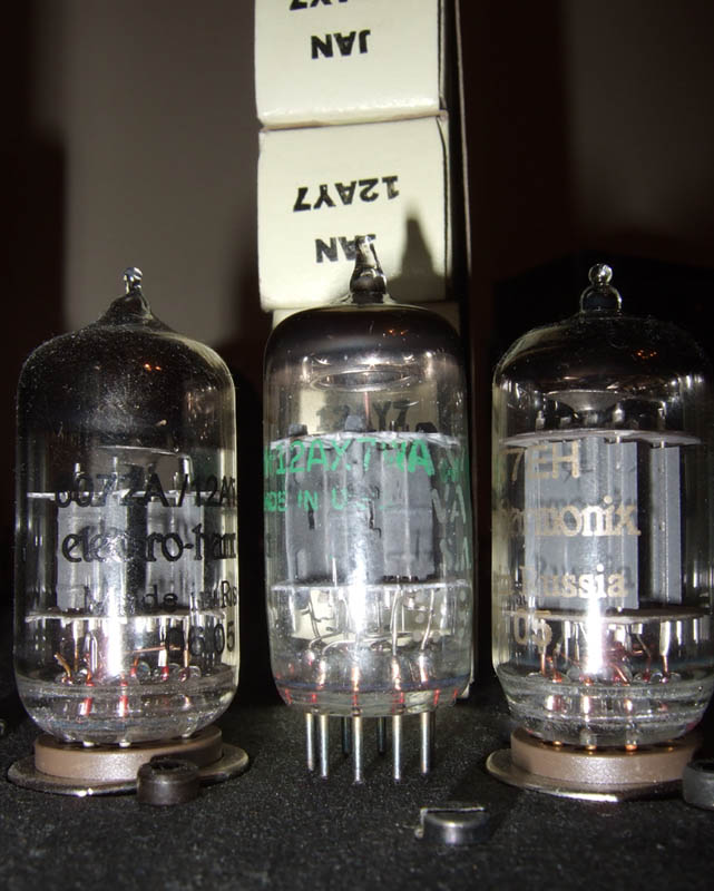

Thank you for the post. I was beginning to think I lost my mind. I plugged in this 12AY7 EH tube, it sounded fantastic, I shared what I heard on a couple forums - and...
NOTHING! No response of any kind. Which amazed me.
I really appreciate your opinion on this, thanks again.
Oh, for those who haven't seen it, it looks nothing like any other EH tube. The plate looks similar to an old GE or Sylvania, it's a single vertical rib.

Jim McShane said:
Salas,
I have the GE, sounds great but a bit glared compared to the correct tonality of the EH.
Yes only us took notice, and another guy in Japan. Named Kondo.
Jim McShane said:Oh, for those who haven't seen it, it looks nothing like any other EH tube. The plate looks similar to an old GE or Sylvania, it's a single vertical rib.

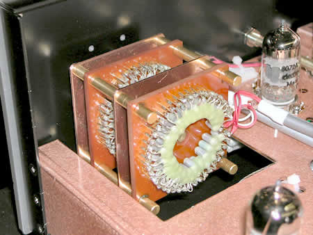

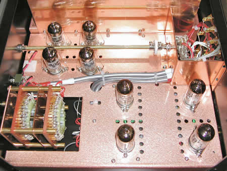

Here it is on my amp. Next to it, the GE 12AX7 of similar plate construction to the GE 12AY7. The GE 12AY7's plate is shorter than the AX7's with 4 rectangular holes on the wings. There is an EH 12AT7 in the company plus a box of GE JAN 12AY7's. Obviously the EH follows the GE heritage.
P.S the pics above come from Kondo 77 preamp.
