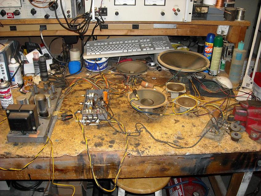

Refusing to give up I did some more testing.
I found the 'good' transformer had primary dc resistance of 189 and 204 ohms. The 'bad' channel transformer had primary dc resistance of 198 and 305 ohms. It is a pp amp.
This discrepancy is why I figured I had a bad transformer.

I wired in one Edcor and got 8.8W out before clipping. No distortion on the S and F as before. This is with no GNFB attached. The Edcor transformers offer UL operation as well so I might try that.
I'll patch them in and leave the originals in the chassis till I decide what to do.

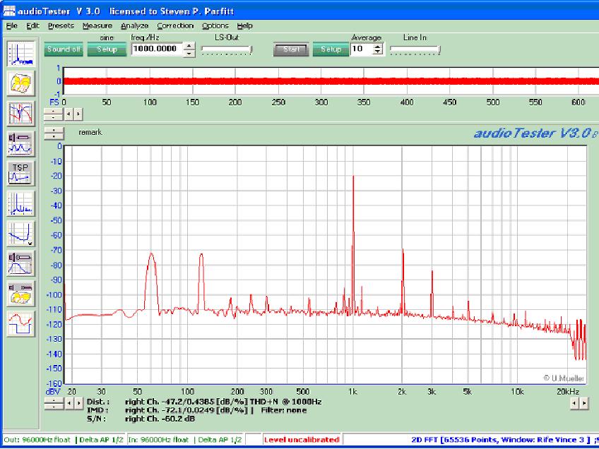

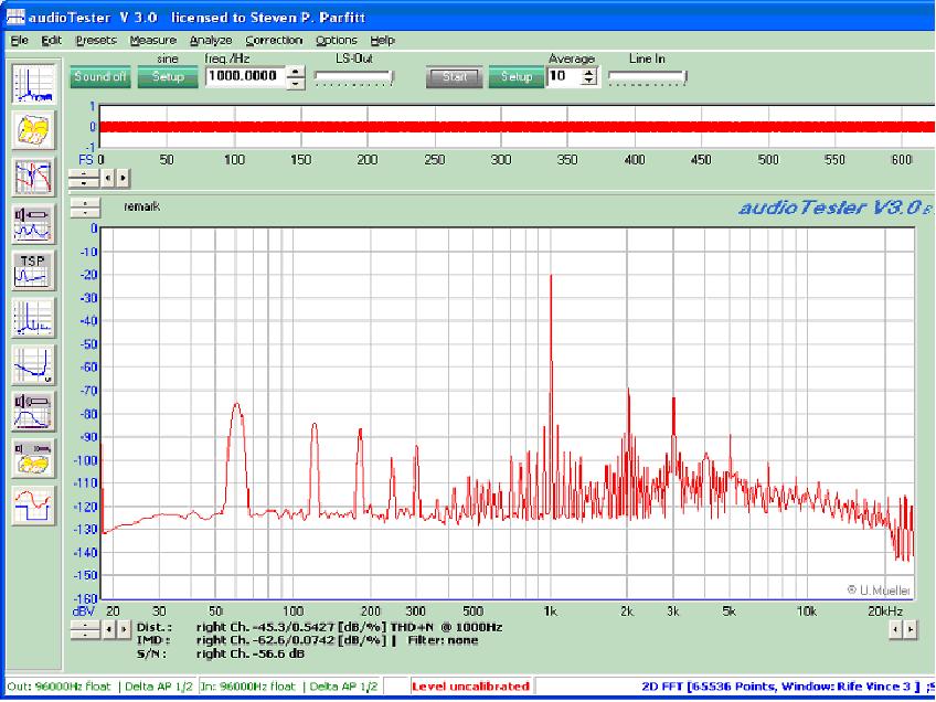

I replaced the 'good' transformer with an Edcor transformer and took a frequency response plot, and THD plots. Edcor has greater output.
When taking the THD plots I adjusted the input with the AudioTester to give the same 1KHz amplitude, and kept the volume control on the amp turned all the way up. Original transformer is second plot, Edcor third plot.
I guess next I'll replace the other transformer and see if that channel changes or not.

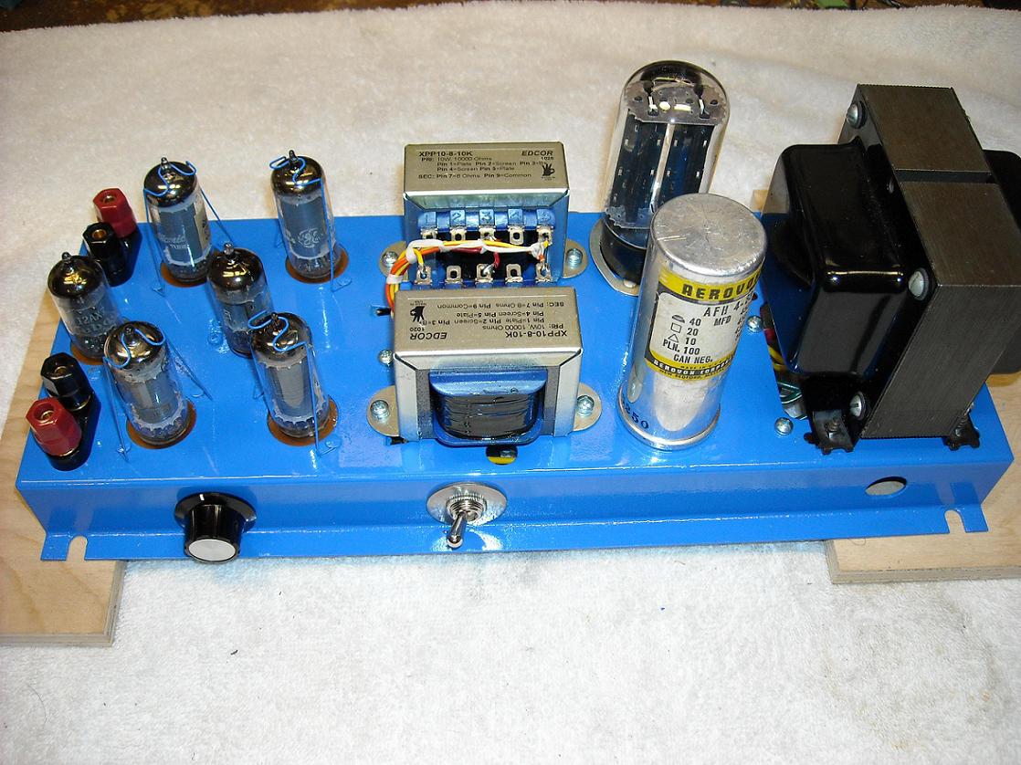

Project Phoenix

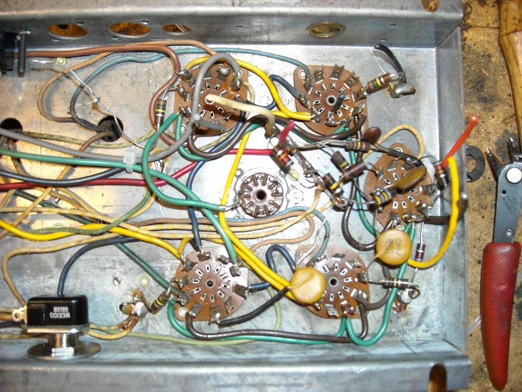

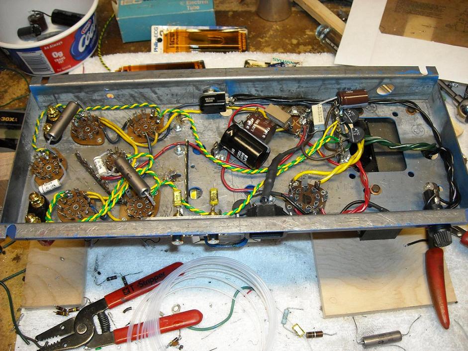

I stripped it down and started rebuilding it. TRWs are Polyester and need to be replaced but I'll have to order something to replace them with.

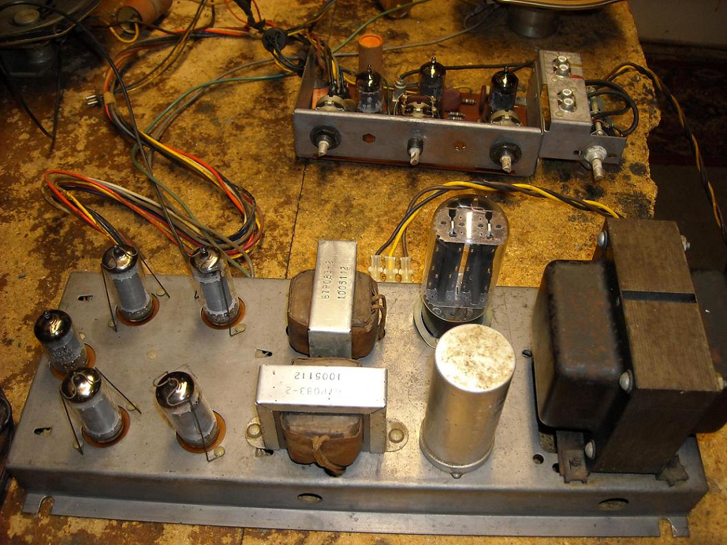

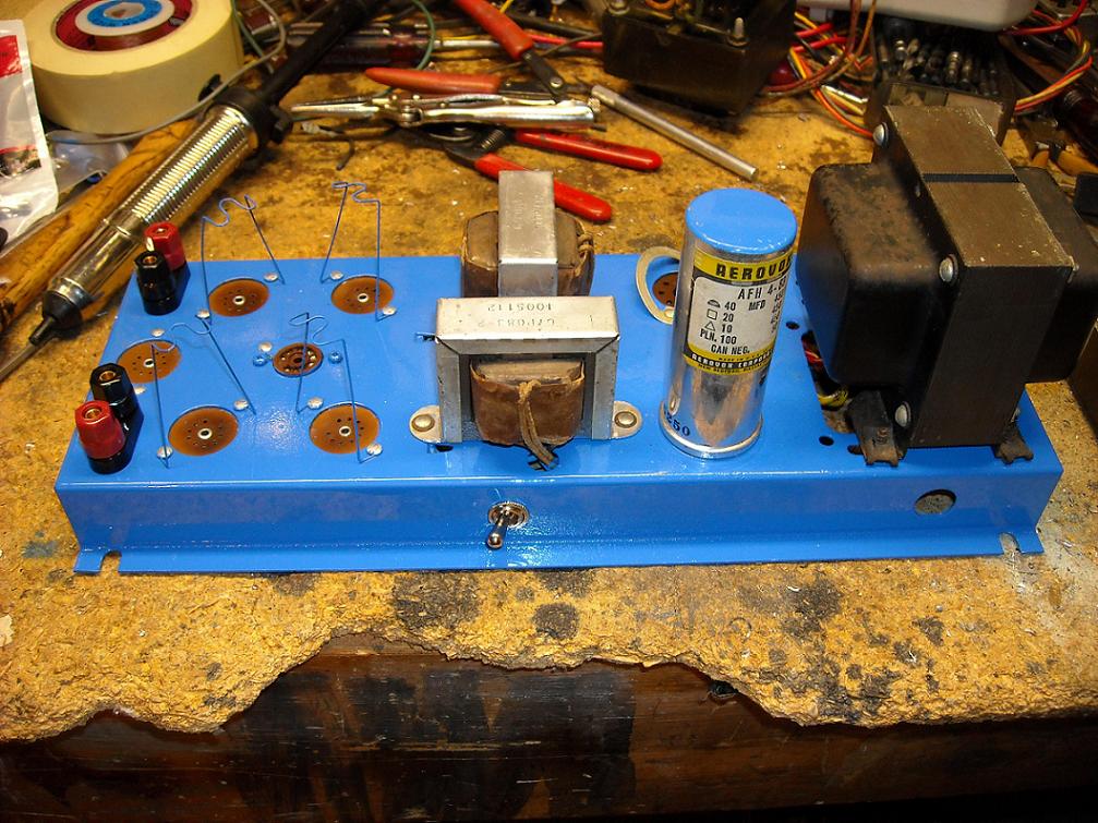

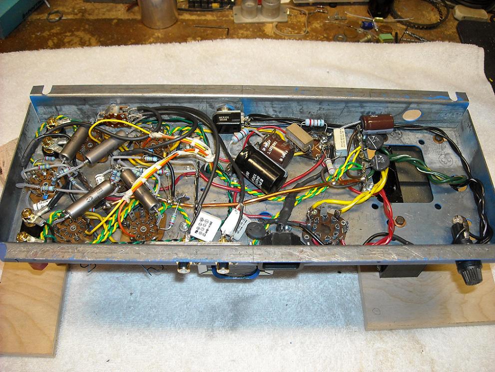

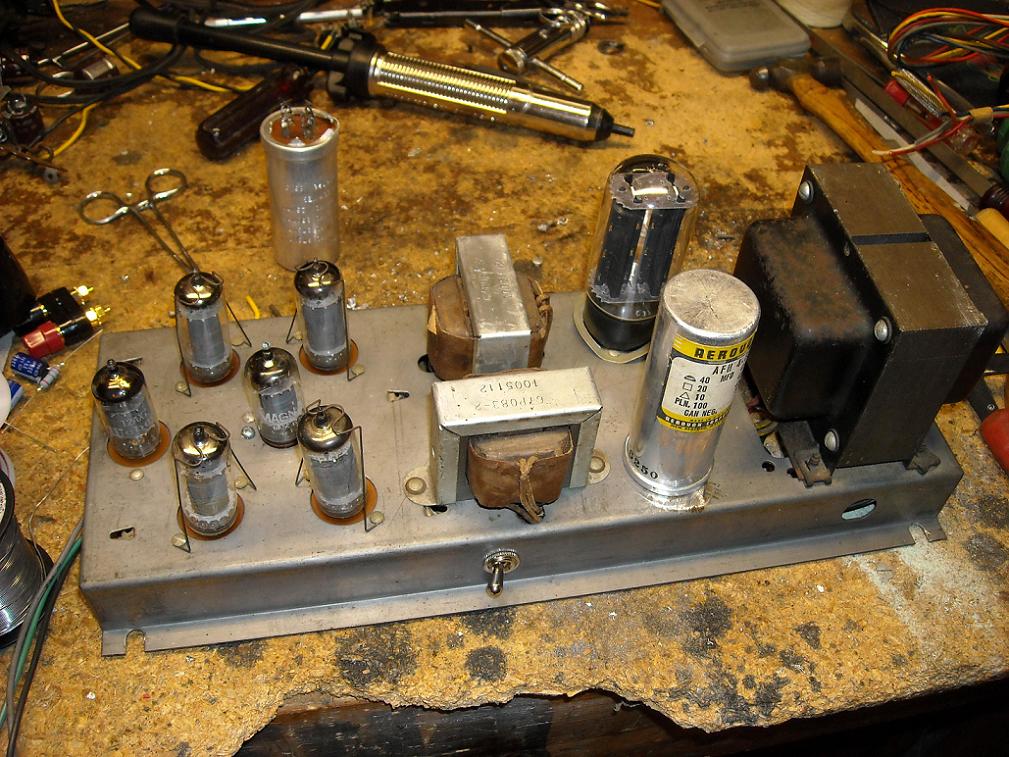

First photo when I first got it running. Second is progress to date. New Filter caps, additional RC stage in B+ filter, twisted heater wiring with NTC resistors and start of adding coupling caps.
I thought about replacing the sockets, but the holes are too large for the replacement ones I have. Then again if I replaced the sockets I'd probably switch output tubes as well.
At least the tubes are reasonably cheap.
Finished wiring it tonight.
275V k-a at 32.6mA=8.98W total dissipation per tube, so the plates are running way below max. I may try cranking it up a tad by changing some ps resistors after I run it a while and take some readings.
I've got GNFB but no UL running right now. I may experiment with some Schade if I can figure it out for a PP amp without ITs.
Right now I've got Stevie Ray Vaughan cranking with 'Couldn't Stand the Weather'.
Sounds really nice, better than I expected with the budget Edcore's.

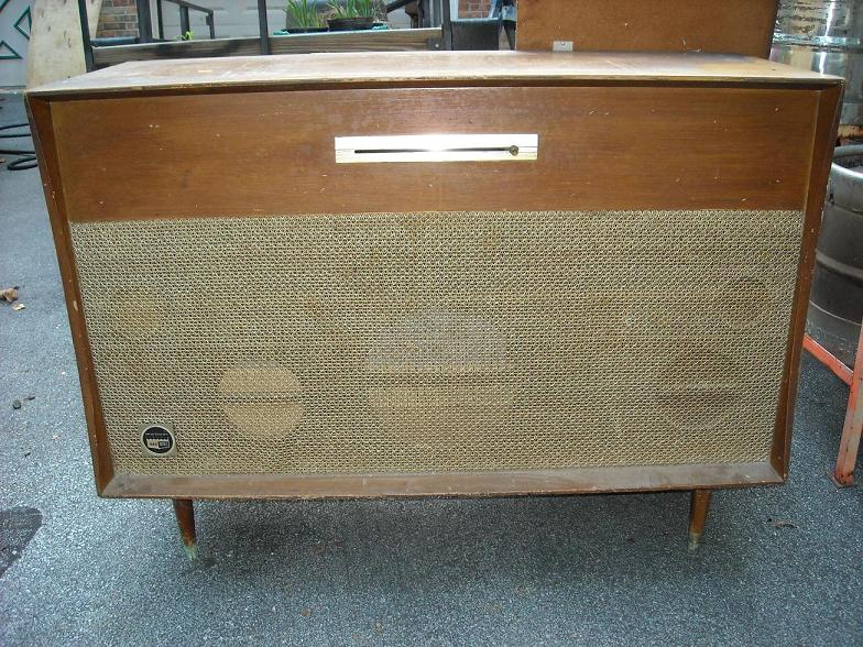

The "Tree Streets" so named after trees are part of the old town and a historical district. As such they are limited to yard sales once a year, and most houses have a sale on that day. I don't get the paper so I wasn't aware it was today until I drove by around 2pm and saw a sign. I called the wife and said "lets go".
I missed a Sears Console Stereo for $40, but found this for $30.
Webcor 801068-16. Probably 8WPC. 12BA5s in pp with rather small opts. Active tone controls on a separate PCB.
Nice that the all important schematic is included. Interesting of note is the separate feedback winding in the OPTs.
Too bad it does not have an FM stereo tuner in it.
It will need new caps before powering it up, but it looks like it has been kept high and dry although quite dusty inside.
