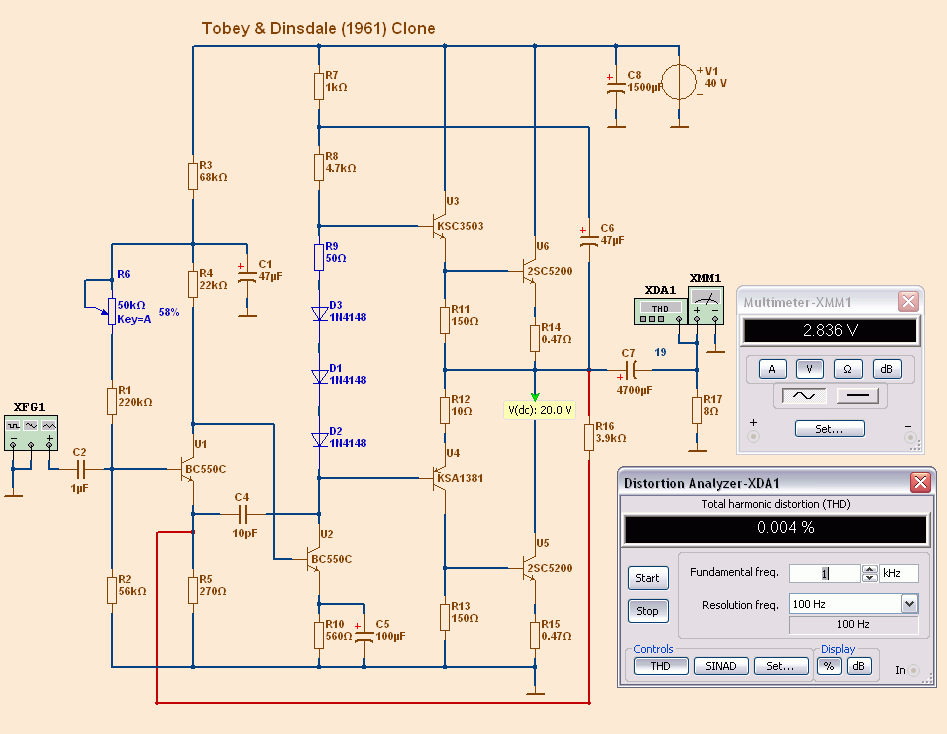

I am working in SPICE to make a clone of the old Tobey & Dinsdale.
I think it is possible even if the original uses Germanium, I think.
I post schematic here when I get it to work..
I made my clone of Tobey & Dinsdale.
Closed Loop Gain was decreased to ~15.
Amp was compensated with 1000pF. But my cloone need only 10pF.
Amp shows rather low dist at 1 Watt 8 Ohm.
Was a nice exercise to try modernize this old antique design.

I do not suppose that you have any spice models of the old germanium devices
I have often thought that a lot of modern amplifier improvement is due to better devices rather than improved design
I have built many silicon Tobey Dinsdales with good results I am a bit old fashioned and still prefer the inherent safety in capacitor coupled designs
