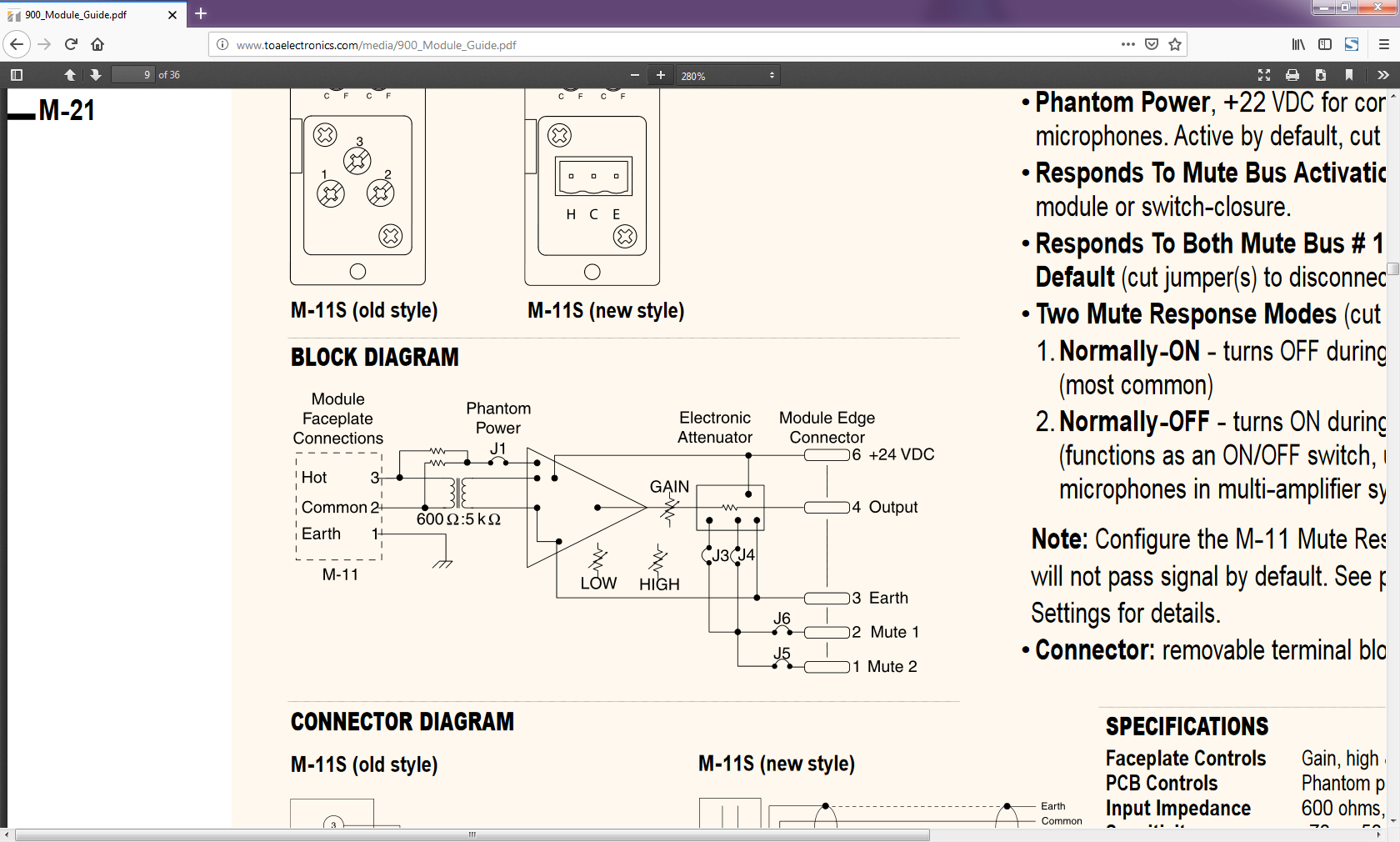

Looks like you need a 24v PSU possibly to get it running. If I'm thinking of the same modules they fit in a metal box that has a PCB bus board on the back. On mine the power supply and ins/outs are labelled on the PCB.
There are about 6 modules in the box. Inside each module is a pretty bog standard preamp, EG an OP amp fed from an IP tfmr. I think the opamp's run off 15v, so the 24v is dropped with resistors.
So to use them outside of TOA amp you need a decent PSU, I used a wall wart regulated supply, then either put the box in a bigger box and connect the OP's to 1/4" sockets or just solder 1/4" or whatever cables direct to the PCB.

With a single +24 supply, I doubt they drop it to 15. They leave it at +24 and ground the negative side of the IC, then set a 12v reference. Running op amps on a single supply is nothing new.
TOA would probably send you the actual schematics of whatever uses them, including the modules themselves.

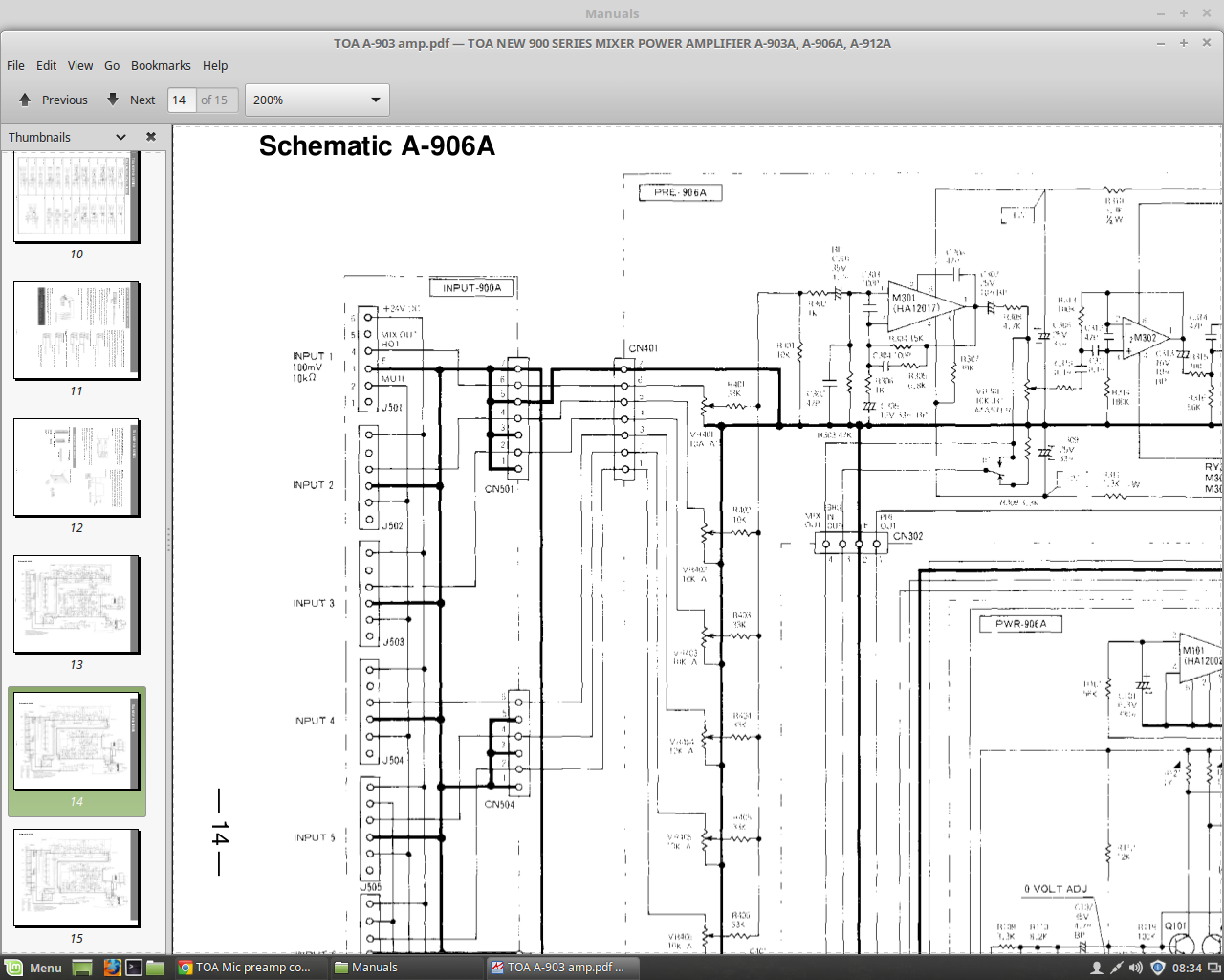

"With a single +24 supply, I doubt they drop it to 15" Probably right, my memory might be playing me false; in the 906A preamp they do use big droppers and simple zener "regulation". The TOA website has lot's of schematics and manual's, I got mine there. As you see the module connections are pretty simple.

The M11 is a microphone input module if my memory is correct. An L denotes line level. I'm sure there is info that TOA has.
