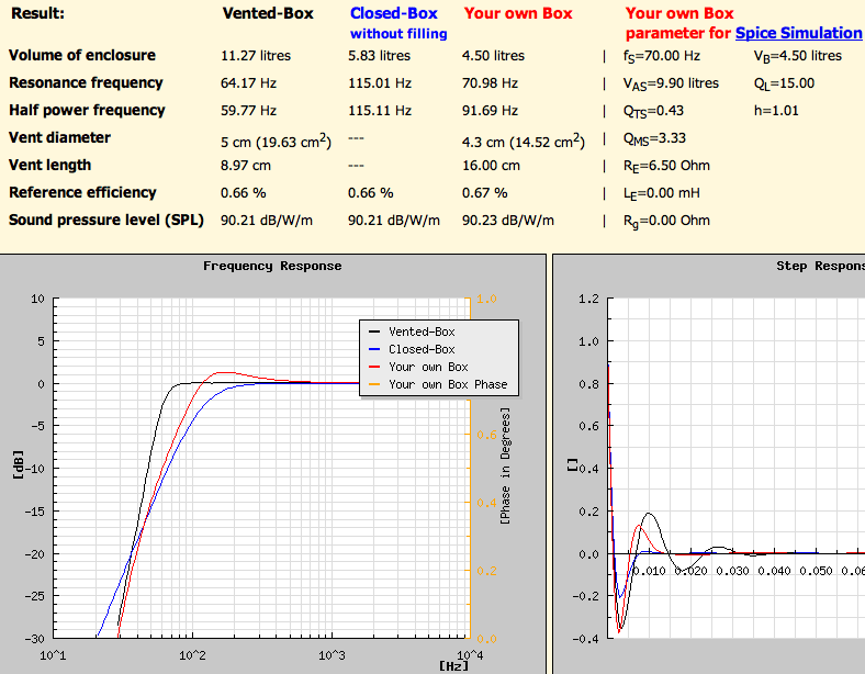

Couldn't resist playing with the calculations. I also found something helpful at :http://micka.de/org/en/index.php#ideal
I extracted the dimensions from published data for the planet10 Fonken and mFonken which use the same drivers I have. Looking at the Fonken, with Vb=13L, port length of roughly 26cm and an effective port equiv. diameter of 7.8cm I find that the frequency response looks very close indeed to the recommended vented box frequency response for this driver using the calculator on that web site I just quoted. This makes sense, confirming that the Fonken is set up like a BR.
Then I used the data for the mFonken, Vb=4.5L, port length roughly 16cm and a port equivalent area of roughly 4.3cm. I tried varying the port dimensions to convince myself that this was the optimal in terms of flatness of response and I think it is. So again, a nicely designed box set up like a BR.
However, with the smaller box of the mFonken there are limitations and the frequency response doesn't offer a 3dB point much lower than a sealed box. I'm not convinced that the venting of this box provides much benefit in real life. I haven't read much about what people think of the sound from the mFonken. It looks a very tight box with this driver. I do read many good things about the Fonken, but with that design, the box volume really allows this thing to perform.
Here's a plot showing my attempt at modelling the mFonken (and what I learn is that for small HT system I may not want to vent after all, or if I do then the box volume should be made large enough - which I think I have space to accommodate)

Gareth - just for kicks, you could build a pair of the mFonkens* ( a far simpler build than the Prime), and report back on how what you hear in the real world relates to what the modeling shows in cyberspace.
You could find it's not exactly "set up like a(n average) BR". Is there any software capable of modeling with the type of highly dynamic and spectrally complex signals that we actually listen to?
* if you do, please note that the driver bracing is important, and the box is small enough that lining with damping material is probably easier if you install the back panel last.
As for not reading much about what people think of the sound from the mFonken, certainly as compared to the "Prime" - that's likely as there have been few, if any, of the small ones yet built (other than our own the 3 or 4 pairs), while at last count there are probably over a dozen pairs of the Fonkens by DIYers. Why not be the first report your impressions on the little guys?

FWIW, some rough calcs on net enclosure volumes are approx:
Fonken Prime / GR Fonken & Floorstander- approx 13 litres
mFonken ("milli") 4.5 litres
so the 127 can definitely work in a range of volumes with appropriate tuning.
