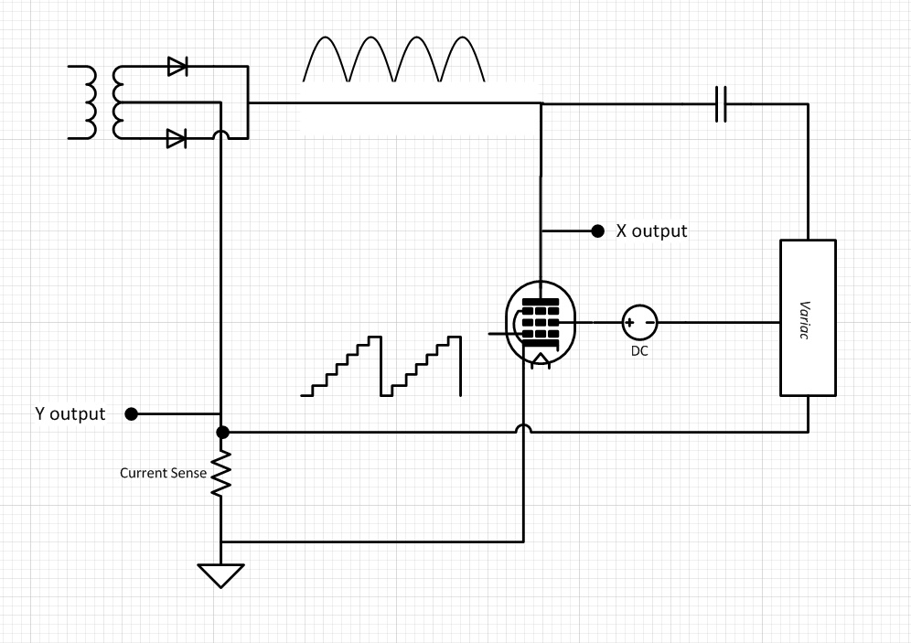

The way I am trying to plot the curves is with a fixed DC Screen voltage representing what the Quiescent screen voltage would be under operating conditions. In this case the plate will go below the Screen voltage the same way the curves are traced for the Pentode mode at a fixed Screen voltage.
I tried something different today. It works but I probably need a better non electrolytic capacitor for better operation. It must withstand the large plate voltage swing and block the DC coming up from the plate. I used a small 120V variac.

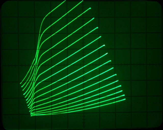

The additional screen current definitely affects the way the traces look, specially at lower plate voltages. This is a 6L6GC at 250V DC screen voltage.
Variac to Pentode Side
Variac around 40%
Variac on Triode Side
Variac on Triode side with Screen Voltage supply off. Same volts/div for x and y as previous ones.

Your Variac technique looks good. Certainly getting decent curves.

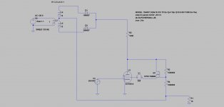

Mosfet version:
The current sense resistor in your diagram is placed so that it automatically sums plate plus screen current correctly, so the addition of a Mosfet follower simply needs to avoid polluting the current thru that sense resistor. The plate V resistive divider can be placed just like the Variac to the top of the sense R. The Mosfet drain would be pulled up by a CCS to a B+ or something staying above the plate V.
A cap from the Mosfet drain to plate, to transfer the screen current over, may be optional in your tracer setup, since it is already looking at cathode current where both are summed. If the cap is put in, then you need the CCS pull-up on the drain (to avoid variable drain load resistor current added to the plate current). If not connected though (the cap), then I think you can just use a load resistor to B+ for the Mosfet ( then the B+ supply neg. returns to the top of the sense R, so screen current goes thru it).
[ so either AC screen current either goes across the cap and back around thru the tracer supply ,and thru the current sense R; or for the no cap variant, DC current just goes thru the separate B+ supply and back around thru the current sense R. The second uncoupled variant captures the total AC + DC screen current in the current sense R, and is easier to do and more useful for the tracer purposes. The cap coupled/CCS version is more useful if you want to make a UL trioded device for an amplifier.]
A pull-down resistor on the Mosfet source ( which is connected to the screen) may be optional. If it is used, it's current draw must avoid polluting the current sense R for the tracer. So it would go to the top of the sense R, like the divider.
The Mosfet gate gets a cap from the R divider, and a high value R to a screen DC bias supply.
In any case, you just need to follow the current loop around for any support devices, to avoid polluting the tracer's current sense R.

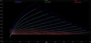

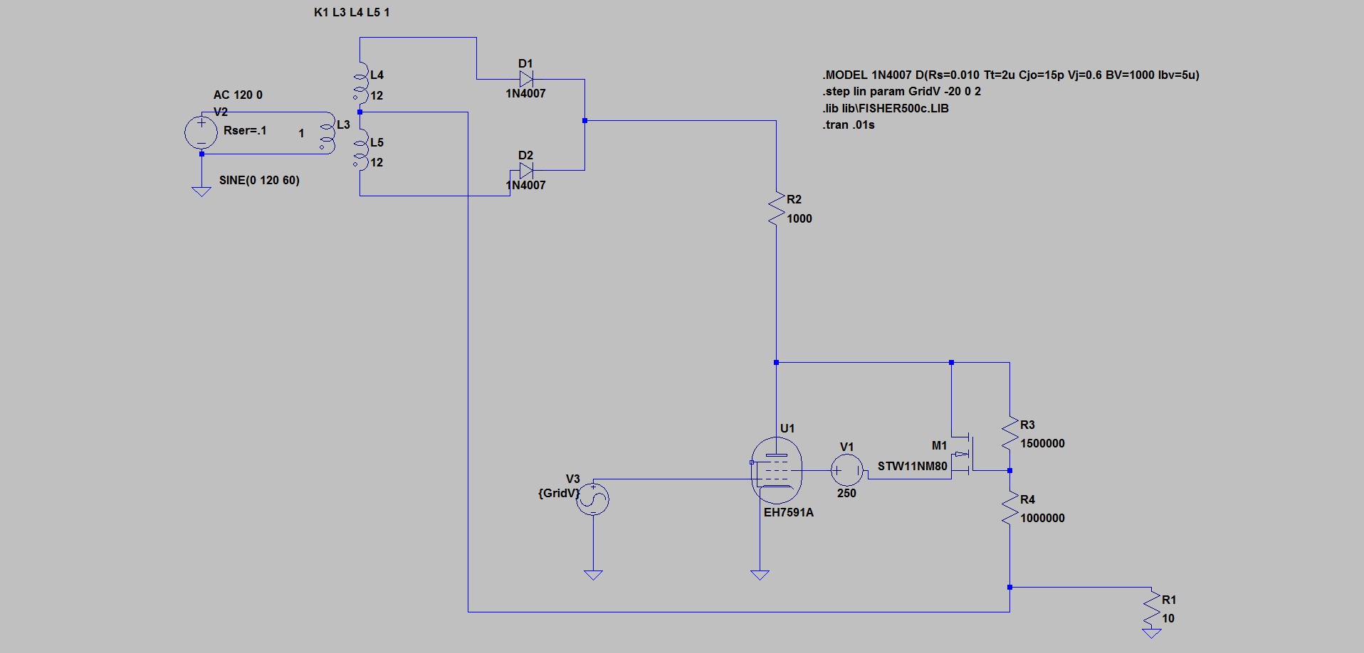

I did some simulations in LTSPICE IV. I followed what you said but I think the easiest one is the one I have attached as it does not require additional B+ supply to keep the Drain above the gate voltage. Although the plate voltage is varying it will always be a tad higher than the gate as the gate voltage is the output of the divider and going all the way to triode is invalid as it will yield a boosted triode with much higher G2 than the plate. Also, even-though the Screen supply is in series with the mosfet source, the current stills goes via the drain to the sense resistor via the transformer centertap.
Do you think this will work in circuit?

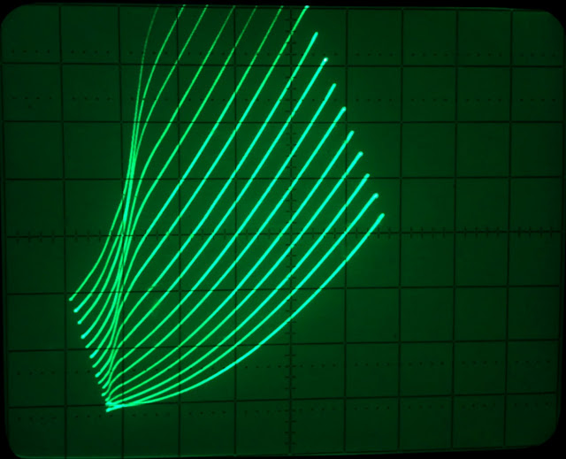

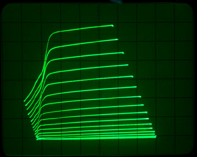

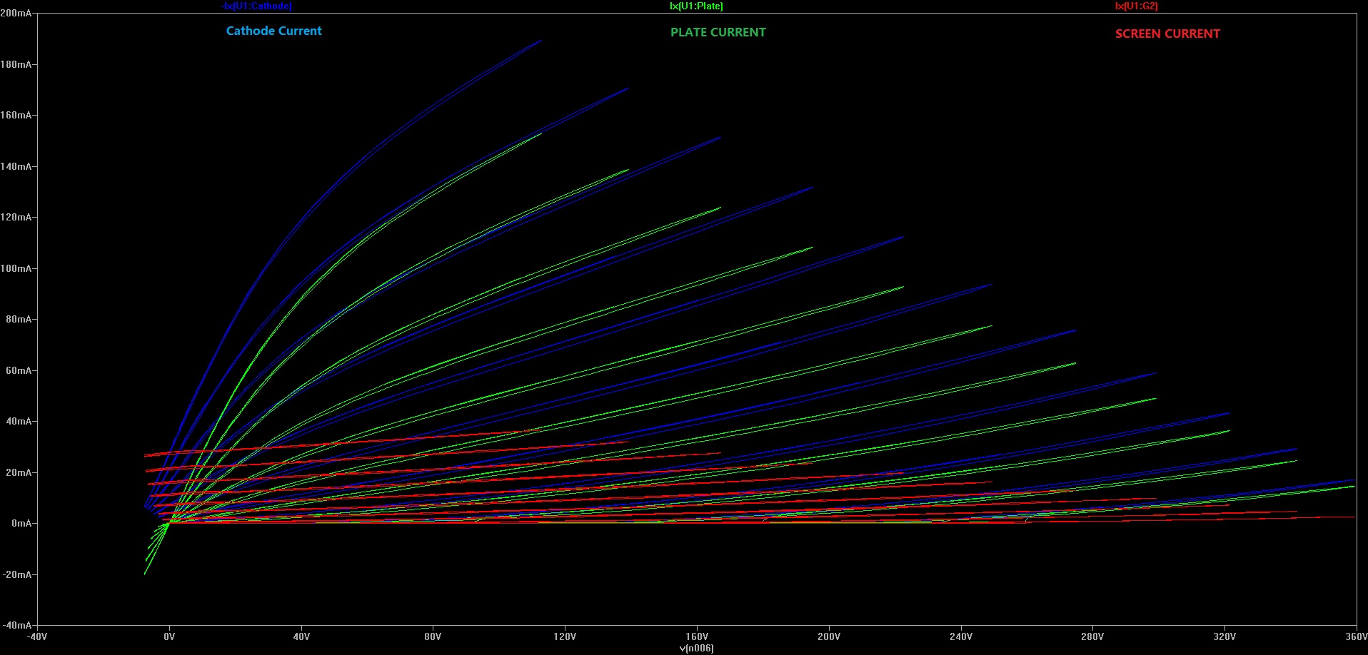

I went to the shop (garage) and hooked it up.
Works really well:D Very clean traces this time. I had a 900V enhanced N Mosfet laying around. I think I am going to wire it in a box permanently so I can use it easily as an attachment to the curve tracer. It should also work for local parallel feedback testing. The cool thing would be if I could get it to readout the percentage on the dividing network.

Very nice solution, I like the simplicity the floating screen supply allows!
And the curves look great! I will add this to my tracer too.
Next addition to consider for the tracer is a way to drive both the g1 and g2 grids with the step generator using g2/g1 Mu scaling. The g2 needs higher voltage steps than usually available (HV amplifier may be called for), plus some current drive capability. The g1 steps get divided down by g2/g1 Mu so that both grids do the same amount of work in controlling the plate current. g1 can work in either the enhancement mode like g2 (ie, positive) or it can use the usual negative bias range. (so DC biasing adjustments for each grid is called for tracing or use)
For a typical TV Sweep tube with internal Mu of 4, this boils down to g2 operating at twice the usual grid1 swing, and g1 operating at 1/2 the usual g1 swing. (so g2/g1 steps 4X)
Your curves clearly reveal the continuity of triode to pentode as a varying Mu triode.

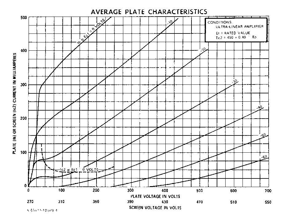

I had been going over what I have done with my curve tracing setup and realized that since I do not have the voltage swing that the transformer provides that I need to create it myself to emulate the transformer.
On the drawing, the fixed UL DC voltage (V1) must be properly selected depending on target B+ and UL%.
V1 = (B+) - (B+) x UL% to set the lower limit of the Screen Volts when the Plate voltage is to reach 0 Volts on the plate drive signal.
In the 6550 example below, using a B+ of 450 and a 40% tap I would need to setup my tracer V1 to:
V1 = (450V) - (450Vx40%) = 450V - 180V = 270V
If my rectified Plate drive in my curve tracer is set to max at 700V, then the aggregate screen voltage will go from 270V(0v plate) to 550V(270 + 700x40%), reflecting the same screen voltage swing as in the 6550 example below.
