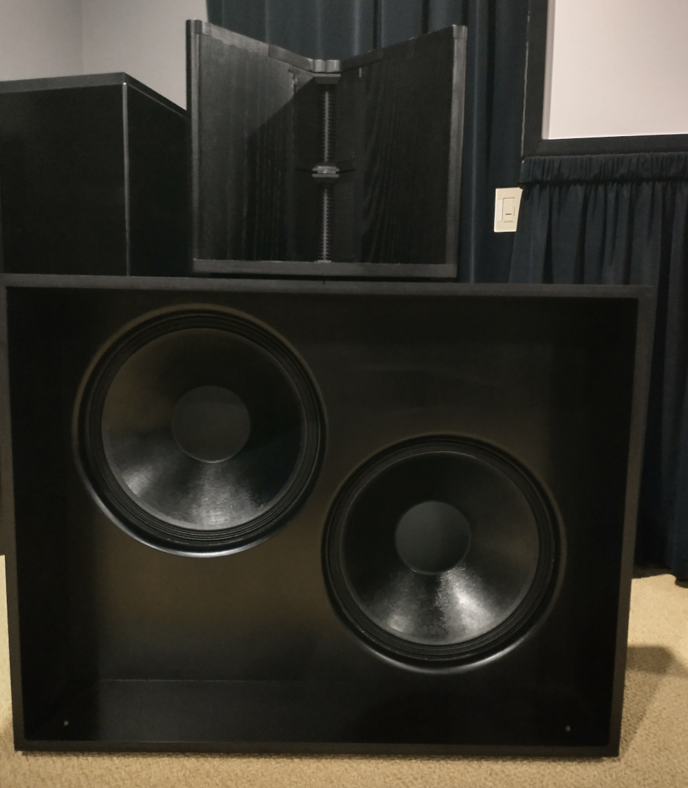

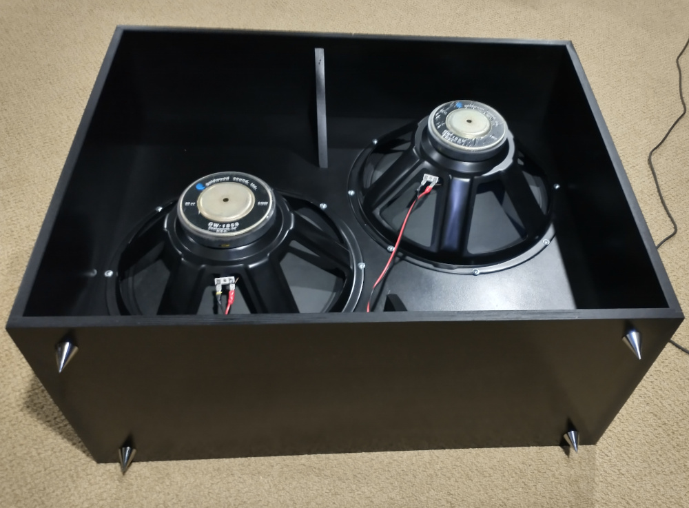

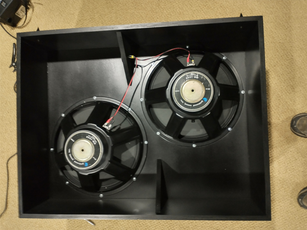

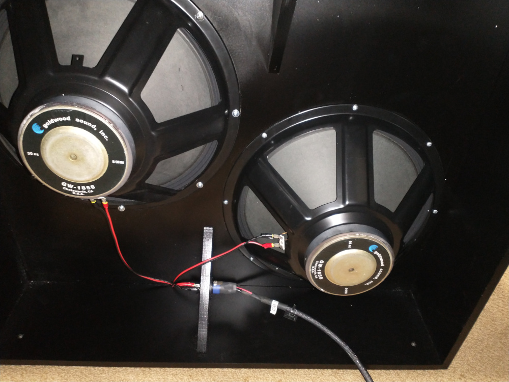

Dual Goldwood H frame
I realize this is an old thread, but I recently built a dual Goldwood 18" H frame based on the paper done by MJ King. I used his basic H frame design, but enlarged the baffle to accommodate two 18" Goldwoods. I have extremely efficient HF and needed to try to get the most out of a limited Xmax woofer in an open baffle configuration.
The bass I have been able to achieve using the Goldwoods is exceptional. In the past, I have built many OB designs but always with less than optimum OB drivers. After much research on the subject, I figured I'd try the Goldwoods. At their price point, I really couldn't go wrong.
For home audio listening, in a space that gives you at least 3' from the front wall, these H frames work very well. However, an actively controlled system is needed to flatten the SPL produced by the Goldwoods.
