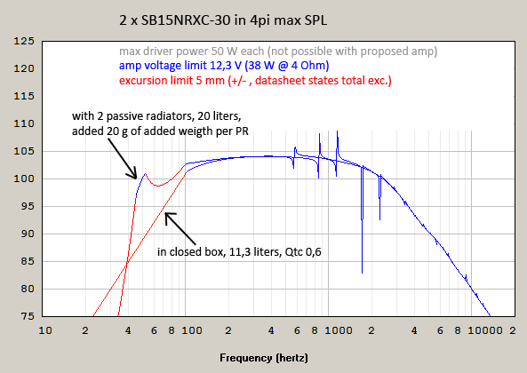

just as a rough example I did a maximum SPL simulation in hornresp with the drivers in closed box and with PRs.
each simulation uses two drivers in parallel, which for this simulation is the same as using parallel amps+drivers.
box volumes are totals for both drivers.
the PR tuning to ~ 50 Hz is just a first shot, will need further optimization.
the blue lines indicate maximum SPL is amplifier output voltage limited (using 38 W @4 Ohm = 12,3 V max)
the red lines indicate maximum SPL is excursion limited (obviously independent from eventual equalization).
the graph with more output between 40 and 200 Hz is of course the PR version.
max SPL in the excursion limited area for closed box will not change with box volume change, thus I just took arbitrary Qtc = 0,6
tuning the PR box lower will increase lower bass output while decreasing upper bass output. this may be sensible, using some bass eqalizing if needed.
second graph is the group delay. apologies for the strange graphics, i had to hugely adjust the y-axis to match!
as to be expected the PR resonator creates big group delays at the resonance.
again - it might be sensible to tune the PR lower to get the group delay peak out of useful frequency range.
(peaks and dips in the upper frequency range of both graphs are enclosure resonances).
