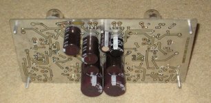

PCB's have advantages and disadvantages, anything created proper will work, not done right will just not perform as desired. I prefer PCB with wide traces and wide spaces. You must watch component location and adjacent traces for cross feed, capacitance coupling. I keep heater supplies off of the PCB and use twisted pair, must be over 1/2" off of the PCB.
I also like maximum ground plane with stitching to keep any ground plane current from developing a potential that could result in feedback / ground loops. This PCB was designed to fit on an 8.5x11 sheet to allow for toner transfer PCB fabrication.
You can make amps as quiet as a church mouse until you crank them up!
This PCB is a prototype suggested by KEGGER. It can use 6P3S Russian 6L6 tubes all the way to KT88's etc... I played with different tubes and component values to look for sensitivity and flexability. After months of different combinations, GNFB, no GNFB, UL, Triode, PIO, metalized poly, etc... I preferred 6550's Triode connected with older Hammond 6.6k 40 watt iron@ 450VB+
It was a very pleasant amp with low end authority at 350V B+ with the 6P3S tubes which would have been the lowest cost version.

Roline, you have some of the best toner transfer results I have seen.
Some info about your setup would be good too - printer, paper,
toner, laminator (or whatever you use to transfer), number
of passes and so on would be very helpful.
I had mixed results till recently. I just realized that the clothes iron I have
at its max setting was too hot and I got better results at
a lower temperature.

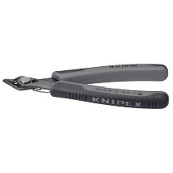

NO ! I heard this so many times. When you use standard pliers you will always put some force on the joint while cutting it. This is a fact not some story. That is why special pliers are made for electronics by Knipex etc. Standard pliers have an angle in which they cut and while cutting they will pull the wire up which is force in my book. I use special Knipex cutters and the angle they cut has been optimized for putting the least stress on the joint as possible but still...
If it is not the pliers it will be your hands putting some force on the wire/joint when cutting. This can easily be avoided by doing it the other way around which costs nothing in terms of money or time. Just think different and try it out. Joints also look better when they're cut first and the surface that was cut will be tinned too which leaves not a chance for corrosion of the otherwise bare copper. Only this should be reason enough for "cutting first".

It is quite possible I used the wrong words in english to name a tool as english is not the language I use everyday. I meant these of course:
In military stuff the rule is : "first cut then solder"....
I think this is advertising propaganda originated by Knipex or some other tool manufacturer, or more likely an old wives tale (not uncommon in the military).
