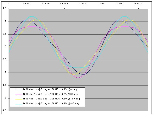

traderbam said:What should the phase margin be? Why does it matter whether an amps response is totally stable or not? Provided the voltage gain is relatively flat to 20kHz does it matter that it, say, doubles at 200kHz? So what if a square-wave has an HF ringing on it? You won't hear it!
There are indirect reasons why phase margin and compensators may cause audible effects. Figure out what these are and you can make better choices.
That is a good question, what should be pahse margin be? I guess it would depend on your load. If running a purely resistive load, you could probably get away with a few degrees. However if you start adding any complex loads, things may change. I would say phase margin needed would depend on the load impedance. If your speakers don't cause the amp to oscillate, then you're fine. However, if you don't know what the impedance will be, you may be better to err on the side of caution.

What if the gain is flat to 20Khz and the phase shift was around 180 degrees? Would that affect the sound of the amplifier?
I believe that a bigger factor to sound quality is the phase shift verses frequency, not amplitude vs frequency. Think of an instrument, and shift each of the harmonics. Will the sound still be the same? My guess is no. The pressure waves that will hit your ear will not the same as from an amplifier that has no phase shift.
For example, I have inclosed an image, which shows four traces with identical spectral amplitudes. Each trace has the same fundimental frequency with a second 'harmonic' frequency of 20% of the fundimental frequency, differing only by phase shift. Could the human ear detect the difference? Maybe, maybe not, I have not done any audio testing of these waveforms yet. The point is, that phase shift changing with frequency can affect a complex waveforms amplitude vs. time trace.
-Dan
