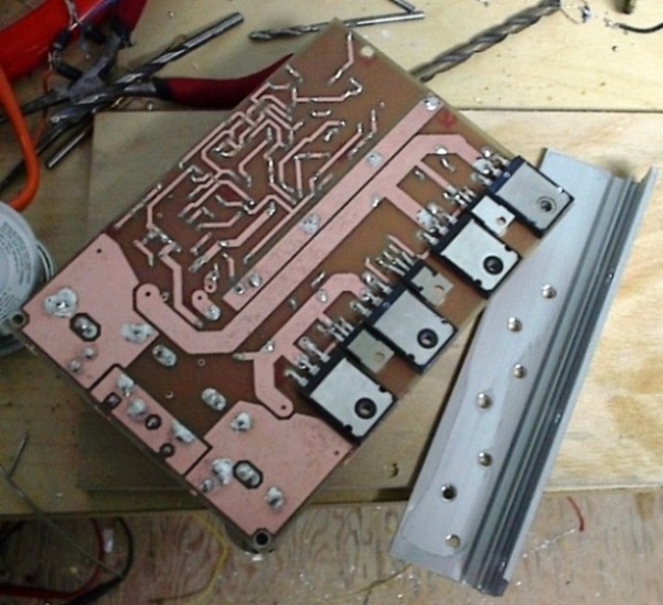

Yes. You can have it within hours, rather than dats (or weeks). It doesn't look as pretty, but works just as well and is cheaper once you have the hang of it.

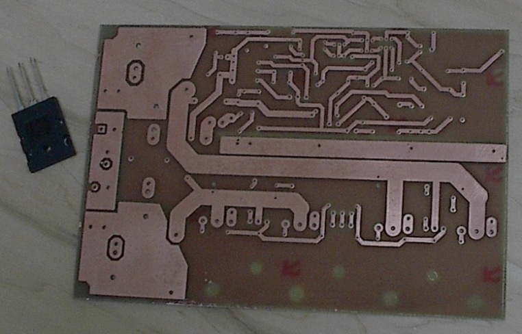

I did this one with Tom Gootee's method:

Judging from the email I get, thousands of people are using the toner transfer method that I have described, here:
http://www.fullnet.com/~tomg/gooteepc.htm
If you can't get exactly the same type of paper, you might want to try some pages from a glossy magazine. It shouldn't matter if they have magazine ink on them (except for possibly impairing your ability to inspect them, or to align them for 2-sided boards). [I, myself, have not tried using magazine paper, but have gotten many emails from others who have successfully used it, with that procedure.]
Please note that I described the method in excruciating detail for a very good reason (AND to cut down on email questions about it 🙂. It should be done exactly as described, at least until you are getting perfect results and are experienced-enough to try your own modifications. (You would be amazed at how many emails I have gotten from first-timers who have blithely ignored, or completely changed, certain steps in the procedure, who then email me to ask why it wasn't perfect, or even once-in-a-while to actually complain!)
Regarding drilling:
I use solid carbide bits with 1/8-inch shanks. I buy the used 'repointed' ones, for about $20 for a box of 50 (last time was on ebay, I think). I use a Dremel-like rotary tool, clamped onto a cheap little drillpress (with a piece of scrap metal and some large U-bolts), from which I removed the original motor, etc. I usually only break bits when I hit them with my hand, or something.
I think that the key to making it work, without breaking the bits, was attaching two springs, between the drillpress's 'post' (the part that doesn't move) and the part that carries the rotary tool, so that it is held under tension, which removes most of the horizontal 'play', from the moving part of the drillpress mechanism.
I used to use the high-speed steel ('wire gauge') bits. But they get too dull way too quickly, for me; within 100 to 300 holes, even with a slower drill. I run my tool at 30,000 RPM and can sometimes drill several thousand holes with one .032-inch carbide bit, before I accidentally break it (usually by bumping against it with something, while the drill is off).
P.S. For the 'hardcore' PCB-makers among you, there is a ton of good stuff about it in the message archive of the Homebrew_PCBs discussion group, at http://www.yahoogroups.com . For toner transfer, there are descriptions of how to modify small laminating machines to automate the transfer process. There are even detailed descriptions of how to modify certain inkjet printers so you can print the PCB pattern *directly* onto copperclad pcboards!
Nowadays, for production runs, I usually just go to http://www.4pcb.com . If nothing else, at least try their on-line FreeDFM utility.
