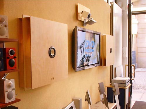

You will degrade the value of your real estate investment by installing loudspeakers in that manner; instead, design and build a thin depth, wall mount enclosure(s) to house your drivers. Example follows:
6moons audioreviews: Cornu Compact Spiral
WHG
You will degrade the value of your real estate investment by installing loudspeakers in that manner; instead, design and build a thin depth, wall mount enclosure(s) to house your drivers. Example follows:...
Where the heck is that? Some kind of demo room? Are those little computer speakers?
I mentioned building shallow enclosures, but the reaction was "I'll NEVER get around to that." And while the point about real estate is true, in this case there will be a good several decades in this house-no desire to move at all-so it's not really a big problem.
I'll look up those speakers, if painted piano black they could look good with a black TV...

Ya know, I looked at this again. I was originally gonna say "no way will something like that happen here."
However you're inspiring me to think outside the BOX ha ha.
That picture does not look too attractive as-is, no offense meant. BUT if the TV was on a kind of shelf/mantel (actually hung to the studs, but seeming to rest on a shelf), the shelf/mantel could be a nice excuse to place shallow boxes up on top, which could be build sturdily.
The only thing is, depth would probably be even more of a problem than in-wall, given how shallow TVs are getting...
