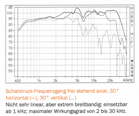

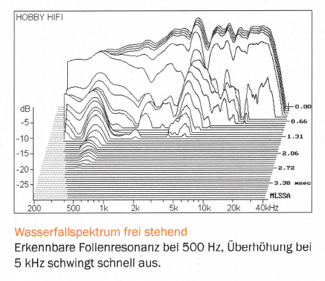

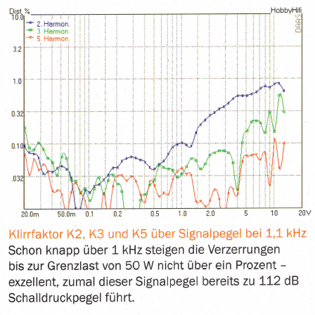

HEIL AIR-MOTION TRANSFORMER (AMT)
-a good driver for dsp (to improve linearity).
The original "I" (..though note that production quality isn't terribly consistent):

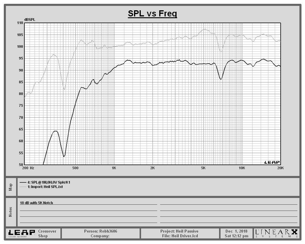

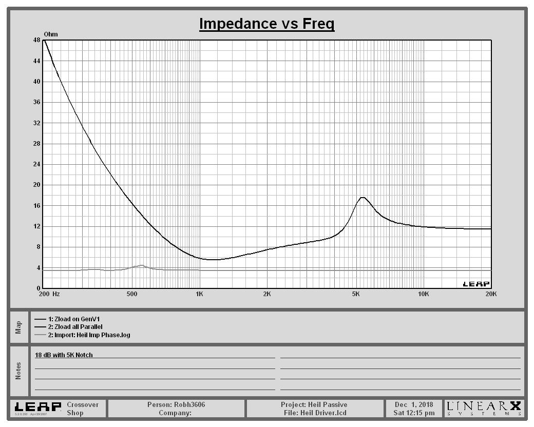

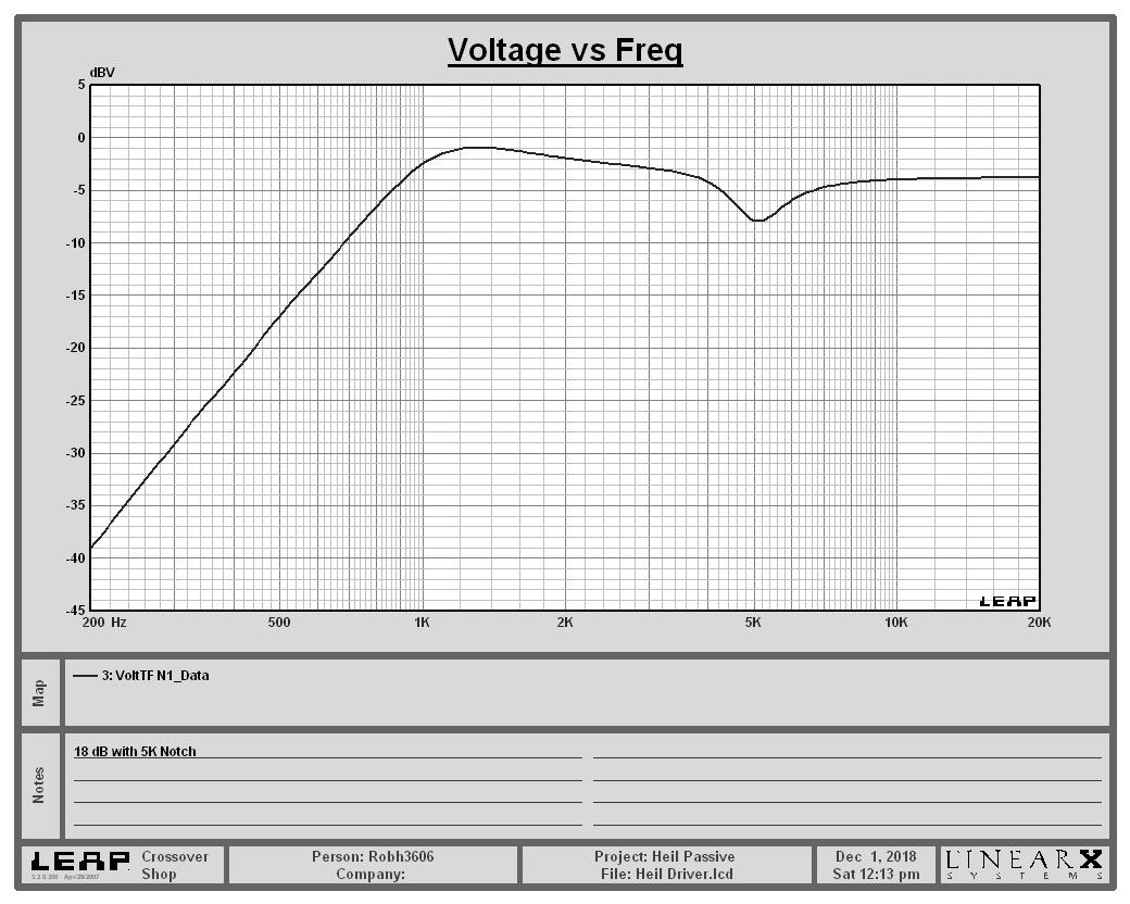

There is a post over at the Lansing Forum concerning the Heil with a 12 inch JBl driver. The crossover shown appears to be at about 1200 hz. I am interested as I have some old JBL 123a woofers and may try the woofer high pass out of the JBL S 70 AlphaIII. The FS of the Heil is about 500...so I think an 800 crossover is “pushing it” a bit but somewhere on the net there is a schematic for the Ess Heil Special Edition speaker dated 2013...I do not have any measuring equipment or design experience so I will just follow along.
"There is a post over at the Lansing Forum concerning the Heil with a 12 inch JBl driver."

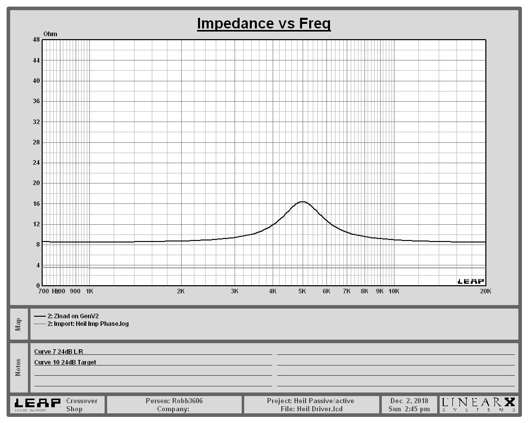

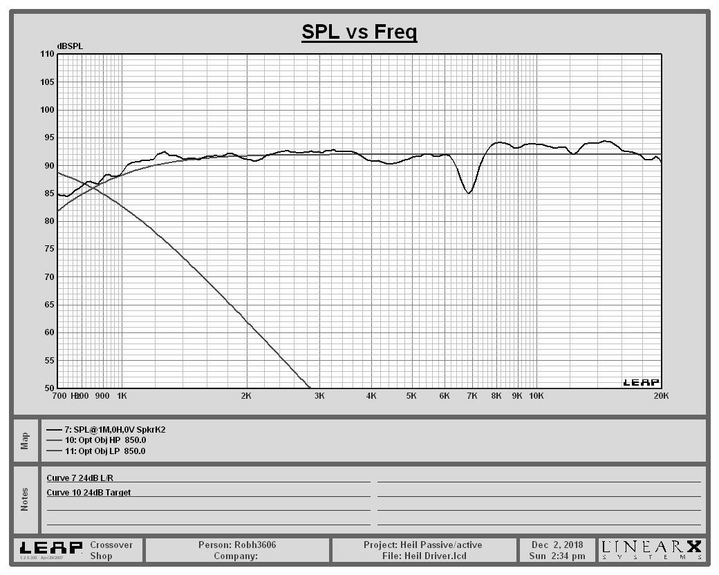

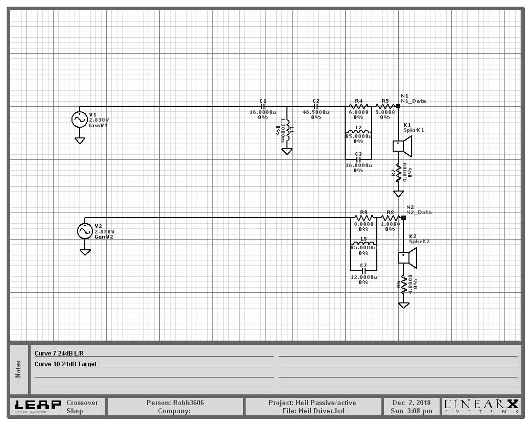

Hello
I am the op on that thread and ESS used an 18db network with the original driver with an 800Hz crossover point. To build your speaker you are going to need driver measurements from your designed listening point with the drivers in the actual enclosure you plan on using so basically you bass driver in it's box with the Heil on top as an example. If you go passive you are going to need a notch filter to help smooth out the 5K peak and pay particular attention to the impedance. As an example here is an 18db network with a notch and an active 24db network with a notch.
Rob🙂
