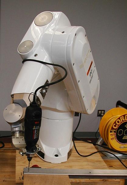

I've read it suggested that if you do make your own boards and have to drill your own holes, and you do it quite often, it might be wise to invest in a small drill press.
I use a dremel drill press with a lithium-ion cordless dremel. Mine is actually a Craftsman model #53169, but it's identical to the dremel version.
