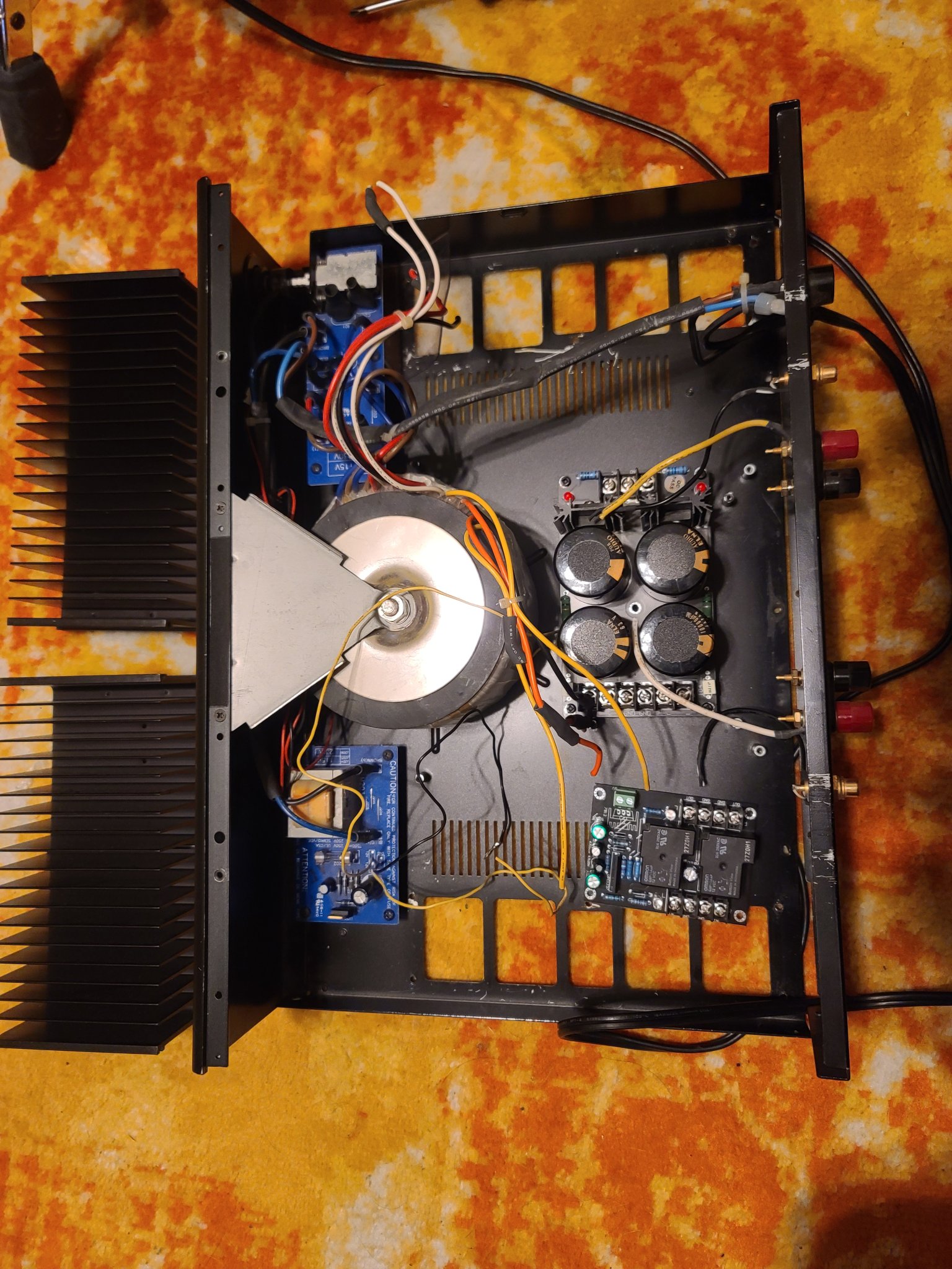

I'm using this chassis from a blown out gfa 5400 i got on Craigslist for $40 to build Shaan's PeeCeeBee V4H. I'll probably replace the 2 pronged plug with a 3 pronged receptacle and then add the parallel resistor-capacitor-bridge ground loop breaker to it.
For the first time I just noticed that this chassis creates a loop around the transformer. Isn't that a bad idea?
I just remembered I’ve seen this before as a technique to secure a heavy transformer, but the trick is to make sure the loop is not electrically conductive. So you have to use an insulating bush and washer. If you do, it’s perfectly safe.

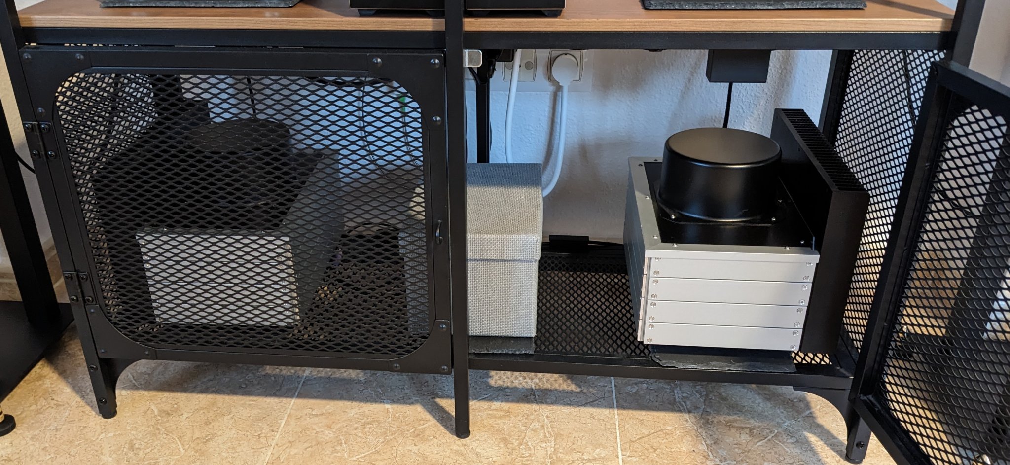

I have had a floating chassis on homebrew power amps for some decades without any problems.
I assume that the most important thing with having a floating chassis is to have a solid and tidy build with little or no chance for any wires to come loose and touch the chassis.
If something should happen to the amps circuitry the amps mains fuse should handle that. So having a mains fuse in your amp that is not too big but very close to what is needed is also important.
For me the most interesting approach for an alternative solution is what Briz mentioned in the last post
In other areas, you may find a similar circuit where any current through the 10R resistor is detected and used to trigger a breaker.
Say for the live mains wire (or neutral as well), a circuit with a mosfet switch that is triggered by any current through a 10R resistor connected between amp ground and chassis and thereby cutting mains to the amplifier if any faults occur. This circuit could also act like a mains power switch for the amp. Anyone up for a challenge? 🤔
Anyway , my mono blocks have a bit of double insulation as they are living in a cage 😉
