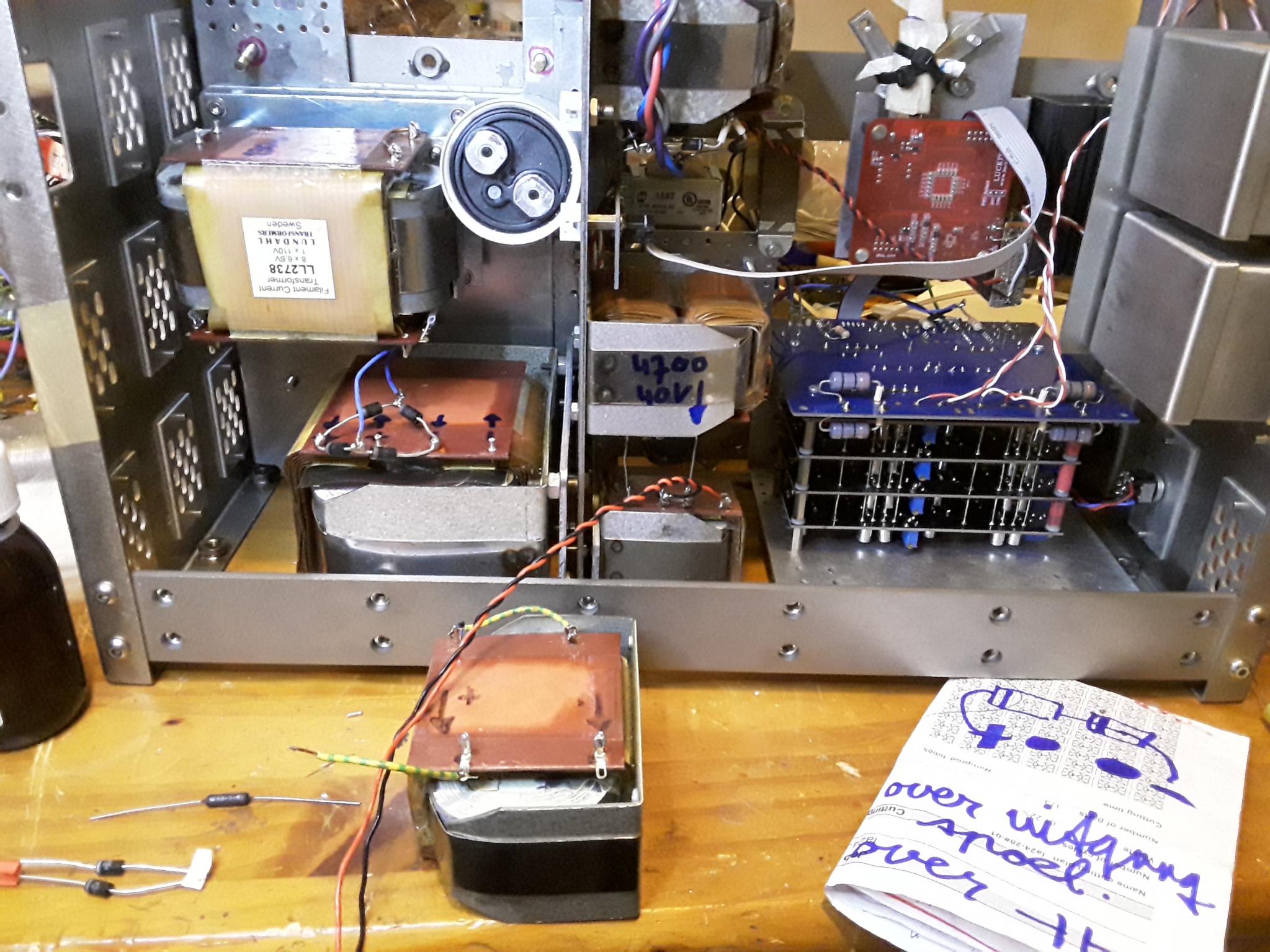

I also think Lundahl chokes are very nice . A big reason for me that they have lots of choice because they offer several models that can be bought with different airgaps. And now you can even ask for a different airgap with a certain model. They have like a stock of coils and during assembly they will adjust the airgap as you desire.
I have read that amorphous cores are easier to saturate. So some could taker less AC.
What is the sonical character that makes you switch to them?
In a LCLC supply with one amorphous choke which one gives the most benefits , the input choke or the other one? I find generally that the influence of the input choke is bigger.
Greetings, eduard
p.s in the attachment the old and the new input choke in my DDDAC. Just going up in Henry and weight

You are asking some pertinent questions. Cost me dearly to get these answers 🙂
I cannot really recommend the Lundahl amorphous chokes. They give you just a glimpse into what is possible but at the expense of bass and an oddly squashed sounding midrange. And yes, they are too small for using as input chokes. I was unfortunate to buy them before this admission appeared into the datasheet.
What i use is an input wound on AMCC400 followed by a differentially connected Lundahl in the second stage. Best of both worlds to my ears.
