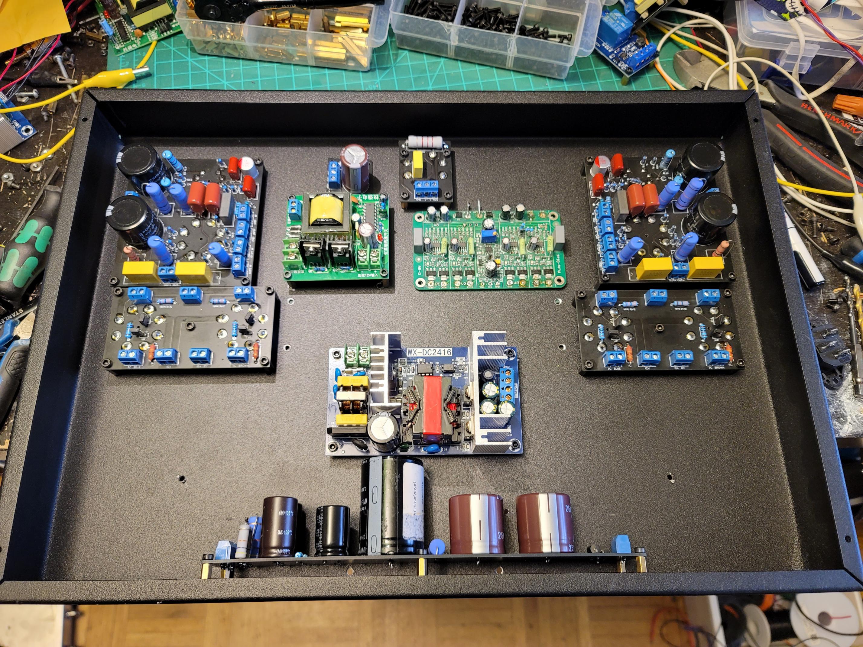

If you're willing to go in an unconventional route, I have a modular amp design that might fit the bill.
I made PCBs for line, buffer, VA/PI, Driver, VA/PI/Driver in one, 4 different output boards that work with over 30 tube types, RIAA, 6E2 meter etc.
My idea is to make it easy to customize for a certain purpose.
Using a pair of sweep tubes in triode mode per channel, you can make between 15W to 80W depending on the tubes and OPTs - all using an easy power supply (made boards for that, too).
It uses off the shelf toroidal power transformers (2 per channel) as the OPTs and therefore the entire build shouldn't cost more than about 1500 US, less if you try. I made the 15W version for my dad. Total cost was about 250$. I also built a version in a cake pan for myself as an experiment for 100$. Very cheap by tube standards but the performance is great.

EDIT: Added a pic of some of the boards in a build I'm working on. The three most central boards are not my design.

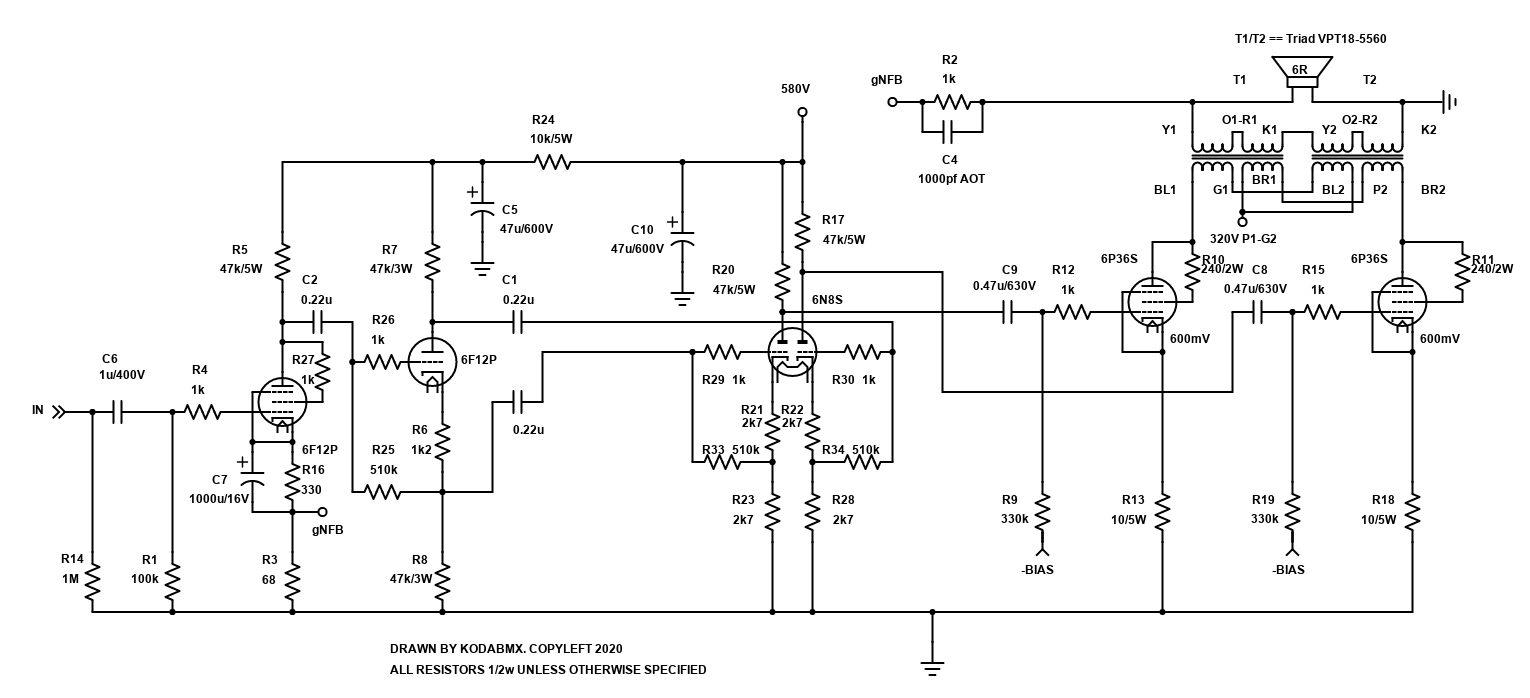

Kodabmx - very interesting indeed - what, if any, would you say are the compromises in your design? Do you ultimately retain a SET topology or some sort of hybrid?
Definitely a tempting idea hmm
The topology is as in this schematic. It's push pull. The values are from an older revision, and I don't recommend this exact recipe anymore, but the topology is sound. R7 and R8 should be 33k, R6 should be 240. Also, I bias the 6P36S in this schematic at 80mA instead of 60mA now. The 10R resistors are specced to be 5W incase of a shorted tube. A bad tube shouldn't take out the rest of the circuitry IMHO.
