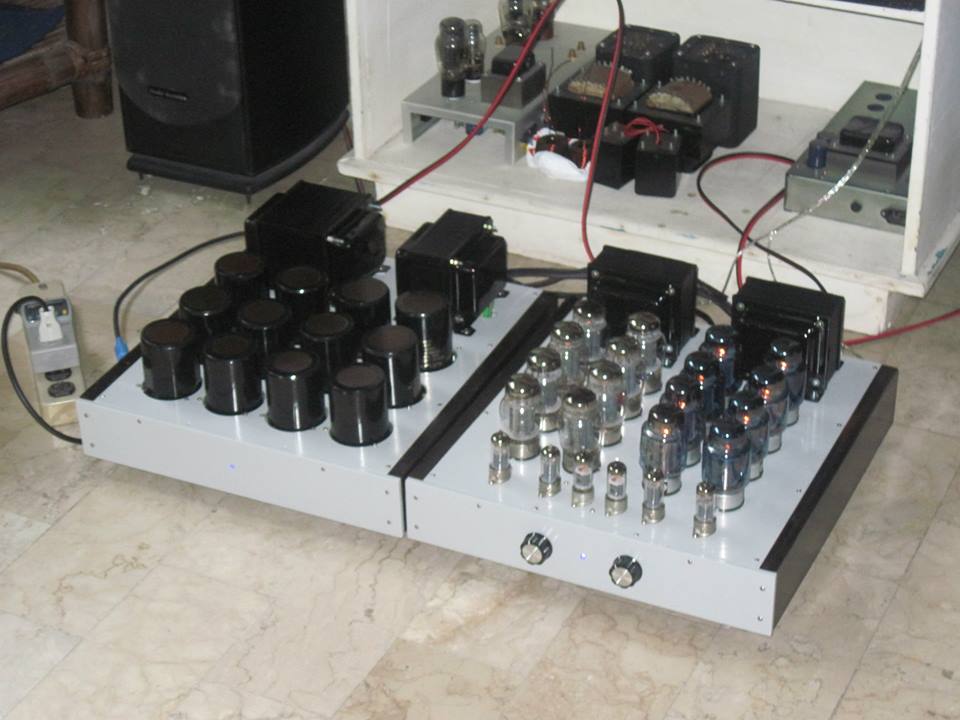

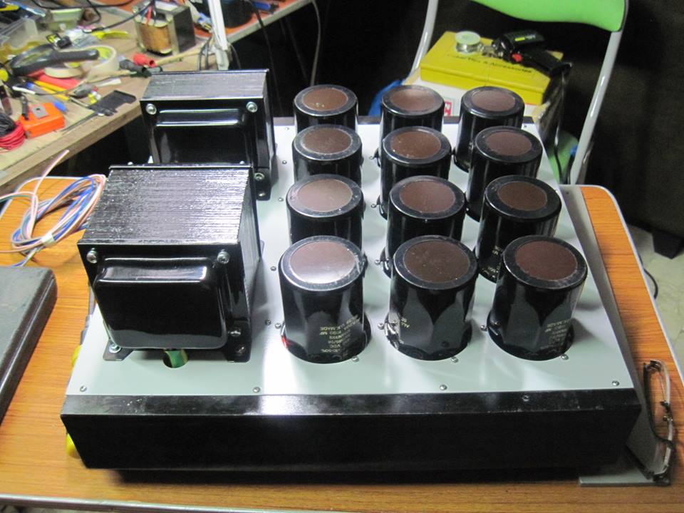

i did a push pull 16 kt88 amp and i used 1kv, 16Amp flatpack bridge rectifier,
the amp still lives today....
