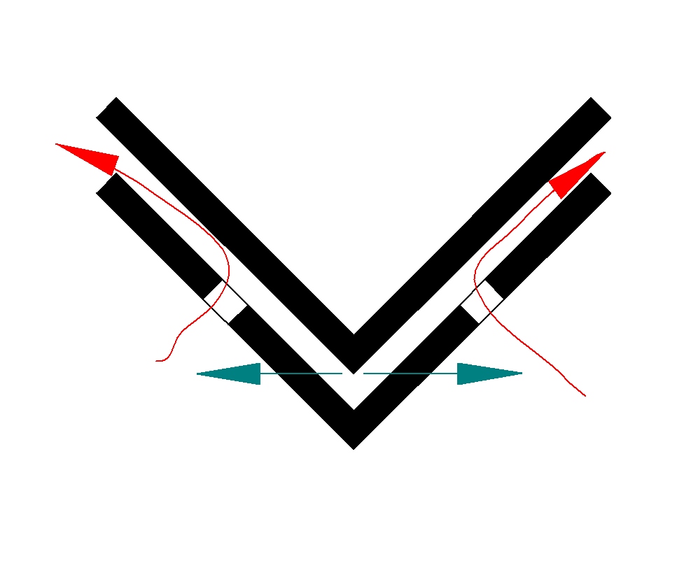

I have been running my Ladegaard for about a year now and although it works well I am convinced things could be better than they are.
(you can see my current version here: one and two ).
Last night I tried to find out where improvements could be found and I think I have at least identified one problem. It turns out that the aircushion between base and slider is not at all uniform from top to bottom. The results is that the bottom of slider is able to move backward and forward quite a bit (see pic below).
I want to ask other users to check their arms to see if they have this problem as well.
I have been thinking about a possible solution and I can see two options that might work:
1. Drill the holes in the base in two rows instead of one (the second row will have to be a lot further down)
2. Drill the holes in one row but much further down.
I think option nr. 1 has the biggest chance to work
Reactions Please!

My only observation that relates to this is that you are better off if you can have a higher pressure and a heavier slider - you will get a "harder" air cushion and the result is a better sound. My experience is that I have been using aquarium pumps with a marginal pressure and this is less than ideal - a compressor or a compressed air source like a pressure tank would be better. Then you can pile on a litttle more weight and the sound tightens up a little.

Peter,
I would stick with the existing holes arrangement around centerline. It seems to me, the slider is more stable both statically and dynamically this way. The static air pressure under the slider within the area below the holes is maximum and equal, assuming the air flow at the slider ends is negligible. Above the holes, the pressure starts to drop towards (air is flowing from high to low pressure area). So, if you place two rows of holes, the air will tend to flow through the upper row (lower backpressure), thus increasing the total air flow and associated hiss and induced vibrations also. Placing the holes in the bottom part only may lead to dynamic instability, when the slider starts to rock due to variable stylus friction forces on loud passages.
As for making the Ladegaard better, methinks it shall be treated essentially like the Schreder arm, namely addressing the stylus induced vibrations by the armwand and counterweight proper damping, because both arms are decoupled from the armboard (no rigid mechanical bearing here). The most noticeable improvement I got was due to double damped armwand and more rigid hedshell and arm-to-slider connection.

I've always wondered how to minimize the stiffness of the air tube to acceptable levels when supplying the air to the slider. I've seen applications (including the Kuzma linear arm), so I guess it can be made to work, but I would think you could never make it as flexible as the wires.
A possible way of making the bearing more rigid would be to change the slider to be four sided (a square tube) and put another, inverted 'base' above it (creating two opposed air bearings). This might require a change to the vertical bearing. The lower bearing would need to be supplied higher pressure to the degree required to lift the arm. The advantage would be that you could increase the pressure(s) to create a more rigid bearing while not increasing the air gap or having to increase the weight (beyond the increase caused by the square tube slider, of course). In effect, the upper bearing would load the lower.
This idea occurred to me several years ago, but I never implemented it. I ended up building an arm similar to the ET2 instead. But, I still think it's worth consideration.

make it shorter
I belive the "air supplied to the slider" design has an important advantage for Ladegaard arm: you may substantially rise the air pressure, or in other words, bearing stiffness, by simply shortening the slider. If you make it, say 90 mm instead of current 180, you shall double the pressure, to keep the same lift force (equivalent to the weight) and air gap. (I would stay with the current angle width, for not to affect rotational stability). In the same time you may reduce the total air flow, because there are no open holes, which are just bleeding most of the pressured air and producing disturbing hiss. It means you may stay with existing pump.

Airgap width
In my quest to try and improve upon my Ladegaard I want to try and make a more traditional air bearing, one that is not just pressurized from below but all around and with the air fed to the slider (something like the Kuzma ).
I know very little about pneumatics but I need to find out what the airgap should have to be in a design like that. I have Googled around but haven’t found what I was looking for. Are there any simple rules to follow? All knowledge is appreciated.
