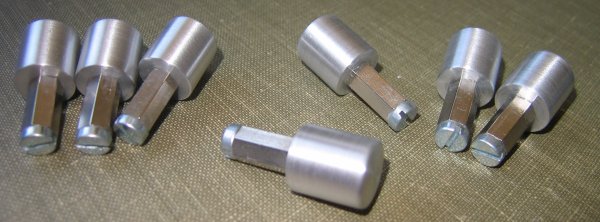

Checking the Franco-phony forum is entertaining, just picture watching is good inspiration by itself.
Like for example this one, some guy named Francois made these boutons when he still had access to a machine shop.
