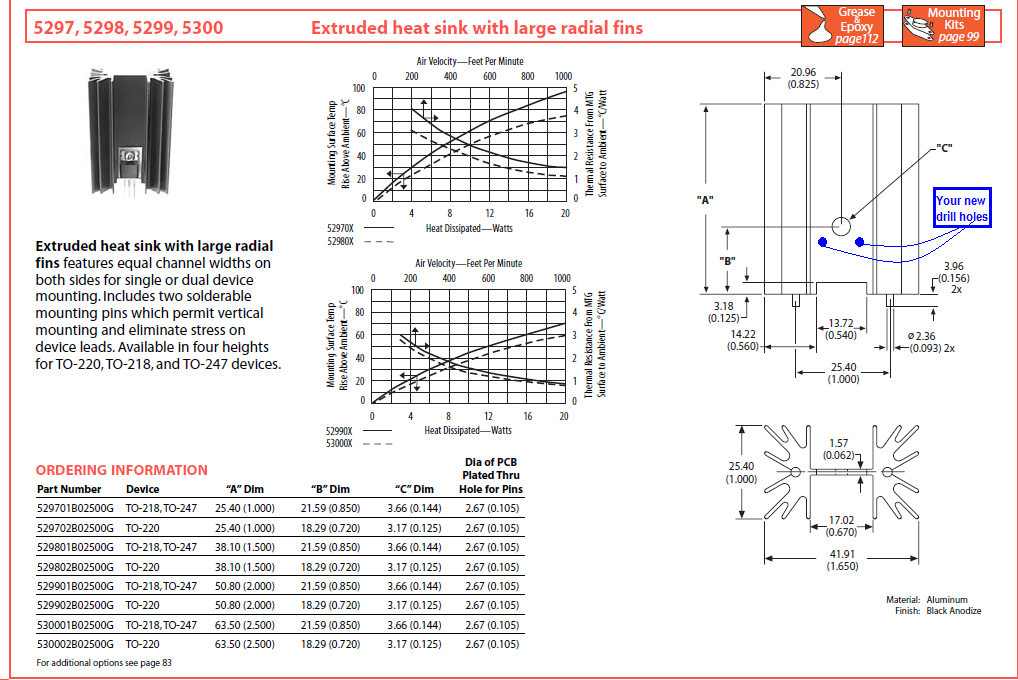

I'm using the Aavid 5752 on the TO-92's in a project I'm doing. They are better than nothing but not much better.
If you can switch to Diodes Inc / Zetex transistors in the "Super E-Line" variation of the TO-92, I think you'll be happier. And if you drill a couple of extra holes in an Aavid 5297, allowing you to use a plastic Zip-Tie to secure the transistor + grease to the heatsink, I think you'll be a whole lot happier.
