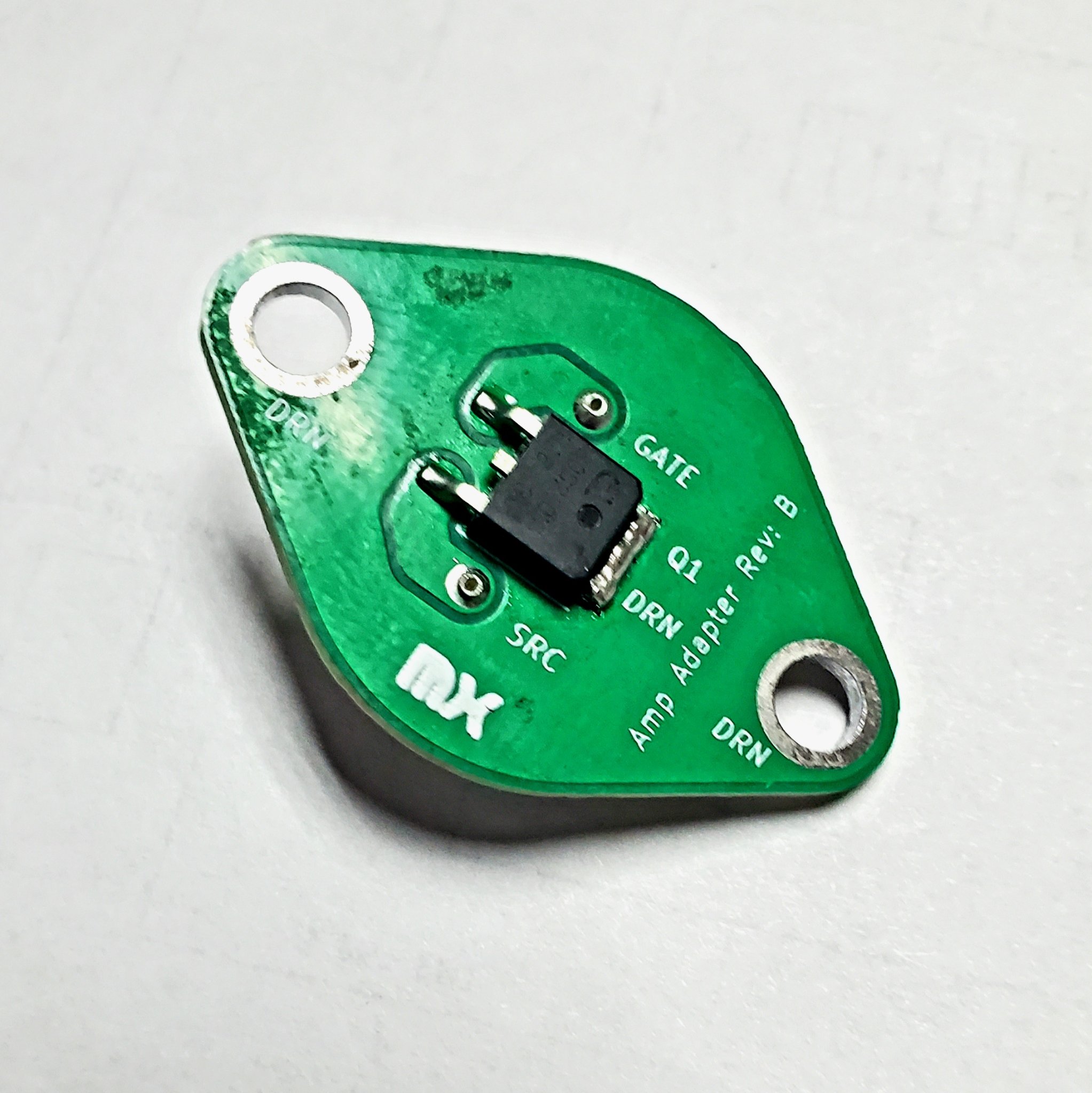

I designed a TO-3 to TO-252 adapter PCB to upgrade an amplifier I have from obsolete MOSFETs. I wanted to post it here to gauge interest from the community. I'm willing to sell these as a kit with pins or pre-soldered. Price TBD but will be reasonable.
The board has thermal vias under the TO-252 tab for heat transfer to the bottom ground plane which is exposed copper with no soldermask.
