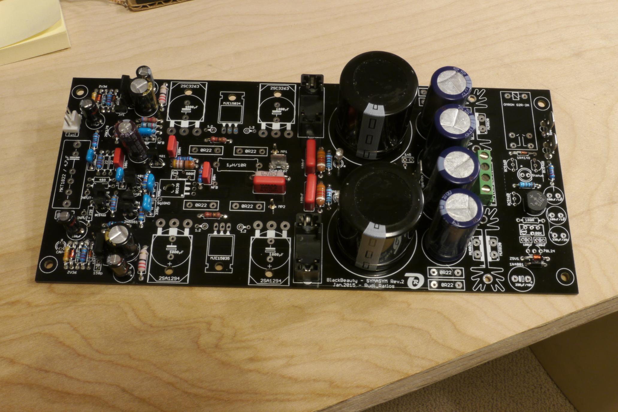

Here's a couple images of my build. Just one board at the moment. Still waiting for a few more parts to come in. The images are larger than I wanted, but I'm at my smallest size and max compression and you still have to scroll around to see the entire picture. I may switch over to uploading all my build pictures to my public PhotoBucket account where you can view images in all their hi-res Lumix glory. :)
Rick

Rudi - A couple of questions about the Black Beauty boards...
(1) This may be a dumb question, but I just want to make sure before I mount the 2 sets of MUR820G rectifiers to a single heatsink. Does the bolt need to be insulated from the devices and heatsink? I can't see anyway of doing. If not, can the two devices be connected together without issue? I assume so, but thought I'd ask first.
(2) There are 4 sets of 2 holes (One with a white circle around it.) They are located between the output transistors and the MJE devices. They're labeled as 1.2. What device is this? Ah ha. I think I see them on the schematic. Are they R22, R24, R35 and R80?
Rick
Rick, the bolts of the heatsinks aren't connected to any track and you can safely solder them to the surrounding solder-pads.
However: the MUR - diodes need to be insulated, since their metal back is connected to the cathode of the diode.
The resistors that you are mentioning, are base-stoppers and need to be mounted vertically.
Best regards - Rudi
