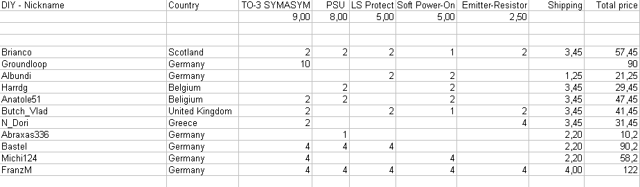

Gentlemen, I will be able to offer you lower prices due to quantity discount.
I will also order FUTABA MPC74 0R22 emitter-resistors.
Find attached the current order list.
Please transfer the total amount of money to my PAYPAL ID: RRozek@t-online.de
I would like and order the PCBs on Monday, 12th of March.
Best regards - Rudi

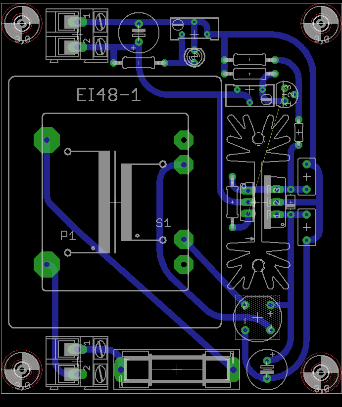

I have a very simple automatic fan control schematic that works really well. Is there any chance you can make a few PCB's for that?
The fan speed increases with the temperature, when first powered on the fan runs at full speed for 1 second(you need to add 1 capacitor 1000uf/25v in parallel with the NTC)
Temperature-controlled 12V dc Fan - RED - Page109
I think this would be a circuit that many need inside their amplifiers
Vlad

Butch,
you asked me:
"I have a very simple automatic fan control schematic that works really well. Is there any chance you can make a few PCB's for that?"
Of course I can do this.
I will do it over the weekend and show it do you.
Best regards - Rudi

Rudi
PCB looking good
Few things to consider: most fans need ~200ma to operate and PCB transformers are wery low power. Maybe is better to have a chassy mounted trafo instead of PCB ? Two decent fans require 0.5A minimum (depends on the max RPM).
Maybe consider some jumpers to solve the routing issue? Don't think anyone would mind a couple of wire jumpers on the pcb 🙂
Don't forget the 1000/25v capacitor parallel with the thermistor (I think that is on the PCB already but I am not sure 🙂 )
Regarding the zenner diode for the front end of the amplifier (35 or 39v ?) can you post a photo with the position where it should be located? Can we substitute the small transistors with some higher voltage equivalents (pin to pin compatible preferable) to avoid overvoltage issues?
Vlad
PCB looking good
Vlad
@Butch_Vlad,
I don't want to mix this thread with fan-control considerations.
Please give me your EMail-adress (send me PM) and we will go on per EMail.
Best regards - Rudi
P.S. The EI48 - PCB transformer I have in mind can provide 700mA @ 12VAC.
Best regards - Rudi
