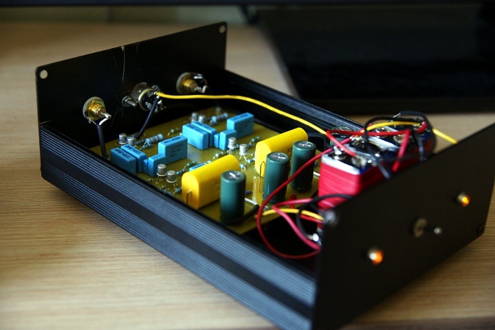

I had built one some time ago(original PCB, BC109 from CDIL) - no noise, works well. it wasn't my basic RIAA preamp, so I powered it from 9V batteries.
Sounds similar to NJFET RIAA, according to my observations.
