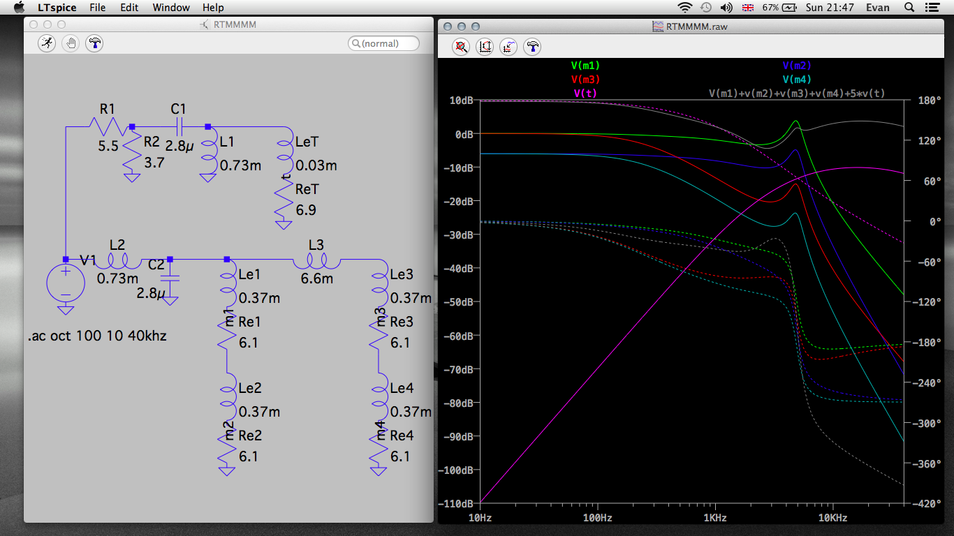

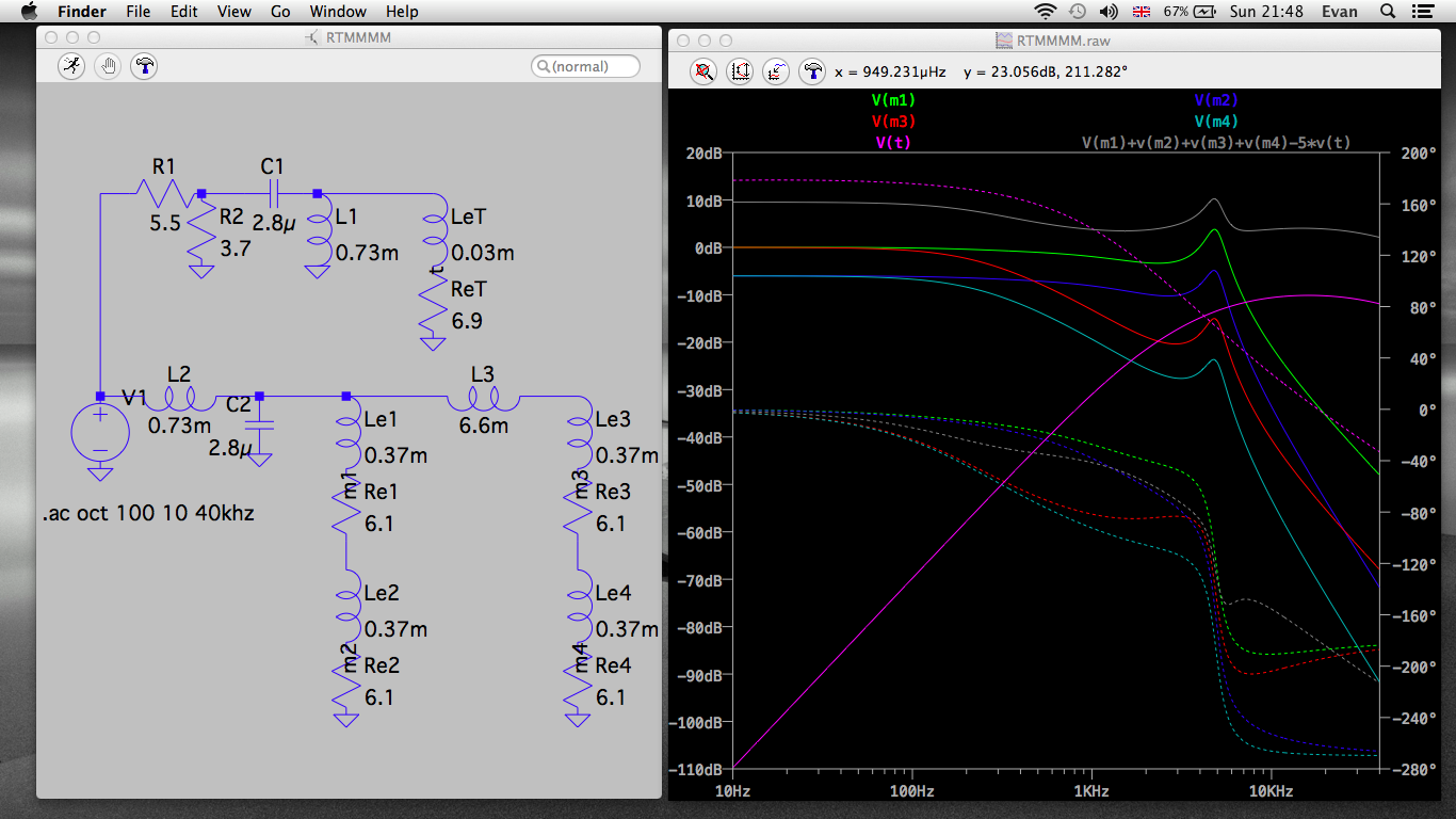

I was just messing around with ltspice with this text book xo (translation: not going to be very good in the real world but it's a start...)
The first problem is the 6.6mH coil. It needs to be that big (I think) as it sees 16 ohm Z for mid 3 & 4. That alone will probably cost more that a single mid driver so it needs addressing.
The second problem is I can't find any t/s parameters for the rbt-95... the values I used are pure guess work... not a good start.
Third problem mid 1,2 & tweeter are not in true d'apollito as the tweeter lag is not 90deg to mid 1 & 2 at xo freq... that also needs addressing.
Also the levels of mid 1 & 2 (part of the MTM segment) are not the same... oops!! I begin to think this 2.5 way is not possible with 8ohm mids....
2 attachments with normal and reverse polarity. Grey line is the overall FR.
Any feedback?

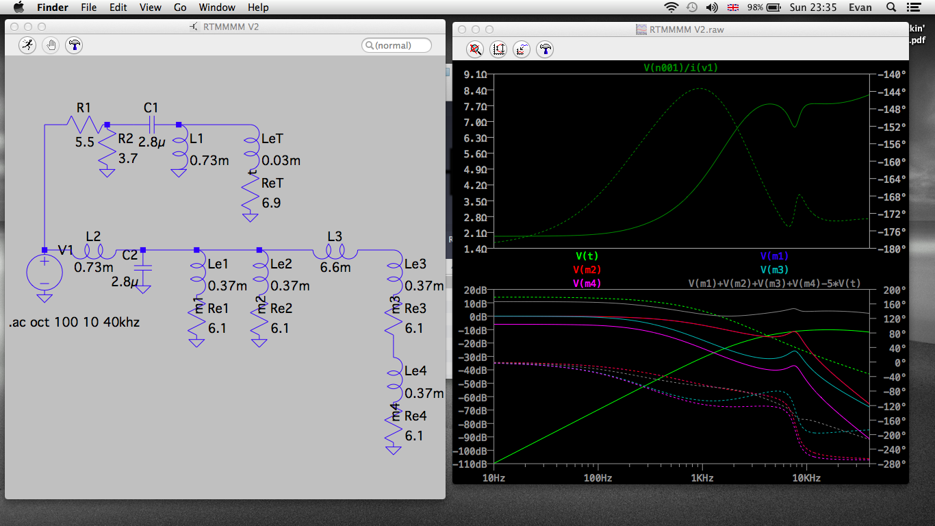

This gives same level for mid 1 & 2 for the mtm part but .... overall Z goes down to 2 ohms...
so it's a no-no.
So really the MTM part needs 16 ohm mids (where driver choice is now limited or more of a stab in the dark) or we just go back to the TMM arrangement (which will exhibit lobing error).
Going back to the first topology posted - are the different dB levels of the series mids that much of a compromise in an MTM arrangement?

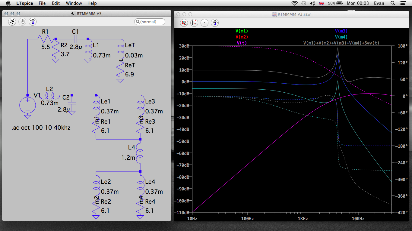

or maybe something like these using mid 1 & 3 for mtm? Looks like it might need a lot of work...
Yes, active 2.5way. The dot 5 pair crosses in at baffle step.
Indeed this is not going to work unless going active. Still this does not address the lower level of the lower mid in each pair if they are wired series-parallel.
The only way I can see this is if mids are paralleled then each pair connected on separate ways, then the tweeter on the 3rd way, so effectively wired as 3 way / tri-amped but filters adjusted towards 2.5 way operation.

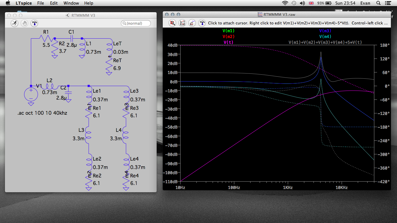

Regarding this post:
http://www.diyaudio.com/forums/mult...less-830656-monacor-rbt-95-a.html#post3775402
I am perplexed by this. I was also looking at zaph's MMTMM & MTMMM design:
Zaph|Audio - ZA5 Speaker Designs with ZA14W08 woofer and Vifa DQ25SC16-04 tweeter
and from his xo design he does not seem to be bothered by this (the lower db is not shown in his individual driver response graph...)
m2 is basically 6db lower than m1, how does that functionally affect the MTM configuration? Is this issue not significant enough????
The same goes for the 0.5 pair, m4 is -6db than the m3...
Has anyone noticed this before in other series-parallel designs?

I might well be talking rubbish but see attached crossover simulation for your perusal.
Green line for mid 1 seems to be consistently +6db above mid 2 blue line. m1 & m2 are part of the MTM part of a possible MTMMM 2.5 way config. Surely it's not going to work??
You need far better simulation tools. I suspect your problem
is your looking at absolute voltages, and of course the
voltage across 2 drivers is 6dB higher than across 1.
The voltage across each driver is still the same.
That tweeter won't work well in this sort of build,
you can learn a lot from Zaphs articles, the bassmid
needs the same sort of peak suppression Zaph uses.
Pick another tweeter IMO.

You are quite right about taking the voltage across 2 drivers!!! It's so obvious now...!!
