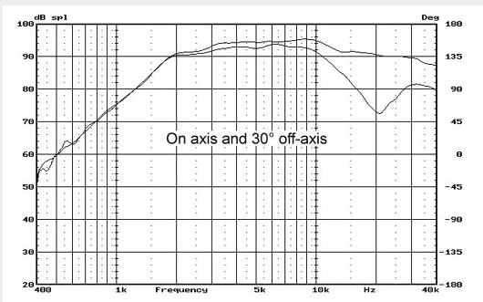

That Planar tweeter likes to be xoverd at 2.7-3kHz. If you ask me, this is very high for an 8" 2-way in most cases. Another thing about it- it's HUGE in diameter. This can wreak havoc on center to center distance. That said, I've seen and heard it done with an Audax Aerogel 8" woofer, and that worked out okay. I'm just not sure if the RS225P will meet it alright. The RST28 will likely reach it, but 8" 2-ways are never easy.
I recommend you attempt it one of these ways:
1- use a waveguide on the tweeter
2- start the tweeter rolloff shallow and early to combat the directivity mismatch at the xover point to the 8" driver.
3- Use a larger widerange or tweeter so that it is easier to do.

Thanks. If the planar tweeter needs to start at 2.7-3kHz then I won't use it. I was considering it based on the specifications listed at Dayton Audio, which state a frequency response starting at 1.7kHz. That being said, the stated specs for the RS225P-8A are 30-7,000Hz, which sure seems questionable.

I just checked the Swan's website, and they suggest a crossover point >3kHz, so Parts Express spec seems wrong. Can you suggest a planar tweeter which reaches down to 2kHz? I'm leaning towards a ribbon/planar because I understand that they have narrow vertical dispersion, which is what I think I need in order to minimize reflections from the ceiling and floor. I also attached the RT2C response curve. It does appear about 5dB down at 2kHz.

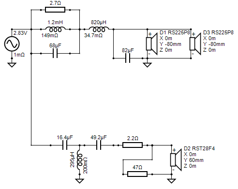

Actually, even-order electrical networks protect tweeters more than odd order. This is due to the coil being across the tweeter.
yes understood.
It was more the large response peaks of the 8" speaker is likely hard to tame if crossed high.
Taking a quick glance at the FRD
Played around with the RST28F crossed @ around 1600 kHz
seems to work alright with the 8"
Tossed in basic baffle step compensation.
My Simulated response wont be flat below 400Hz because it includes the 6dB compensation in the low end.
