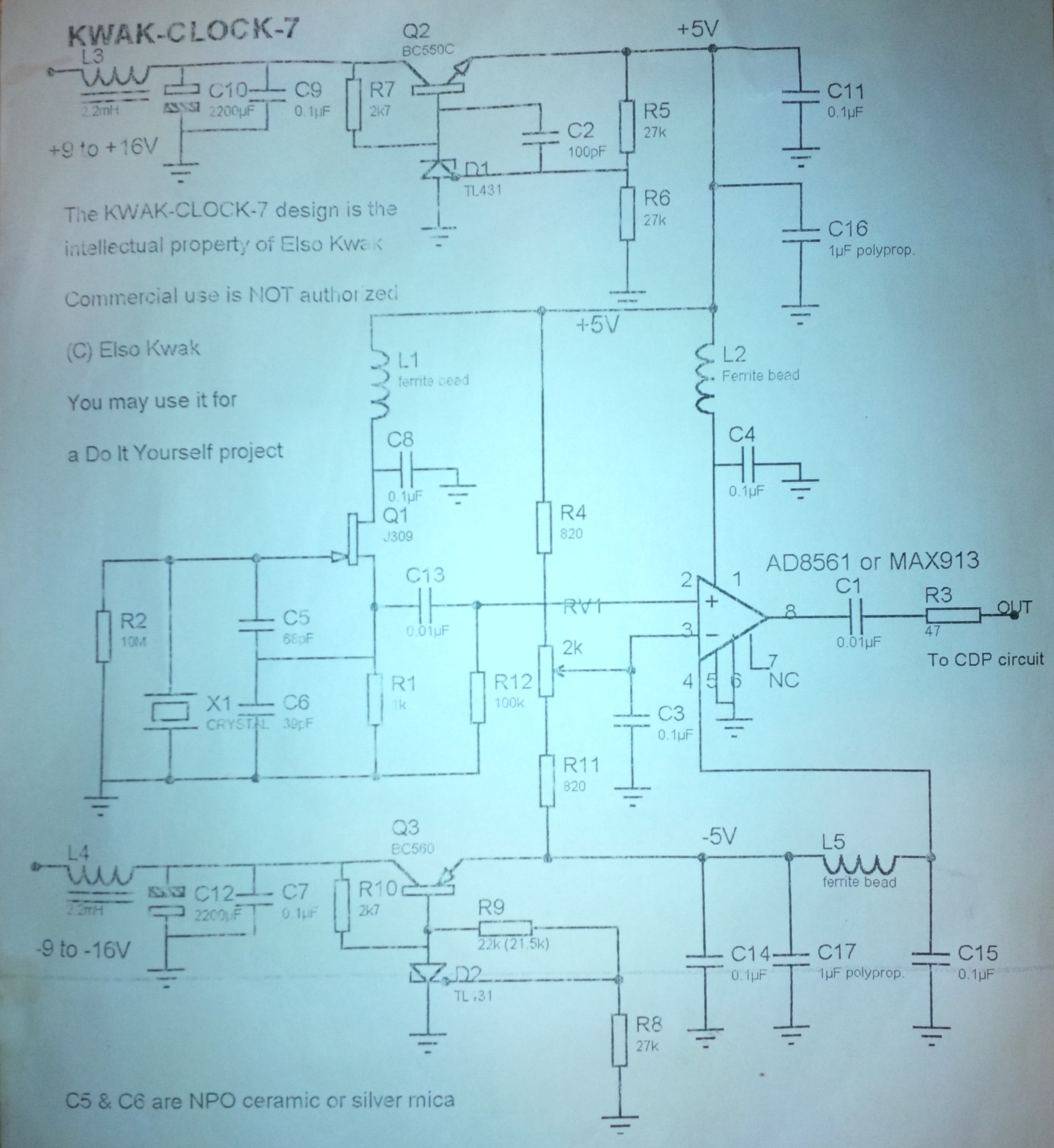

I don't see much problem as it shouldn't make much difference wether you regulate the 'voltage' or the 'ground'. Both are electrically just potentials.
However, I have that series connection also seen in a Linear Technology datasheet, so it's not exotic.

lineup, thanks for your schematic, i am reading and try to understanding now.
H.A, thanks for reply, i still not understand the two postive dc added together to form a dual supply, i will think on it. 🙂
PMA,i think it's different, in u schematic tl431 act as a Zener(better temperature performance than normal zener)
It works the same way as you would put 2 Zeners in series - it's just a series connection of 2 regulators with your reference "ground" in between.
Have fun, Hannes
I notice in the Kwak clock 7 schematic there's a 100 pf cap between cathode and reference pins of the TL431 in the positive series regulator, but no corresponding cap in the negative one. Is this an omission or is it supposed to be that way?
If you gave us a clue as to what a "Kwak clock 7" was and posted a schematic, link to schematic or just a circuit diagram, someone might be able to reply. 🙂
Its clear the negative regulator has been formulated differently - there's no feedback. Presumably the 100pF cap on the positive one is to maintain stability as it has feedback. Notice R8 and R9 have to be set to give roughly -5.6V on the PNP's base to get -5V output.
