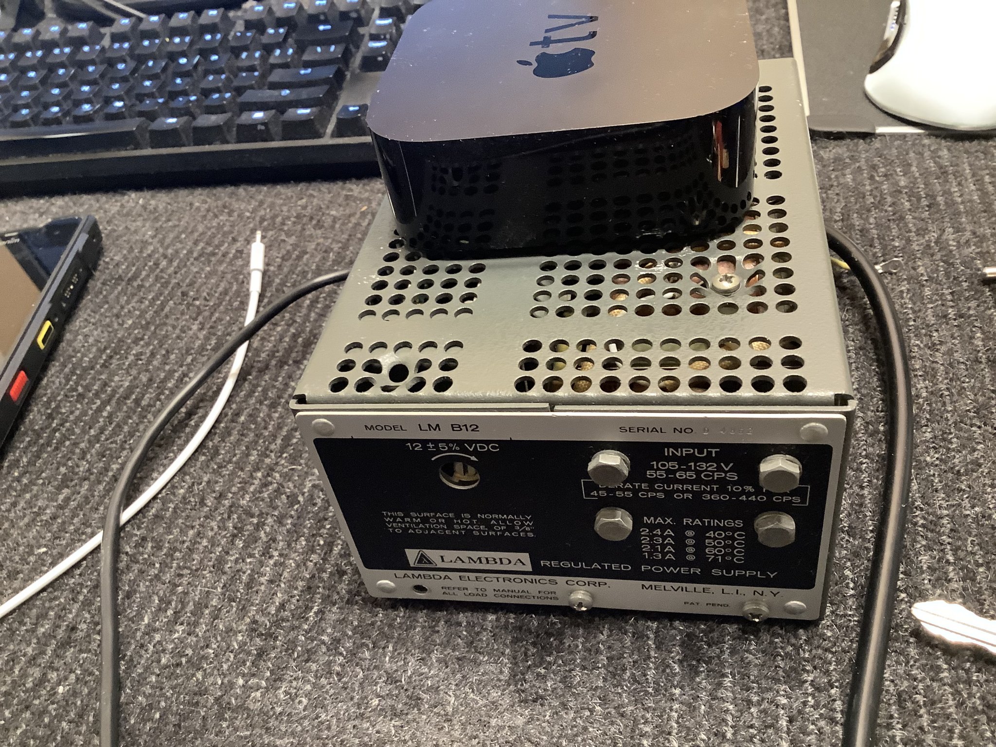

BUT anyone reading this, be aware, the Lambdas are wonderful, BUT, you gotta recap them. Caps are all toast.

I can get stunning performance from a LAmbda A or B series supply...

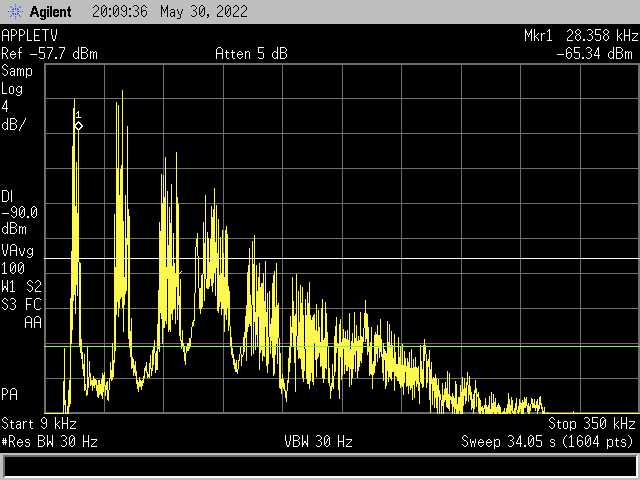

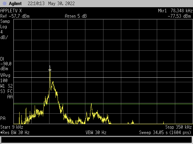

These plots are while hooked up to a device. Top lot is std supply.. Bottom plot is with remote sensing and a restored and modded Lambda LS A12
Before
After

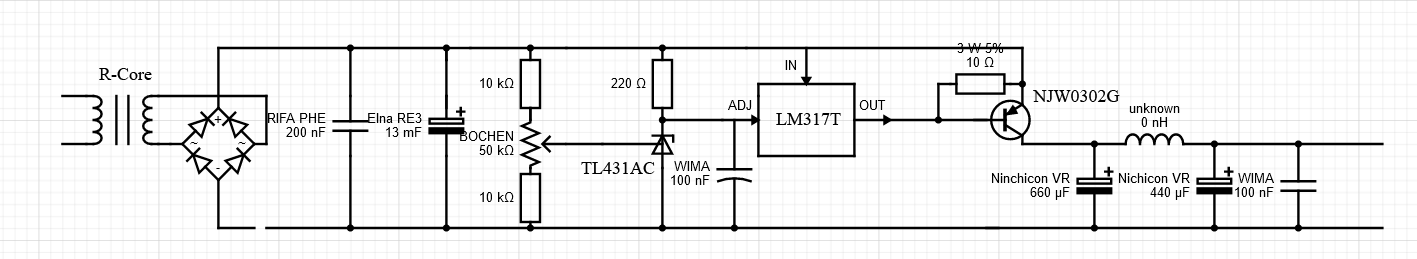

but, its abnormally noisy and a bit unstable. [] Its weirdly unstable. Certain loads cause a oscillation. No load has it too. It has a 4mV pk-pk very random looking noise. Its VERY picky on which mfgr of TL431 and even grade.
So, why is it fantastic then? Just scratching my head ;-)

The device has 4 buck boost regulators in it feeding various chips. I cannot bypass those and can't do any mods because of space requirements. So my omly way to improve the quality of the supply to the chips is to try and manipulate the PWM regulators and make them happier. These things are HORRID and NASTY and SPEW harmonic crap all over the place which soaks into everything around them. Its REAL tricky to hook caps to the line side of them and quash out noise so they spew less crap all over the stuff around them. I spent 3 months, daily, working that out. Eventually it was time to then focus on a linear. So I spent a month, daily full time, playing with typologies and I think about every known regulation scheme. I eventually landed on using discrete parts rather then any chips. I even eventually discovered that they don't make these discrete parts like they used to and ended up buying Lambdas and reworking them. I needed sensing so I can bring the regulation point right onto the board of the device I was powering. No way to reach uV of noise, -100db and +- 0.00001Vdc drift without remote sensing.
I really cant sell Lambdas tho. But I had a reference supply to work against so I could AB different supplies and judge the performance of the linears using the device.
Then a LONG list of linears and stupid amounts of AB ensued. Everything pretty much sucked in performance, just some less then others. But then I hooked up the supply I mentioned here and this immd exceeded the Lambda. By a bunch.. WTF...
Measuring it was horrifying. EVERY spec i measured was terrible. YET the device it was powering was just clearly better.
I ripped into it and ran into this freaky circuit. I dont know of any other device, ever, that has used this. I cant find anything online close to it. I cant even make much sense of it.
So I have come here to see if anyone here is a TL431AC ( fairchild / On ) expert and might be able to explain it..
The weird divider for example. 10k > 50k pot > 10k ... Thats a LOT higher then any values i have seen for this part. WTF is that cap for ? Why a LM317 ? The TL431 could drive a transistor for this current. That is a interesting transistor to choose, why use one like that ?
I did tonight do a mod that made for better performance from the device it hooks to. i used a really good 0.68uF poly cap VS the 0.1uf.. BUt I am not really sure what changed, so, just a stab in the dark..
I want to go reverify that this cap really connects to the pot. It seems so hard to believe I want to triple check.

Yea maybe. I donno, I think someone with a SPICE tool crafted something odd. You know a bit of wideband random noise injected into the power supply of a lot of different things might produce results that might be favorable, if inaccurate 🙂 The human perceptual model is incomplete and highly complex 🙂
Into analog gear a very slight background hiss might be kinda tubey. On things with PWM regulators that same hiss dithers the spectra of the radiated spikes being sprayed into other parts. What that could do is anyones guess.
Its curious. Maybe I will go find a EE forum and ask some SPICE modeling guys to plug this in and see what comes out. i need to triple verify that cap on the TL431. I verified one side goes to gnd, but I will ohm out the other side.
I am pretty sure I don't know what I am doing with the TL431, well I did sorta until this circuit came along.. So that high resistance on the ADJ pin 10k > 50k > 10k means the TL431 has gain ? And is operating much closer to open loop. So would this make it more sensitive to cancellation signals coming in ? or less sensitive ? So a cap on the cath or on the adj to ground would low pass filter and limit bandwidth right ? Which if this has gain might be a good thing. The LM317 has much less bandwidth so limiting the bandwidth of the TL431 would make sense.
So really the TL431 is like a little op-amp with gain in this case with one input tied to the internal reference.
The TL431 does not have enough drive to handle that output transistor I don't think. That output transistor would offer a nice low output impeadance. But why use a LM317 to drive it. Unless maybe the LM317 offers not only the means to drive the transistor but a second stage of regulation all in one package.
Hmmm... This circuit is making some sense maybe. Well, I am just smart enough to be really stupid tho..
There was a really smart guy on the Facebook vintage Tektronix forum I ran into while modding the 7904 who literally wrote some books on power supply design.. I am going to go send him this schematic and ask if he has any idea what is going on here.
