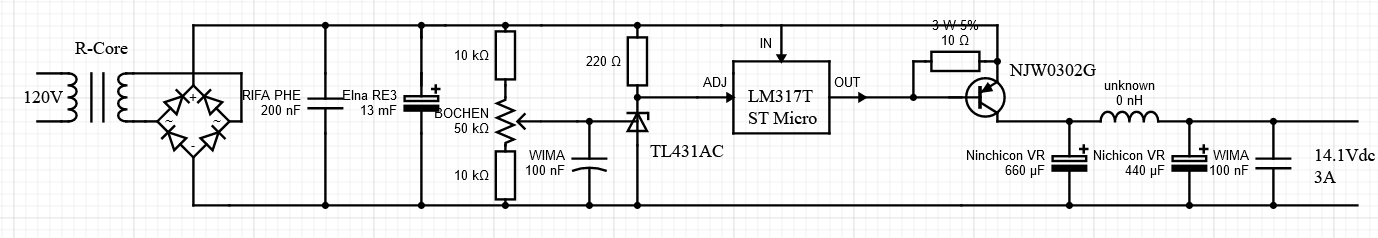

There is a linear selling on ebay which is working fantastic for a application I have, but, its abnormally noisy and a bit unstable. I made a schematic for it and I am confuzed.
Does this look sane ? Its weirdly unstable. Certain loads cause a oscillation. No load has it too. It has a 4mV pk-pk very random looking noise.
Its VERY picky on which mfgr of TL431 and even grade.
I can't find any reference to this layout on-line.

Why would you feed the TL431 from the input via the 220R? Why not from the OUT pin? That 100nF to GND from its adjust pin is almost certainly going to make it oscillate wildly or maybe just amplify its self-noise crazily.
The 100n cap is not from the adj pin but from the Vref pin of the 431 to ground.
The regulator is unstable because 431 is no compensated, that 100n cap does nothing good where it is put.
But, as i have said, why would you use a 431 to adjust the adj pin of a 317?
It's stupid...
LM317 is it's self an adjustable and stable regulator, it does not need another EA...
It's stupid...
That's what I meant - the pin which is used to adjust the output voltage of the TL431. I didn't use the datasheet word.The 100n cap is not from the adj pin but from the Vref pin of the 431 to ground.
There would be some value in feeding the LM317's adjust pin externally if the voltage reference used were to be lower noise than the bandgap inside the LM317. So for example using a zener diode there can give lower noise than the usual resistors. But a TL431 is probably just as noisy as the internal bandgap, so no additional value there.
This made almost no sense to me either... I agree with all these comments.. It is no surprize its unstable... I agree about the .1uF cap to ground.
YEA I agree its crazy.. In a number of ways.. Its why I am posting.. Good to know I am not crazy..

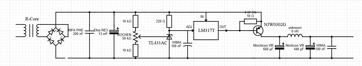

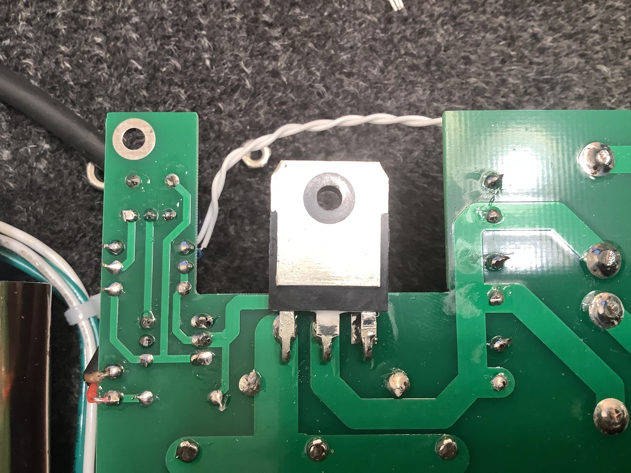

Here let me post some board pics to confirm the schematic.
I will also post a vid of the noise..
Looks like something a 14 year old with too much internet time on his hands has dreamed up.
I call it garbage.

I will reverify the caps and schematic.. I admit its, uhhh, annoying to reverse engineer a board.. haha...
This seems to be landing either in the TL431 instability zones OR its just wonky and unstable and oscillation.
The weird part is, for what i am doing its terrific.. I have been playing with a LOT of linears, including fully restored and updated Lambdas,, but this one has really stood out..
The transistor they used is interesting too. Interesting part selection..
I was thinking that maybe using the weird properties of a TL431 was maybe being used in some odd way here in a way I did not follow..
It does like its running high gain and unstable under some loads..

I know huh ? Except.. The part selection like a R-Core and that output transistor seem pretty good.. The TL431 is weird enough with odd modes of use, I thought I would post..
This seller seems pretty popular on ebay..
https://www.ebay.com/str/pinshuche?_trksid=p2047675.m3561.l2563
I am very happy with the linear. I have done a LOT of AB with a LOT of linears. I wanted to add remote sensing and that was when i noticed the odd topology. WELL, I had previously tested it and seen the odd high noise level..
Varying that .1uf WIMA above or below the 0.1uf value lowers the noise. It seems tuned. 0.1uF seems to peak out the noise. Like high gain at a specific freq..
Moving to a different type/brand of TL431 causes it to jump into 100mV of ringing with all the same parts. Yes I know different TL431 can be very different internally and have different specs.
For what i am using it with its perfectly stable and the noise is meaningless. Its just very odd..

Yea I ohmed it out and took that cap off the board to confirm it.. It is as depicted in the schematic..
I did find a error tho. Which really makes it more bizzare.. The pot is 50K.. So that makes the total 70k across that.. Very high impedance for that TL431 adj pin.. This causes my brain to hurt.. So that makes it high gain ? Or, WTF.. I will have to plug this into the data sheet math..
How weird...
The parts are all good quality, for its price range, and clearly mindfully picked. This looks very much like it was well crafted and maybe well engineered.. Or not..

I FULLY Agree.. I have a HDPlex, a Clones audio, a Uptone LS-2, a pile of other linears and even got into restoring Lambdas.. But this cheap thing from China is very interesting..There is linearity between price and what you get for your money.
I think until someone can at least explain this circuit I am not going to rush to judgement yet.
The TL431 is a strange part.
Under all normal loads for this linear, its stable starting at 50mA of load. The noise appears suddenly and stays the same at any load. ALSO 3mV pk-pk is not the end of the world..
It could be this thing has a very good transit response and to get there has a tradeoff of having a kinda high level of noise.
3mv of noise is not show stopping. Its just really odd. ALso the noise is evenly distributed. It looks like zener noise which is can be used to make a reasonable pink noise gen..
Its a very odd circuit and its why I am posting.. I do not understand it.. Maybe its junk, but, maybe not.
I have updated the schematic.. I will replace the initial one I posted as well. In my use I remove and jump out the inductor on the output.
