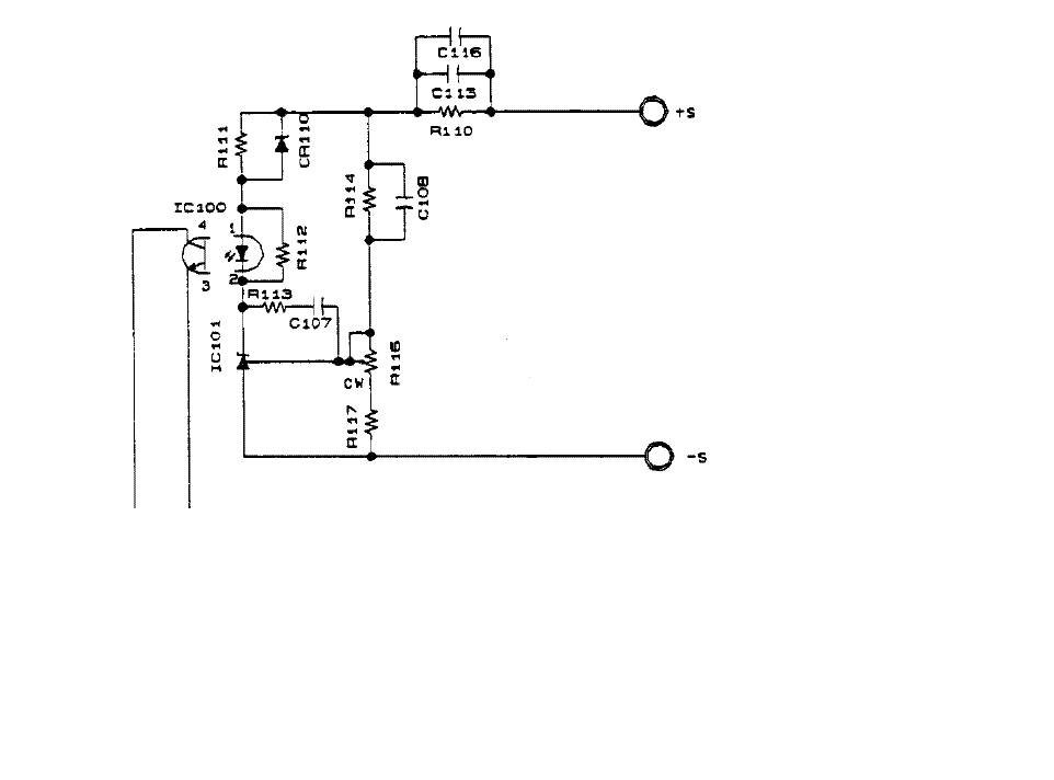

Danko,
The circuit I showed also has compensation for the PWM and not just the TL431. Post if you would like some help with the equations.
Aaaaaand, what about the PWM-controller IC? How do I choose the pull-down resistor? I just pick a current (for example, 1mA), and depending on the optocoupler's collector-voltage, I just use Ohm's Law, R=U/I ? Where U is for example 12V, the pwm-controller IC's powersupply.
The key to understanding the TL431 circuit is to assume the voltage at the junction of R110 & R111 is constant. The circuit is a voltage to current converter.
The transistor in the opto can be used for pull-up or down... What PWM chip are you using?
Look at http://powerelectronics.com/mag/50107.pdf also - the EDN article quoted above has no separate bias resistor, which this article recommends.
